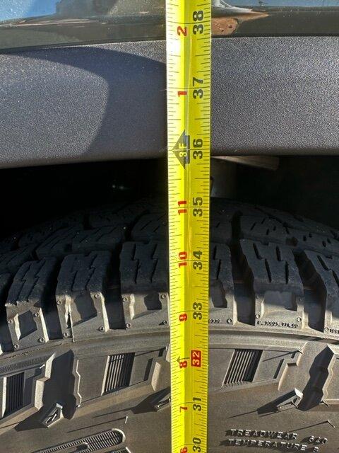

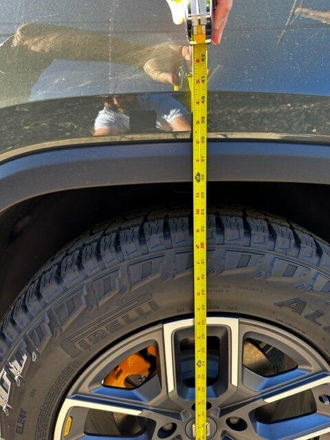

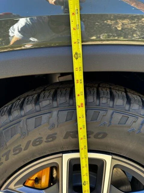

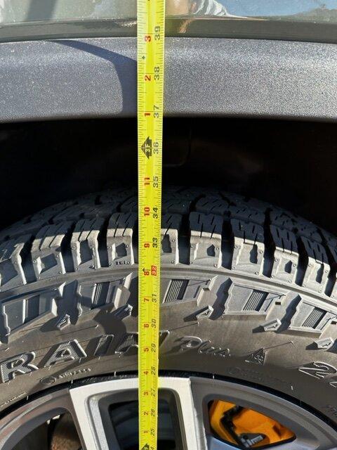

I'm in the same boat as everyone else on this thread. My R1T is leaning to the passenger side front.
While in Stand ride height I have the following measurements
Driver front / Passenger front
36" / 35"
Diver rear / Passenger rear
37" / 36"
I've taken the vehicle in twice for this issue. The technician is telling me they measure and calibrate everything from the sub frame. He said they recalibrated the vehicle based on the subframe not the wheel well. He informed me that it is within spec. and they even recalibrated it to see if that would make a difference. The photos below are taken after the recalibration.
I said ok I believe you calibrated it correctly, but something is wrong. Is the body mounted correctly on the frame? Why would the vehicle be height in the left rear and low in the right front.
He agreed that the vehicle is leaning but said it's not suspension related.
I don't know where to go from here. I called the customer service number again. They are elevating this to a lead engineer to evaluate. The height variation happens in all drive moods. I'm a little nervous to put the vehicle in the lowest drive setting with the fender being an 1" lower.
Time to ask "exactly where are you measuring from? show me..." . If measurements from that point are actually equidistant to the ground on both sides.. then you have a chassis mounting issue.
I don't know about you, but I have zero tolerance for ineptitude and laziness.. if the "tech" is telling you it's level from the sub-frame but also admits it's not level at the fenders... investigate, identify the issue and fix it. Time for them to put up or shut up.. they can't have it both ways.
When I called customer service this morning. I expressed my concern regarding the technician's comment. He agrees there is something wrong. But why are they doing nothing and giving me my truck back. TO CREATE ANOTHER SUPPORT TICKET and start the process over again. It makes no sense to me.
If.... if... the suspension is truly calibrated correctly based on the subframe then I totally agree with you it's definitely a chassis mounting issue.
