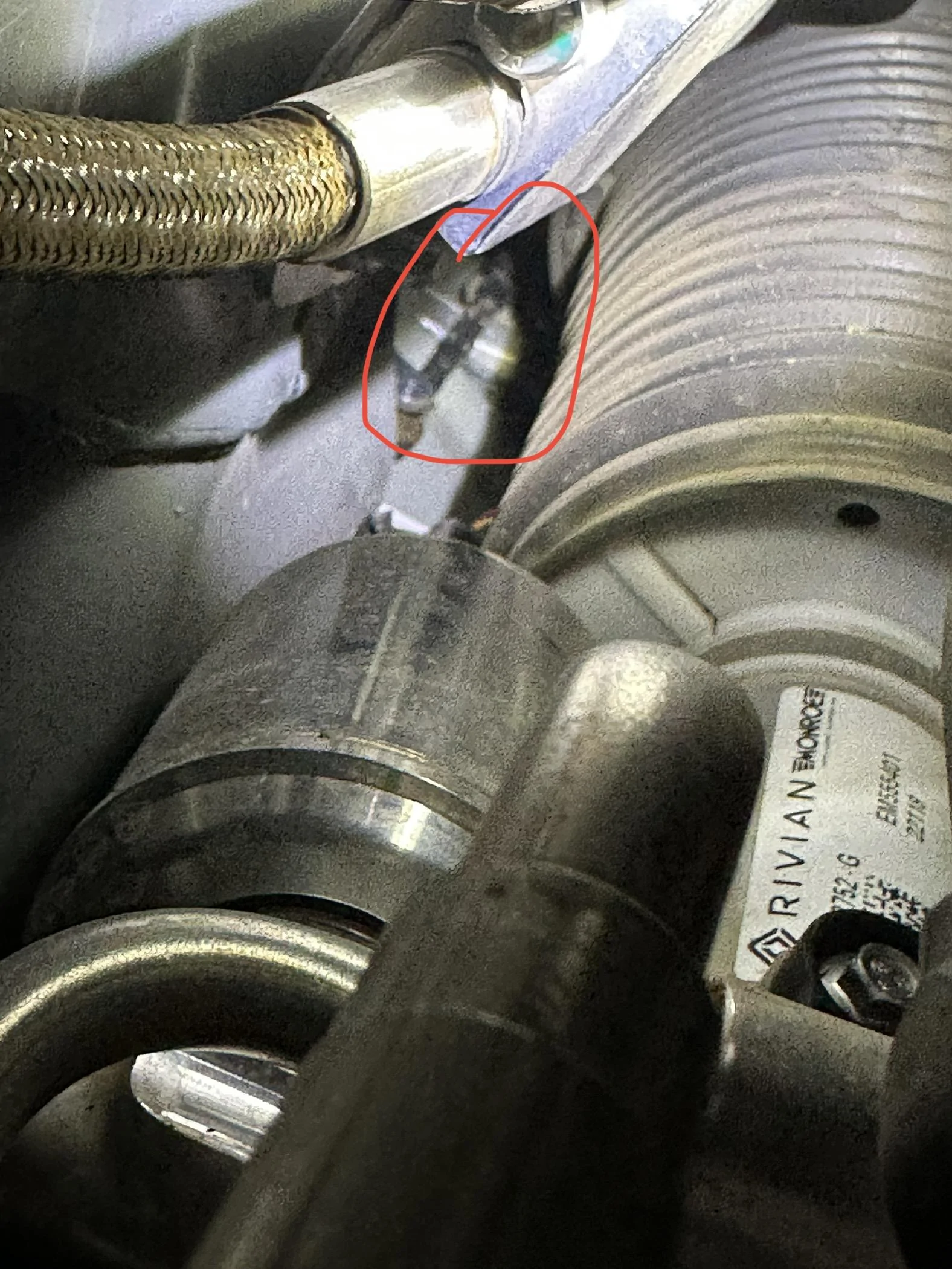

Rivian R1T R1S Passenger side lower than driver side. 2C7BC5AA-6330-46AD-A358-B62C8936FBF2
This looks like the ride height linkage to me. The link looks adjustable. I might see if I can access it.
BCan
Jul 9, 2022
103
102
Salt Lake City
I can’t tell if that’s the linkage…or what I believed to be the linkage. Mine wasn’t adjustable. I remember it attaching to the control arm and the sensor. The sensor had two tabs that fit onto the frame.
