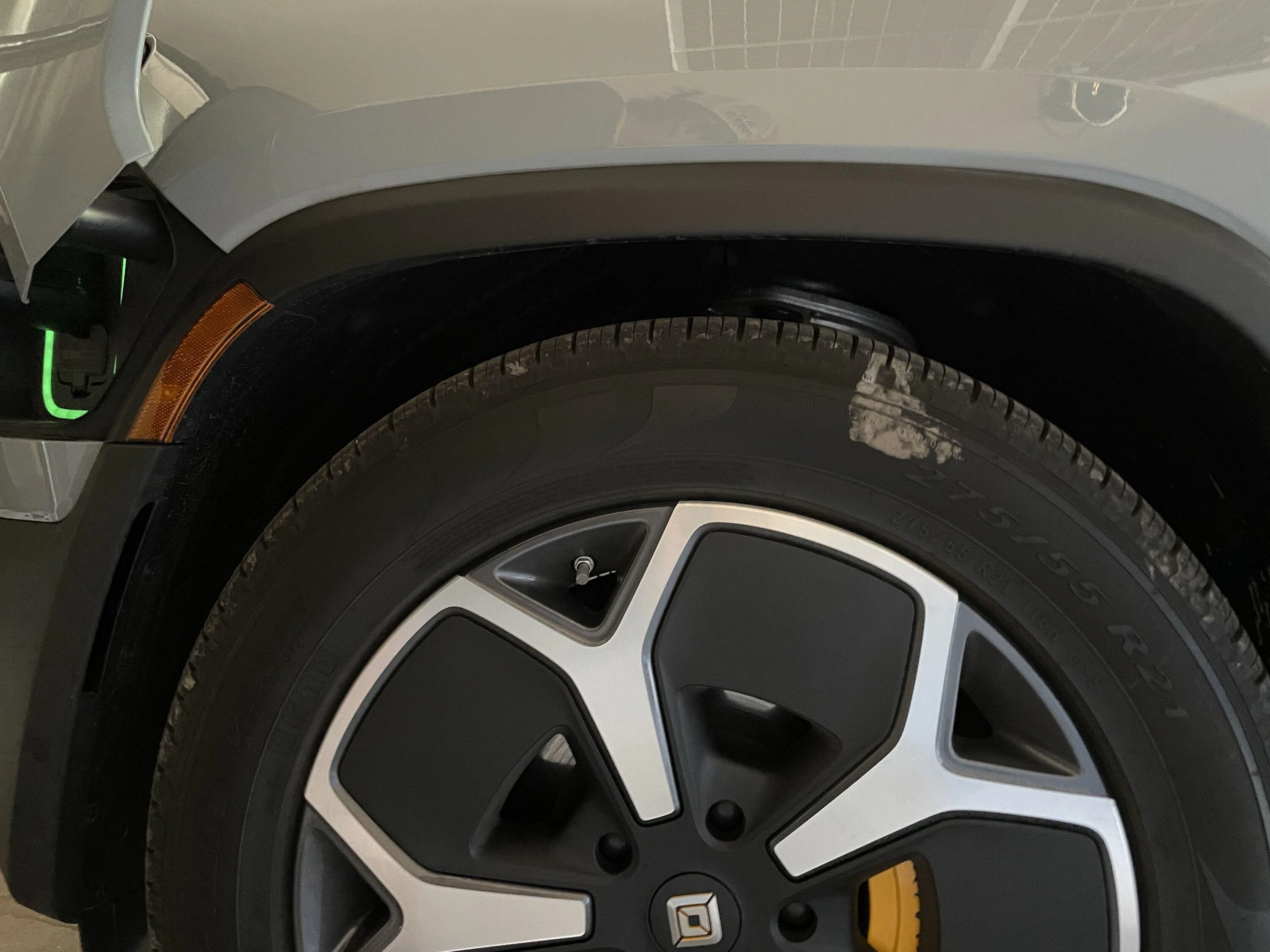

Picked up truck today. Right front passenger same - low. That tire was actually in the wheel well. When I pointed this out to the service rep…she was surprised…went and got a tech…he was surprised/confused. They said it was level in the service center all night after running all the suspension diagnostics, etc. We raised the truck…uneven. The only change between the service center to the parking lot would be the temp. They are ordering a new air strut and sensor. I’m OK with the response…as at least they acknowledge it isn’t correct and they are willing to replace all the components as necessary. FWIW, the tech said it was within the “3mm tolerance” post calibration…so 3mm might be a thing.
To be continued….

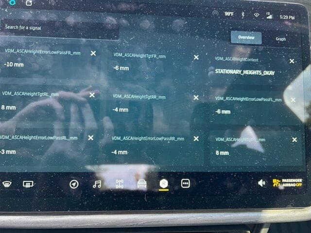

Here's what I see when I add the ride height options to the dashboard. The numbers are all over the place. Can anyone make sense of this? This was taken after being parked on flat ground for about 30 minutes. I also snapped some pictures on the ride home at various red lights, but I'll spare you all of those.
(And yes, my screen is dusty)

Noticed this myself recently, but seems to work itself out with a height change or two and driving. Interesting that it always seems to be front passenger wheel that exhibits it, which makes it seem software based rather than a loose sensor or other hardware issue (which would presumably be more random around all four wheels across different people).
I agree. Seems like this one is a simple software fix. But it might require individual vehicle execution with variation. Something seems to vary from vehicle to vehicle and the result is some have lower passenger front corners. You would think some would be higher, but nobody has said that yet to my knowledge.

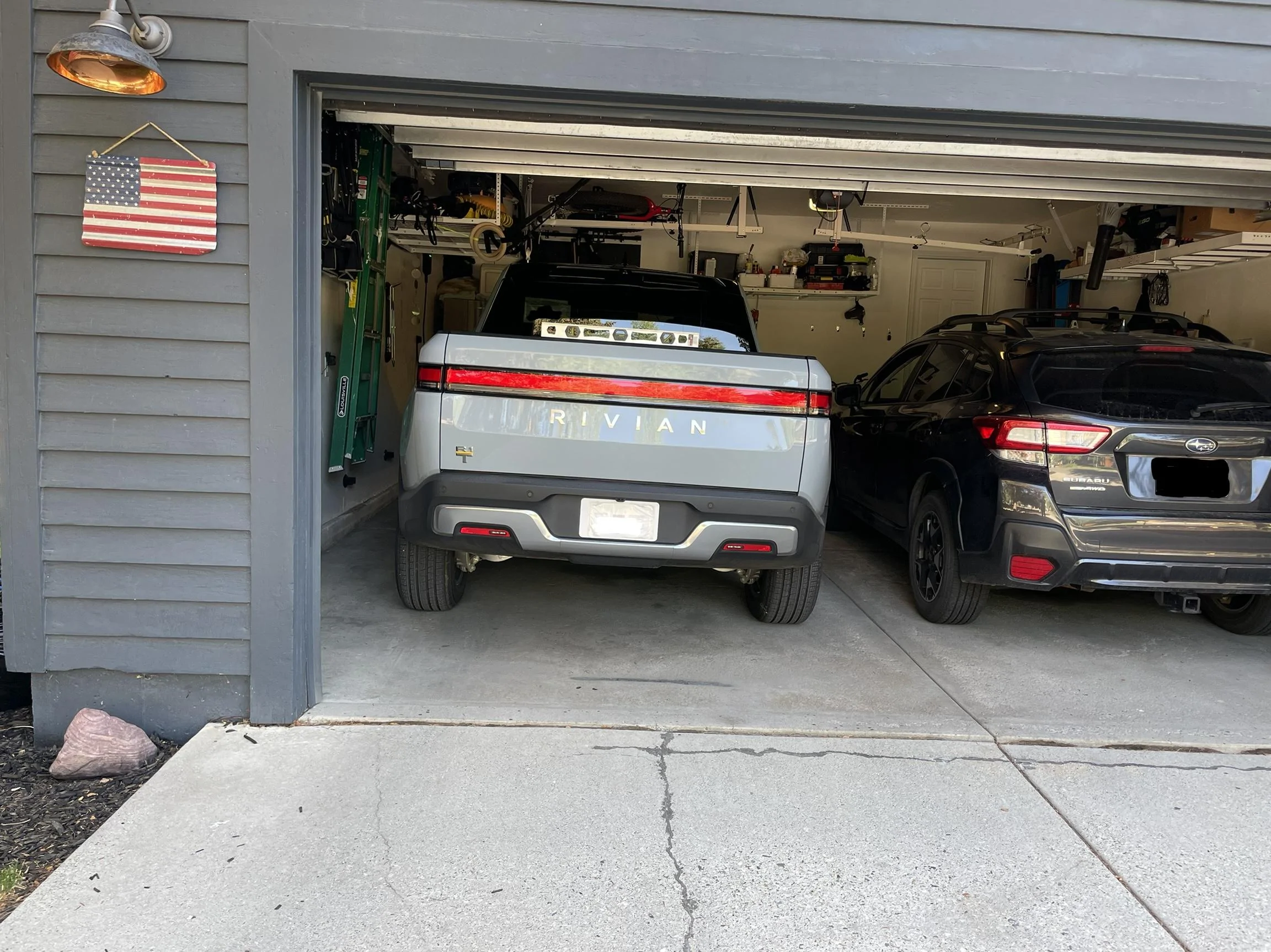

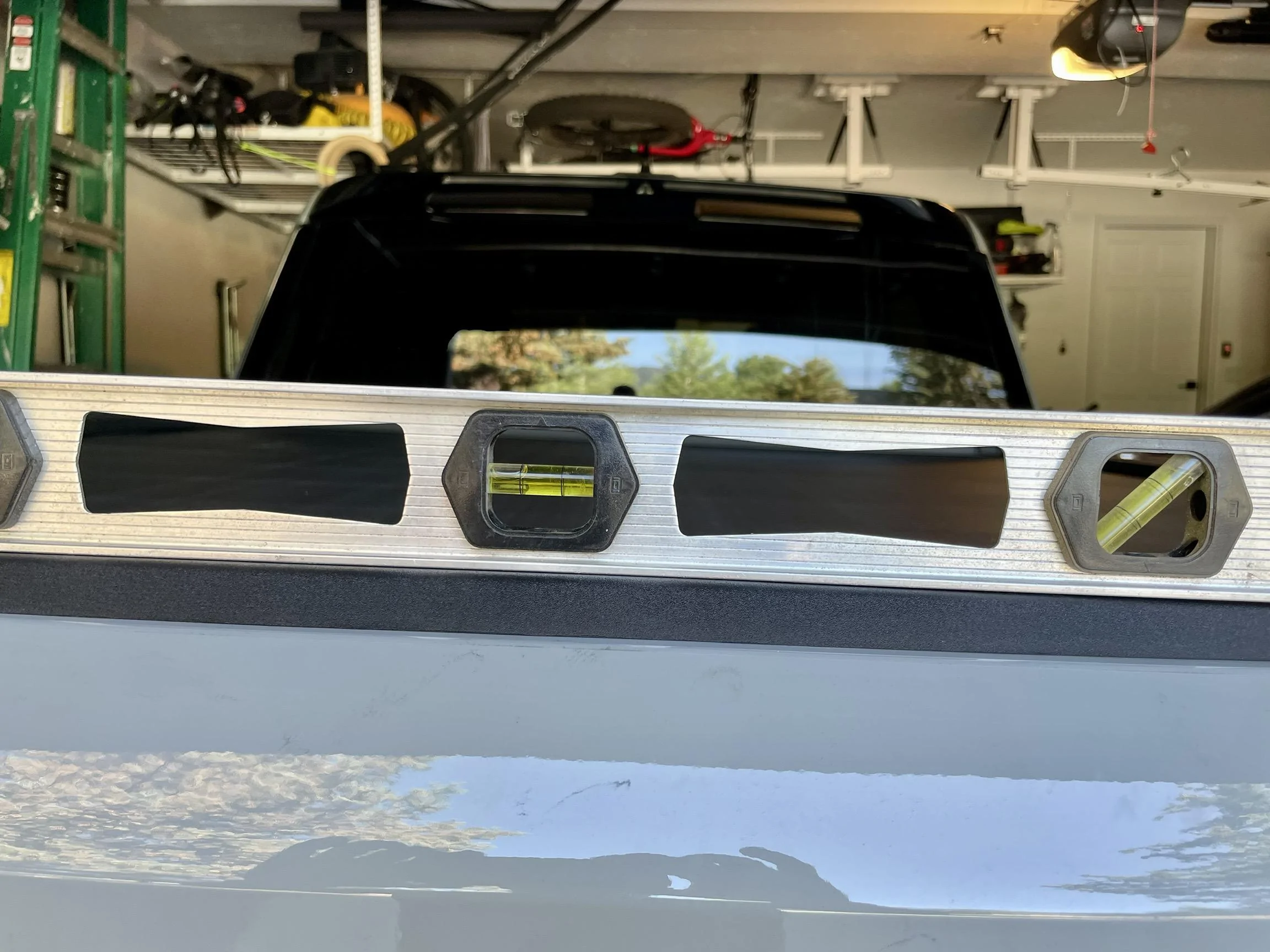

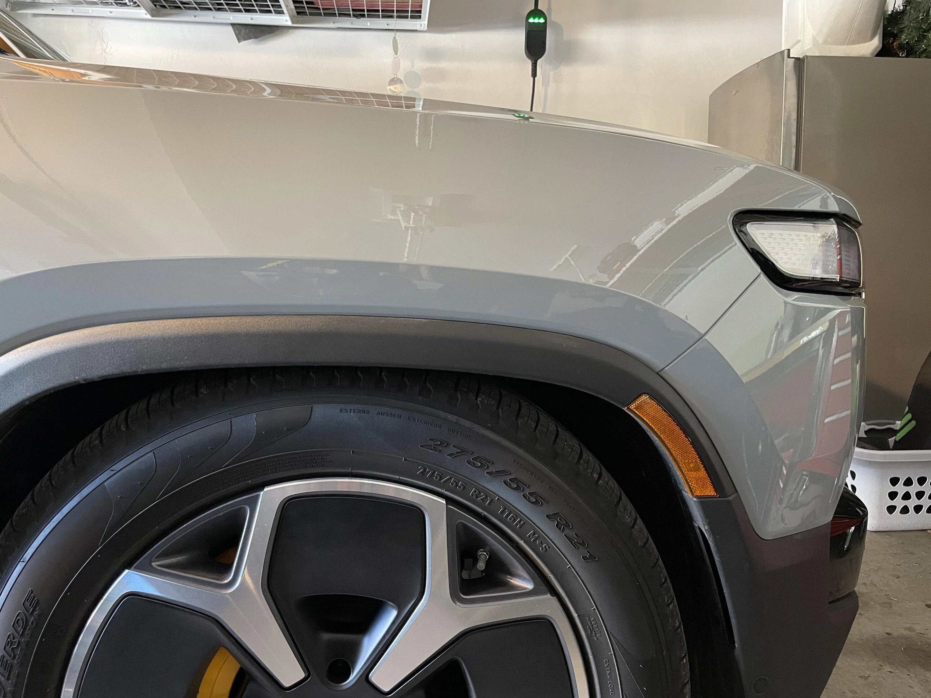

What’s weird with mine…the right front pax is always very low after the truck sits for an extended period. The compressor doesn’t run a lot - so I don’t think it’s a leak. It gets better once the truck raises…but right front is always 1/2 to 3/4 inch lower.
the truck after sitting 2+ hours.

Mine is very similar, but yours seems to be even more pronounced. Is the back passenger side always lower than the back driver's side? The rear of truck is usually closer to level for me, and can fluctuate, but the front passenger is always about 3/4 lower, sometimes more.
One final question: is there any slope to your garage floor (hard to tell from the pic)?
