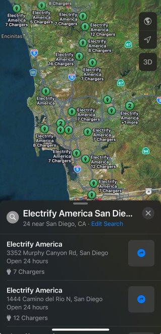

If you have an iPhone you can use Apple Maps. In my experience they seem to have a more comprehensive database of EVSE and DCFC than PlugShare and Google. Plus you can search network too ā€œElectrify America San Diegoā€.
Rivian R1T R1S Planning first road trip E02%21113268&authkey=%21ANjPHAPvU_HmRjg&height=660

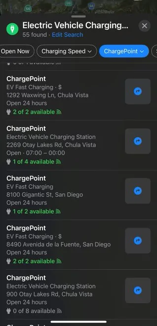

Or if you search EV Chargers, you can then filter by network. Here it was easier to find some of their DCFC but I don’t now where those are in relation to city center.
Rivian R1T R1S Planning first road trip E02%21113270&authkey=%21AGw3kvszDn6Kyr4&height=660
