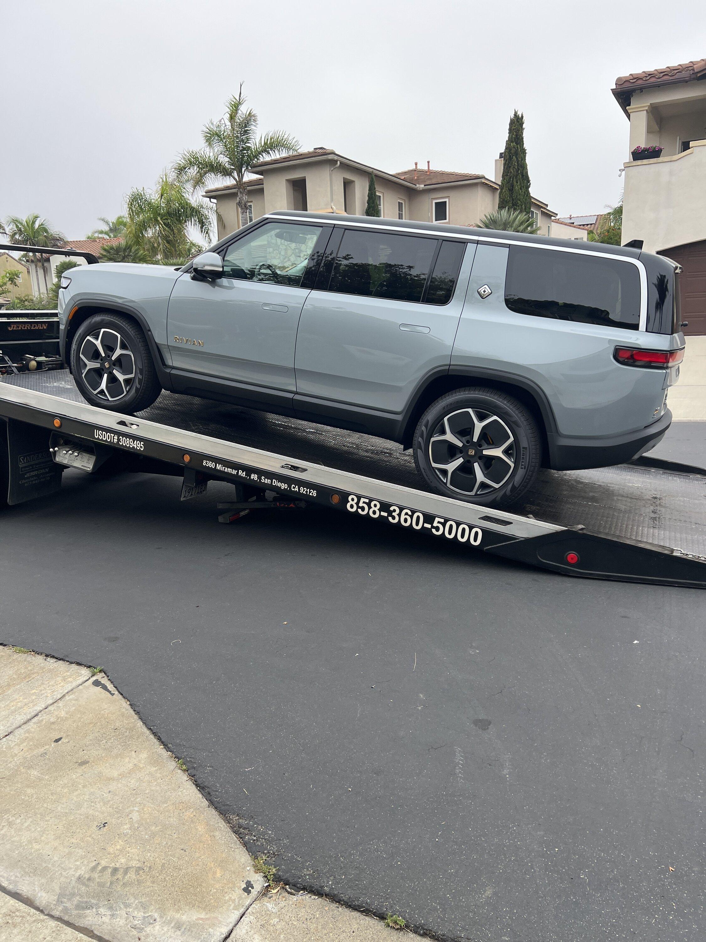

Wow!! Your story sounds very similar to mine. I even have the same color. My R1S had a wheel sensor fail which left the vehicle in operable. It spent 10 days at the service center before I got it back. A 100 miles later 12 volt system fails and once again it gets towed. Love the vehicle but I can’t depend on it. My Tesla, like your’s, was flawless. Might be time to think about something else…unfortunately.
Well I think it is just bad luck and hopefully they will fix it and you will be happy. Or maybe they just replace it although that usually doesn't happen. I had a Tesla Model S 2019 and had it towed 4 times. I was about to give up on it and then it worked for over a year until I sold it to buy a used Rivian R1S.

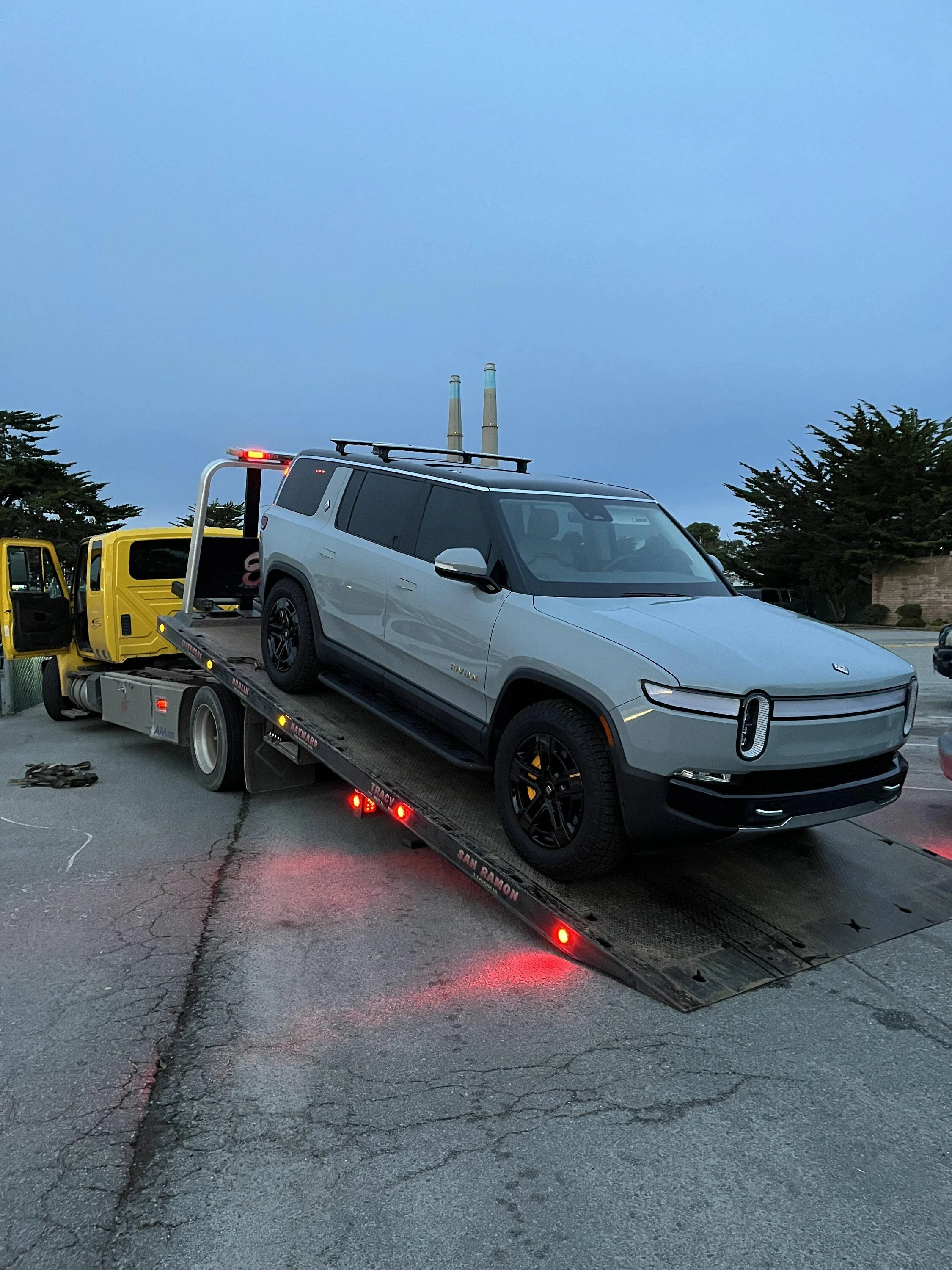

Thanks for sharing your story. I feel a little better knowing I’m not the only R1S owner that has recurring problems. My wife is driving around with this 12V warning and I’m worried the truck will stop functioning. Did your 12V battery last for a week or more before you were stuck?
It started with not being able to not engage in drive or reverse. Then the thing did a reboot all by itself while I was on the phone with service. Shortly after the screens went black and there zero power through the 12v system. We jumped through the trailer lights plug in order to open the frunk. Then put a jumper on the 12v battery on the firewall. Then I was able to shift it into neutral so we could drag it up onto the flatbed. After they got it to the service center it had no issues and they were able to drive it off the tow truck. That was a week ago. It’s been working ever since but it still at their yard. They’re still trying to figure out what happened.
Sounds like the 12V died, and the HV battery contactors disconnected so it wasn't able to maintain the 12V from the HV battery. When you jumped it, it probably gave the 12V just enough juice to recontact with the HV battery and the HV charged the 12V enough while on the tow truck to get back to normal operation while being transported.
