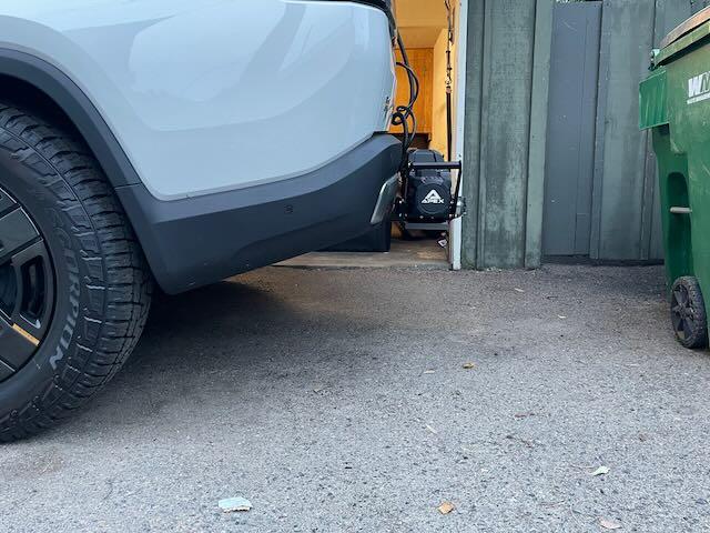

Something like this may be more your speed

View of Departure Angle Change:
Yikes... ya problem with those receiver winch mounts... anything other than a light trail is going to end up smashing that thing. And it's a catch 22 because a light trail you don't even need a winch.
