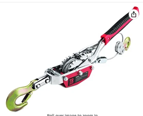

I personally have run a 4-ton hand winch / come along, a tree saver, and a couple of soft shackles for the last year or so. This is the one I bought specifically. Motor Trend ran a similar model when they did the Trans-America trail. It's pretty compact and fits neatly below the frunk load floor.
https://www.amazon.com/TR-Industrial-Portable-4-Ton-Puller/dp/B074986SW9/ref=sr_1_7_sspa?crid=6R7E8BX2IMTM&keywords=hand+winch&qid=1668198284&sprefix=winch,aps,476&sr=8-7-spons&psc=1
Thanks for the share seems reasonably priced.

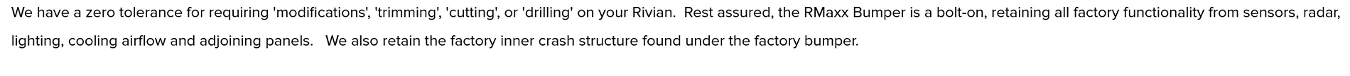

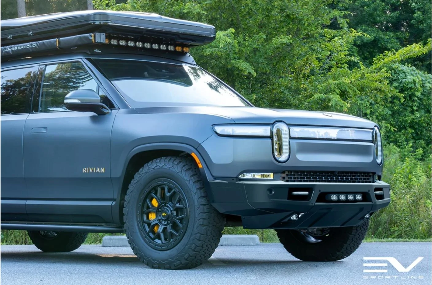

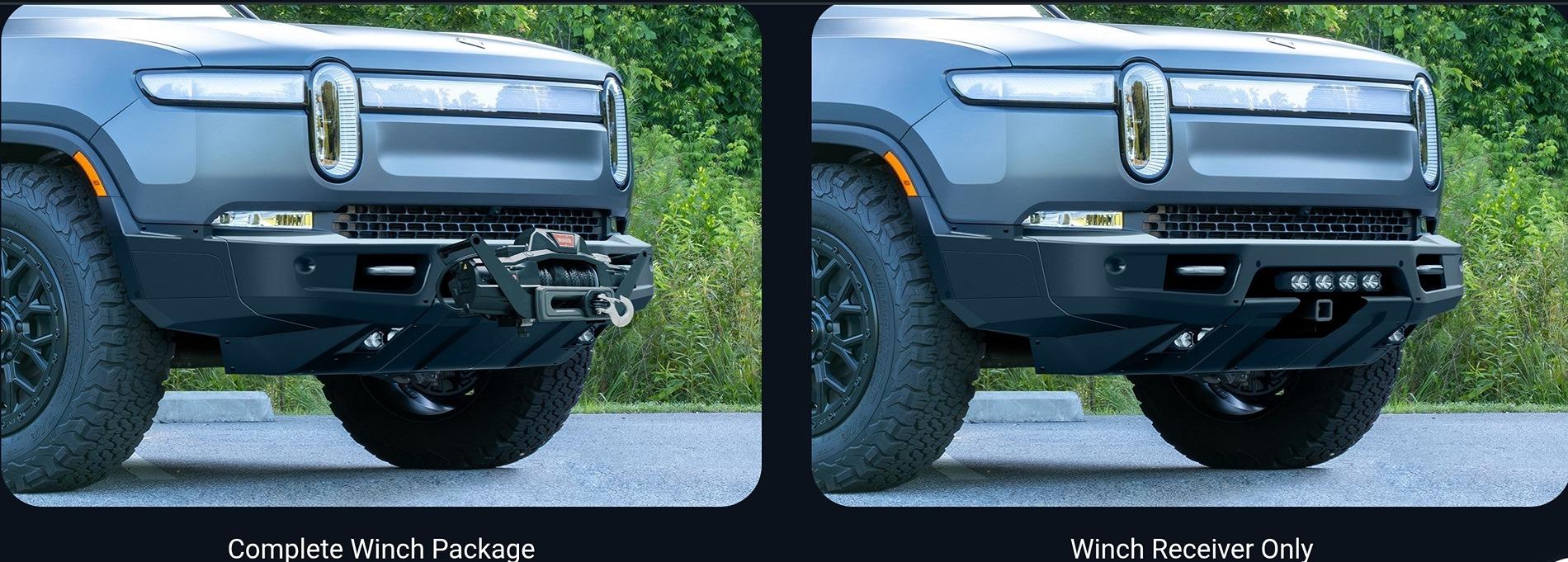

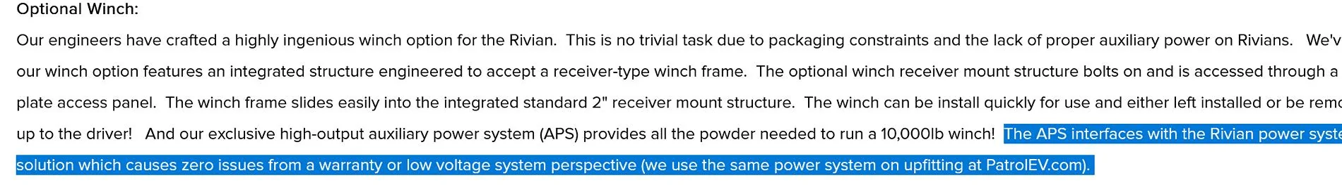

It finally happened, and is currently available for preorder.
The capacity is 10,000lbs but will require an additional bolt in battery inside the frunk consisting of a single AGM or LiFePO4 battery which charges off the vehicles systems.
Jose at Rivian tracker has all the appropriate links and information below.
https://riviantrackr.com/news/evspo...Qf0hjv76nWoGrczJKs_aem_wBl83tSjtmM_ULjTmkcT6A

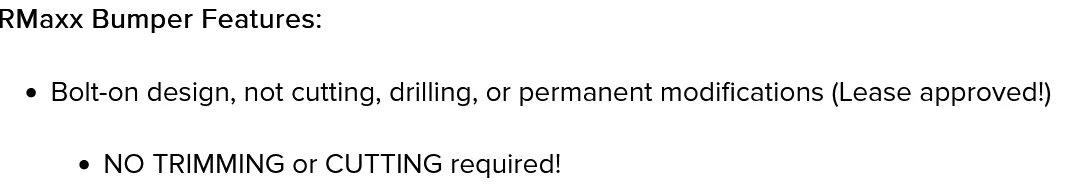

I'd be quite curious if Rivian would refuse to test drive a vehicle with warranty issues when they've done this much modification near the safety structures.
MountainBikeDude
Jun 20, 2019
56
3,381
7,224
Vancouver
Seemingly no issues.

Rest assured we do everything to design and engineer products properly. Swapping bumpers and adding winches is nothing new, it's just new to the Rivian space. For instance, my Jeep Wrangler has an upgraded bumper and winch -- the winch is the same winch we sell for the Rivian -- and these are parts optioned directly from Jeep when I spec'd the thing.
Also, keep in mind the Rivian is equipped with 2 tow hooks from the factory; the underlying structure is properly equipped for pulling (aka winching)
