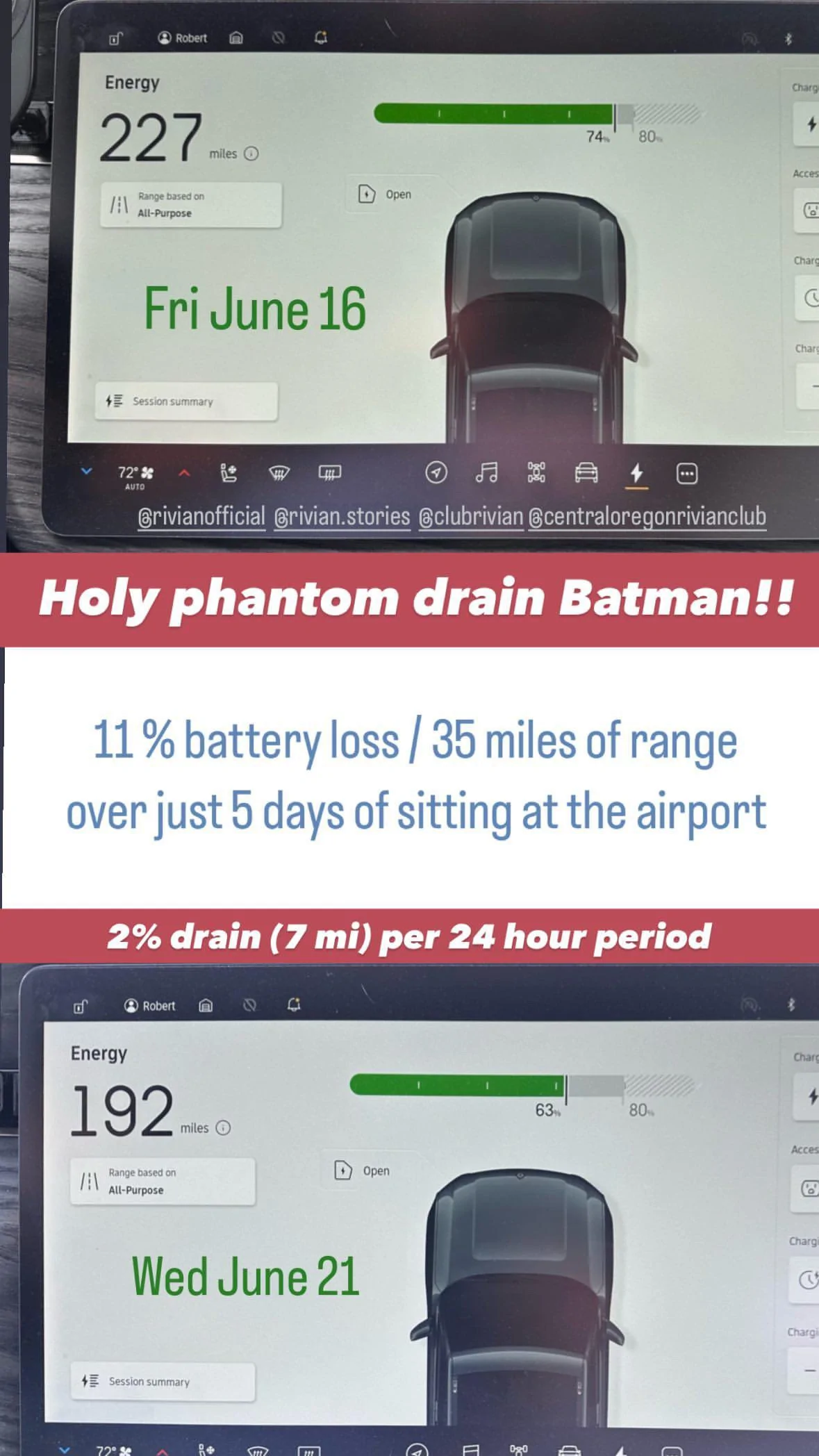

Posted this to my IG Story recently, and it summarizes what I currently experience. This was at the airport, no extreme temps either way, no special measures taken (Gear Guard ON, didn’t set to Shipping mode or Camp mode, etc). I didn’t check on the vehicle at any point between departure and arrival (didn’t wake it during it’s parked state).

Well... Gear guard on

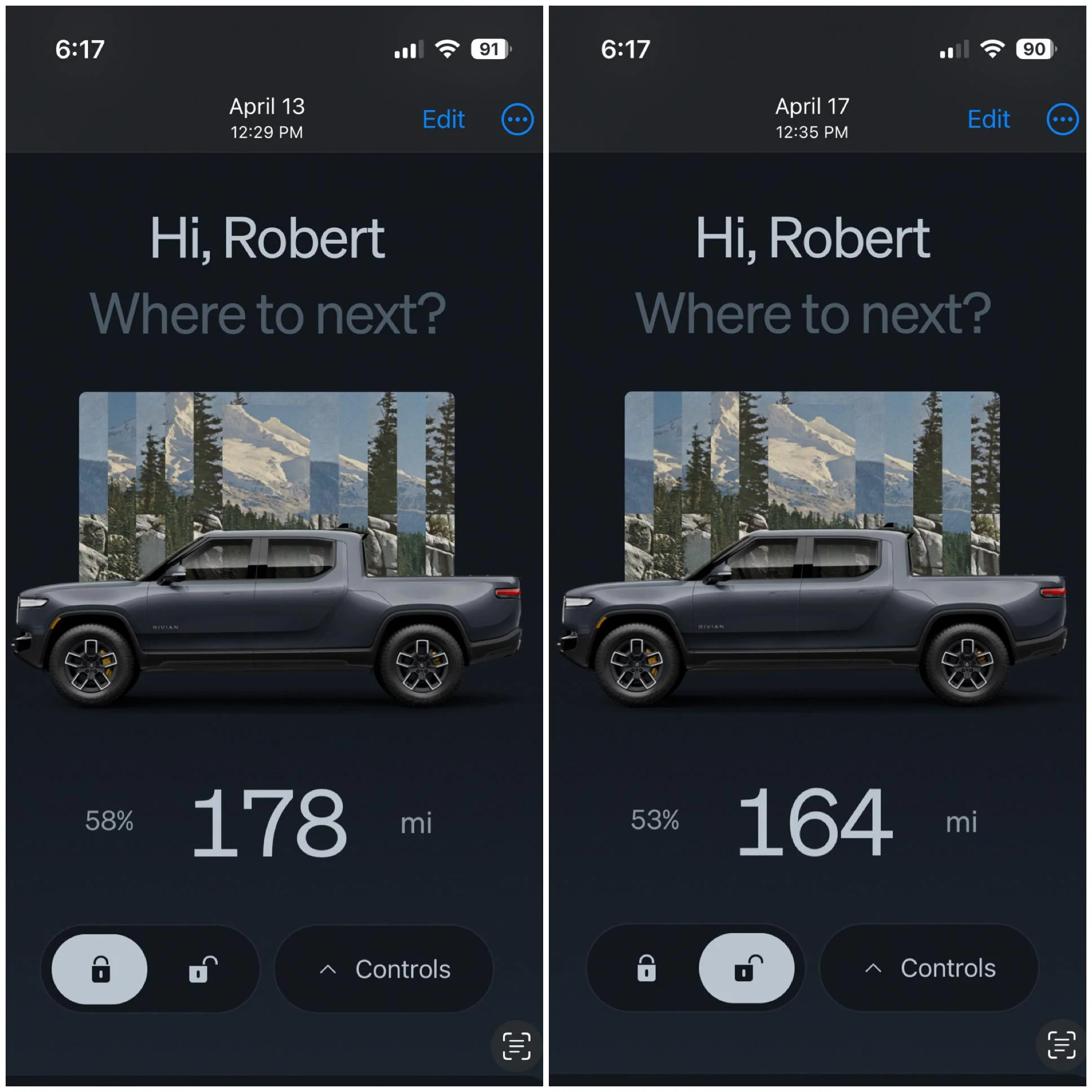

Not really a valid excuse, for a couple reasons:
1) The whole point of Gear Guard is to work while you’re away from the vehicle. If owners are having to disable this security feature because it excessively drains the battery, what’s the point (of having it)?
2) My vehicle recorded exactly two events over that 5 day period (i.e., wasn’t constantly being evoked)
FWIW, I did a similar trip back in April and saw half the SOC/range loss (with much colder nighttime ambient temps). Same parking lot, same vehicle settings, but on previous software (version .14?)). 5% loss (3.5 miles a day) over 4 days, almost to the minute.
