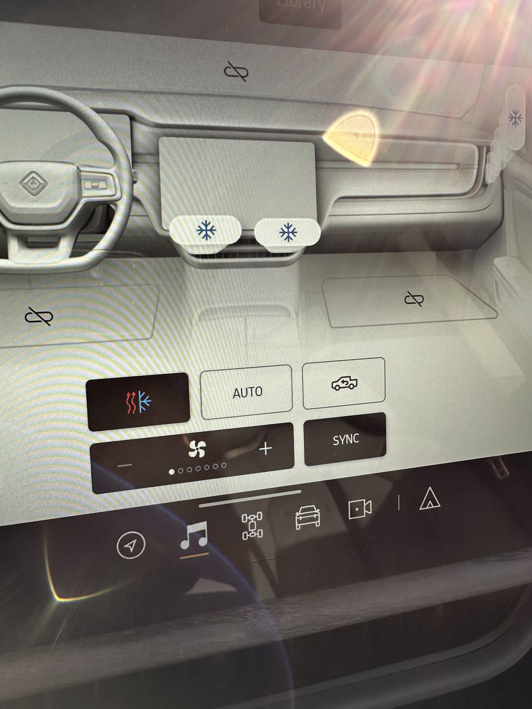

1. Set AC on like this. Level 1, recirculation OFF.
Rivian R1T R1S Possible diy “fix” for whistling noise coming from AC recirculation 1700524042251
2. Enable camp mode, so the AC stays on, while you’re outside of the car.

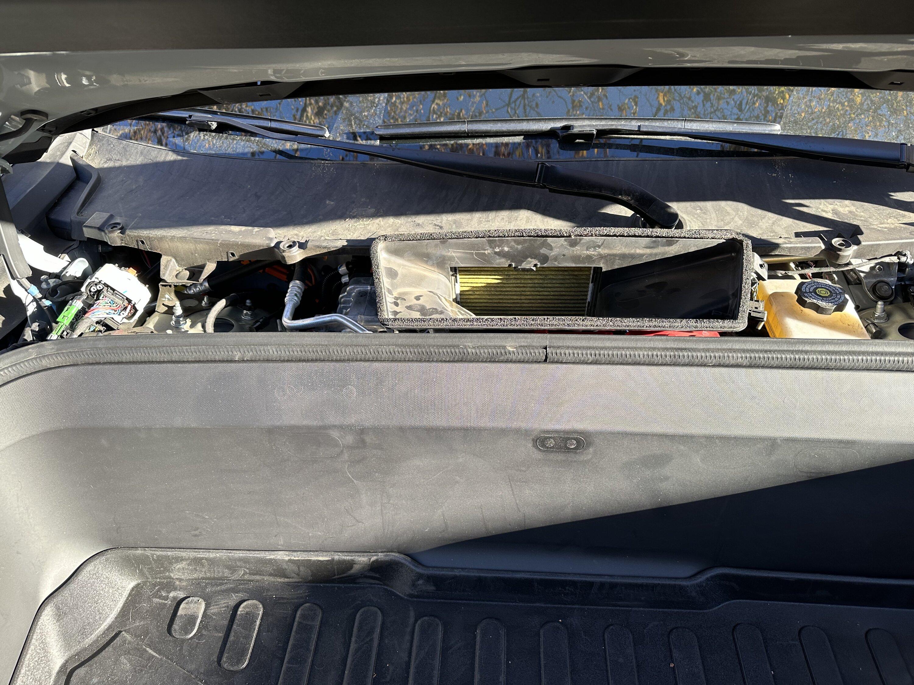

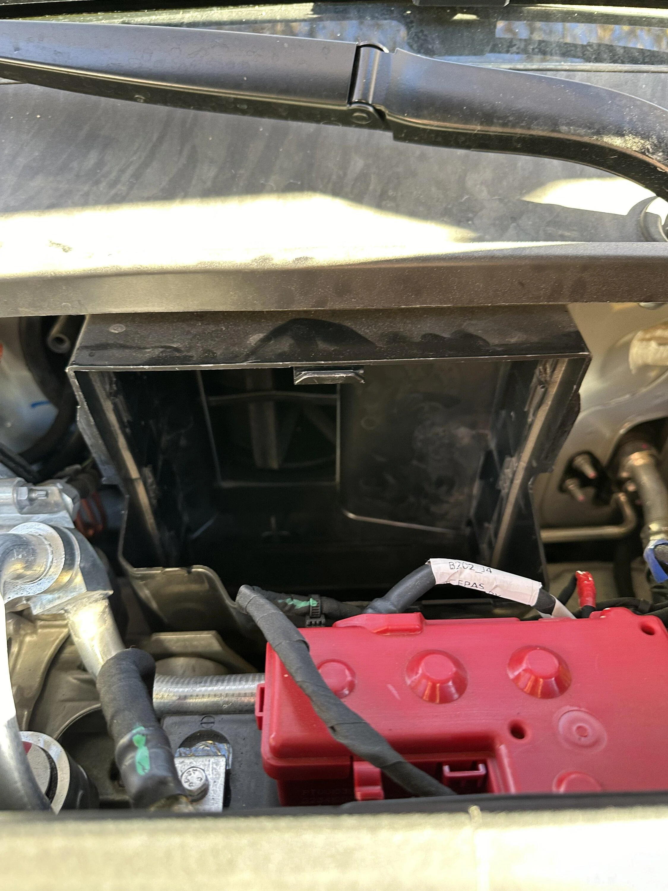

3. Open the hood and take off the plastic panel to reveal the air filter.
Rivian R1T R1S Possible diy “fix” for whistling noise coming from AC recirculation 1700523985028

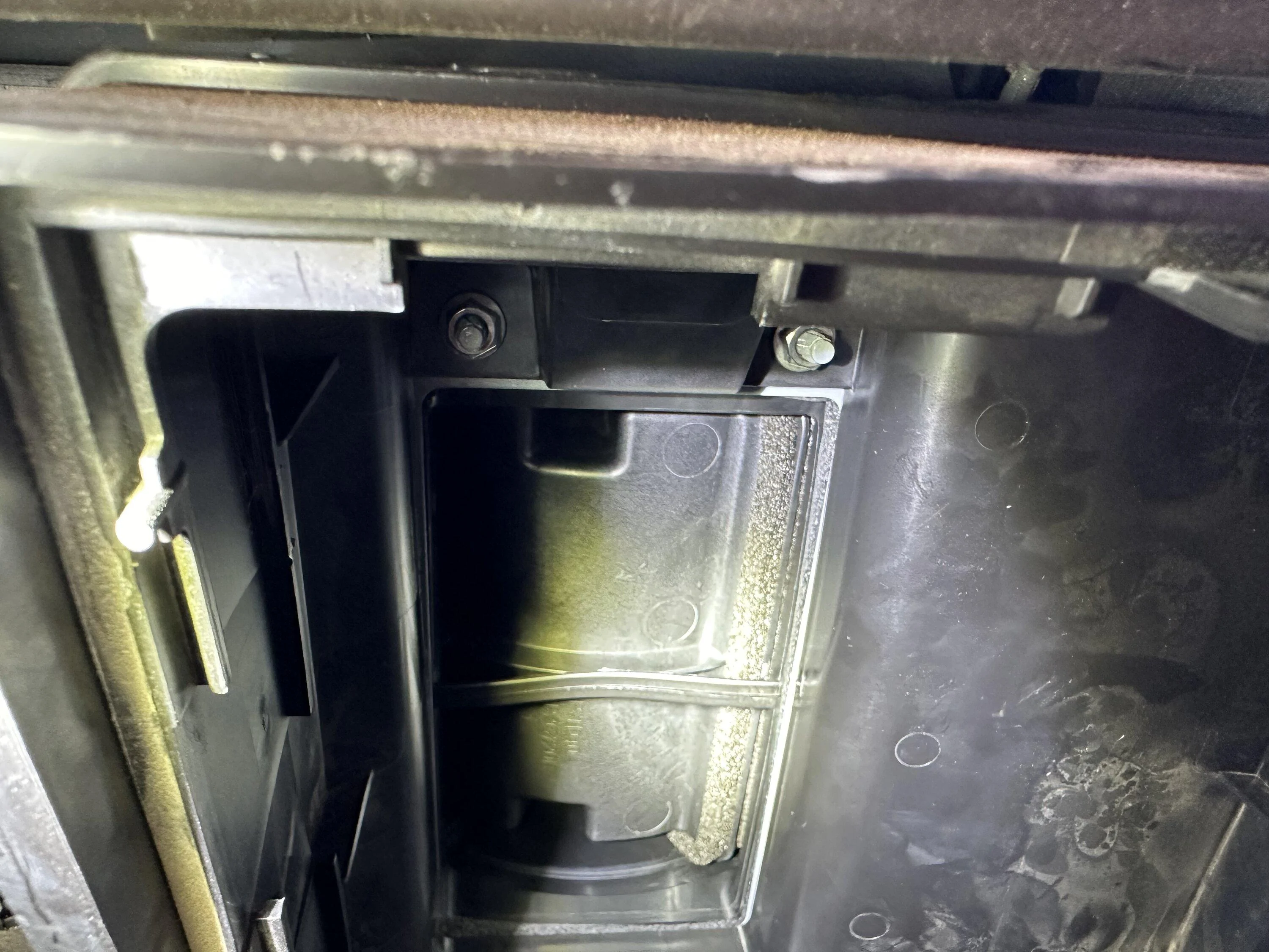

4. Lift up air intake plastic cover and take out the air filter. Then, place the air filter holder frame back in its place. Should look like this:
Rivian R1T R1S Possible diy “fix” for whistling noise coming from AC recirculation 1700524196728

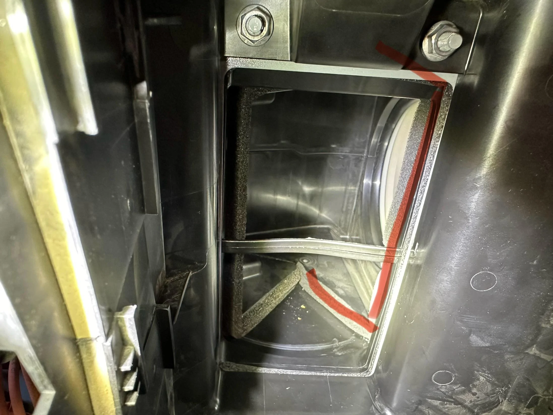

5. Careful here. Cut out strips of the foam, and stick them into the three sides as shown in red here. There will be a plastic ridge. The picture shows the results after I’ve placed the foam. Try to be clean and not have any sticky backside of the foam exposed
The AC fan is adjacent. Be careful of your fingers!

I didn’t bother with the service center. This fix worked and it looked like the entire front dash would need to be removed to get to this part. More worried about entire disassembly and reassembly, and something further going wrong.
For this project, I’ve actually revisited. Only the vertically placed foam stripe is necessary. That got rid of the noise entirely too. I wanted to do the minimal adjustment and still achieve my goal here.

Thanks! Can you post a picture of that? Or use the old one and highlight what you did ?

In my picture above with the red highlights, just apply the foam strip on the vertical red line. Ignore the two horizontal ones.
You’ll feel a ridge inside. Use that as your guide.
I don’t think there’s a risk of something getting into the hvac system after properly putting the foam on.
But, during the foam attachment, be careful to avoid small pieces of the foam getting loose. Eg.Apply a clean cut using scissors with one go.
