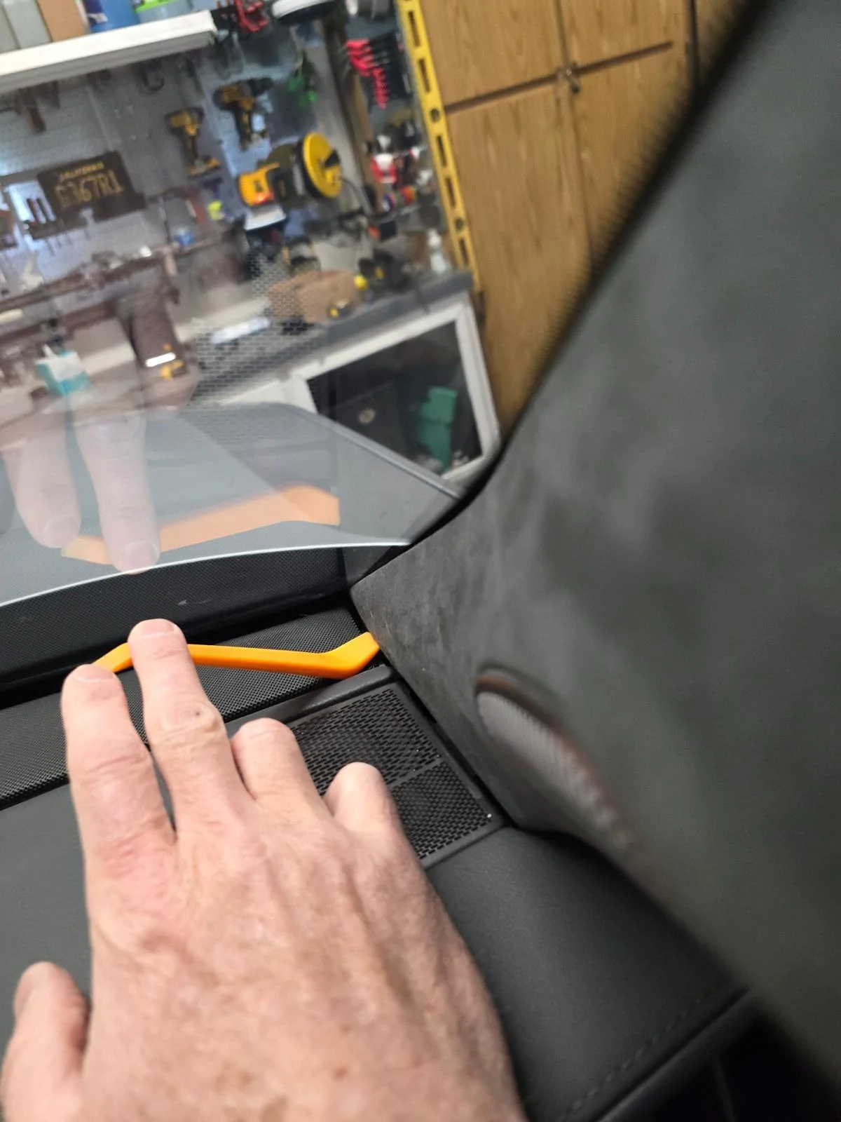

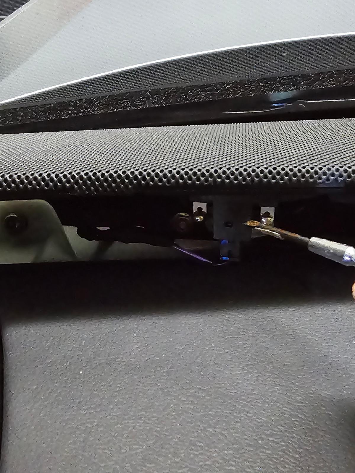

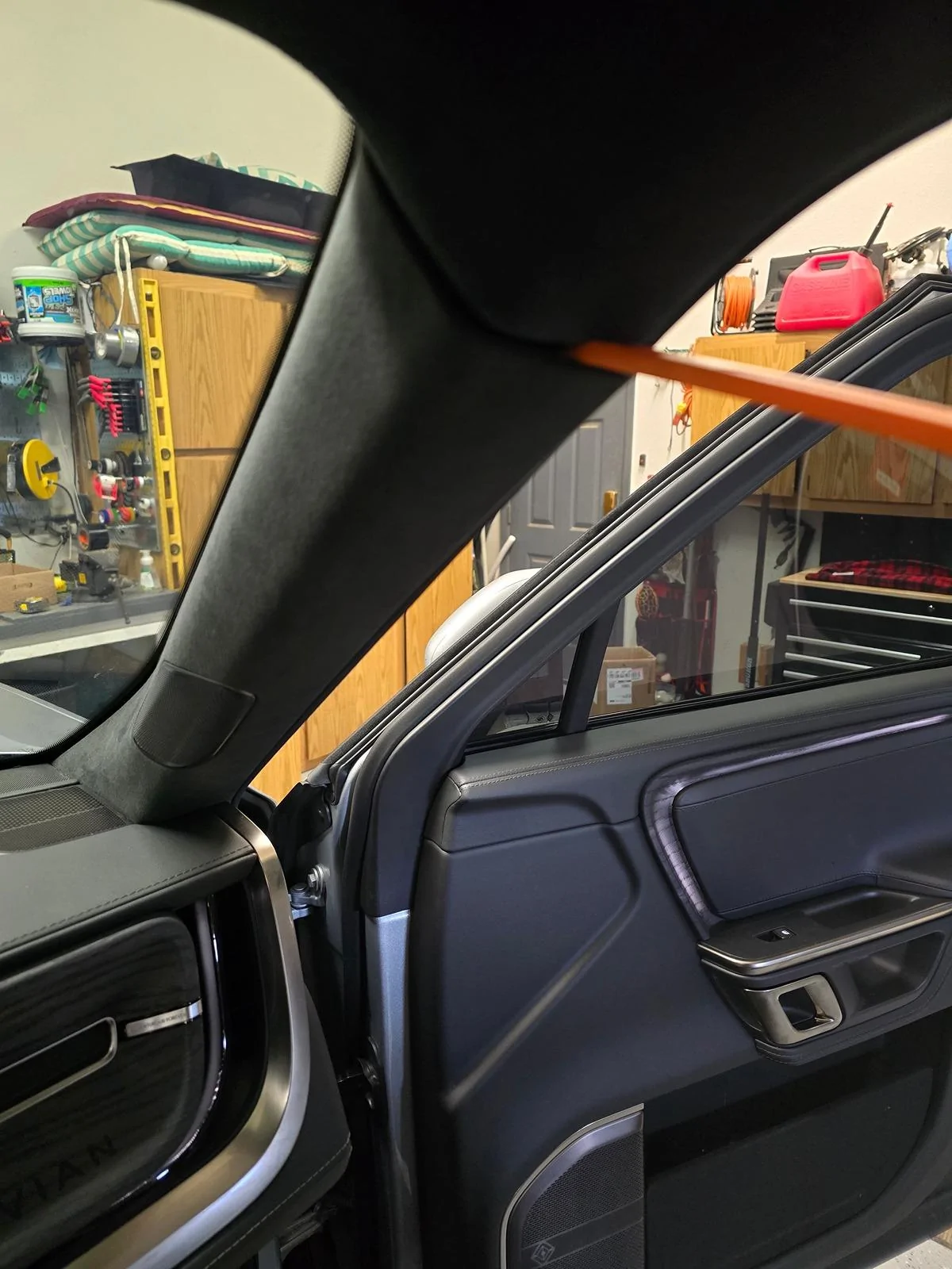

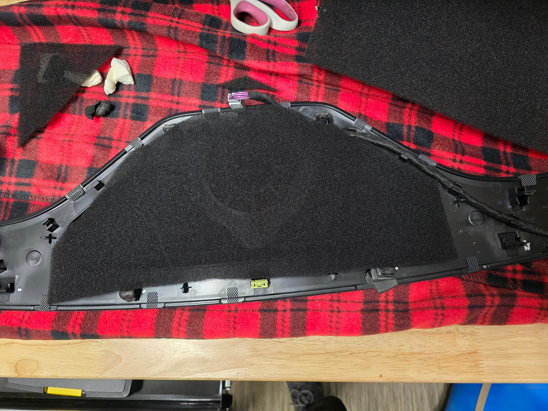

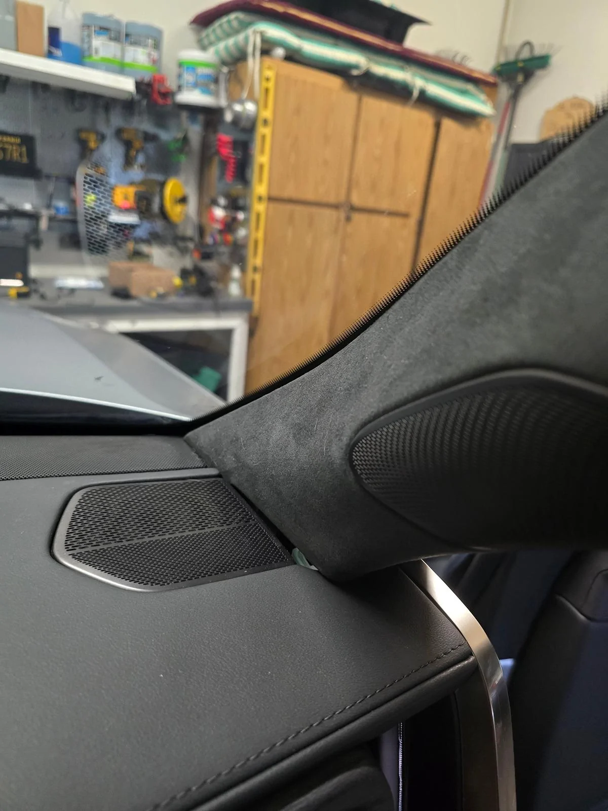

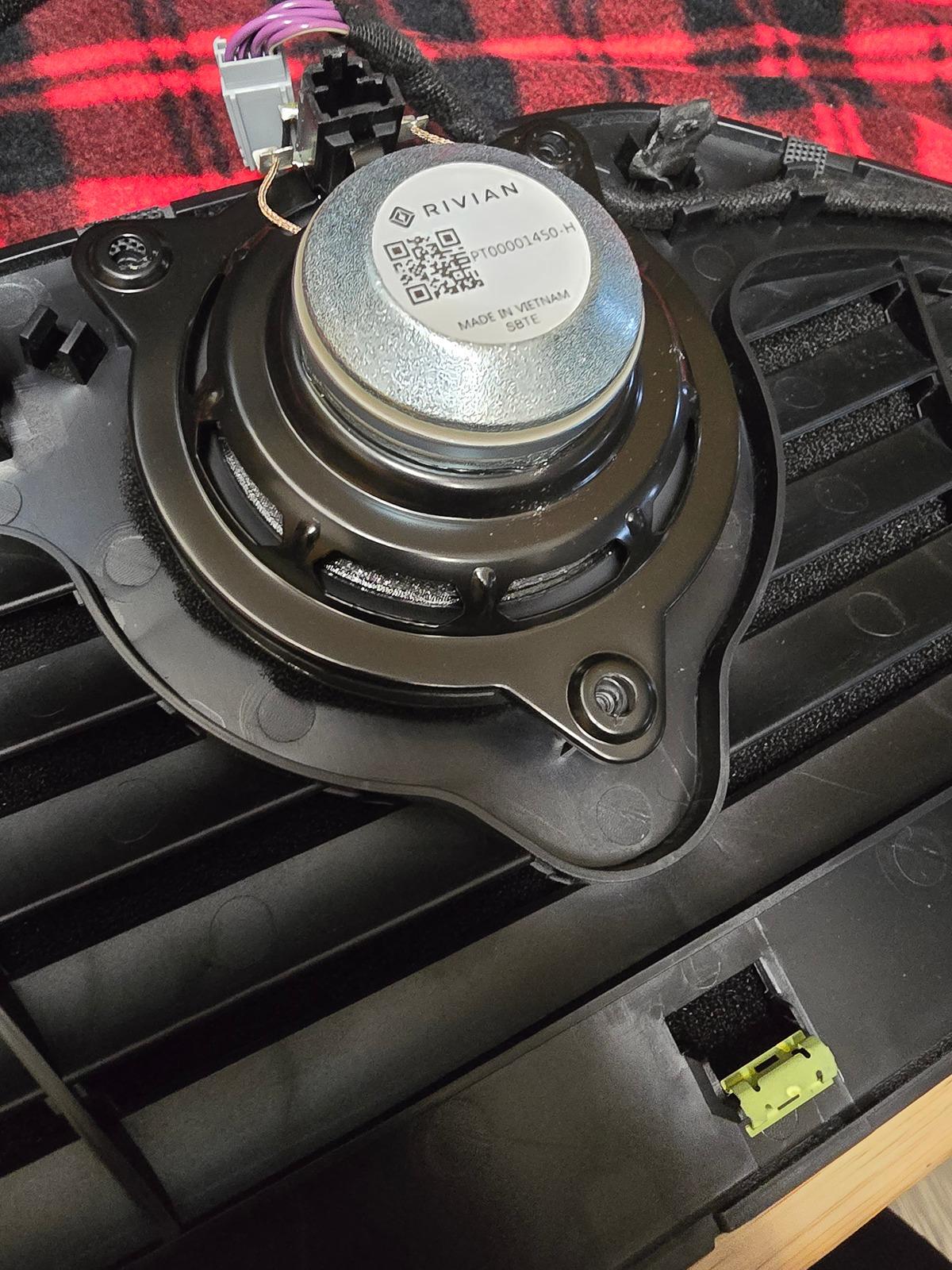

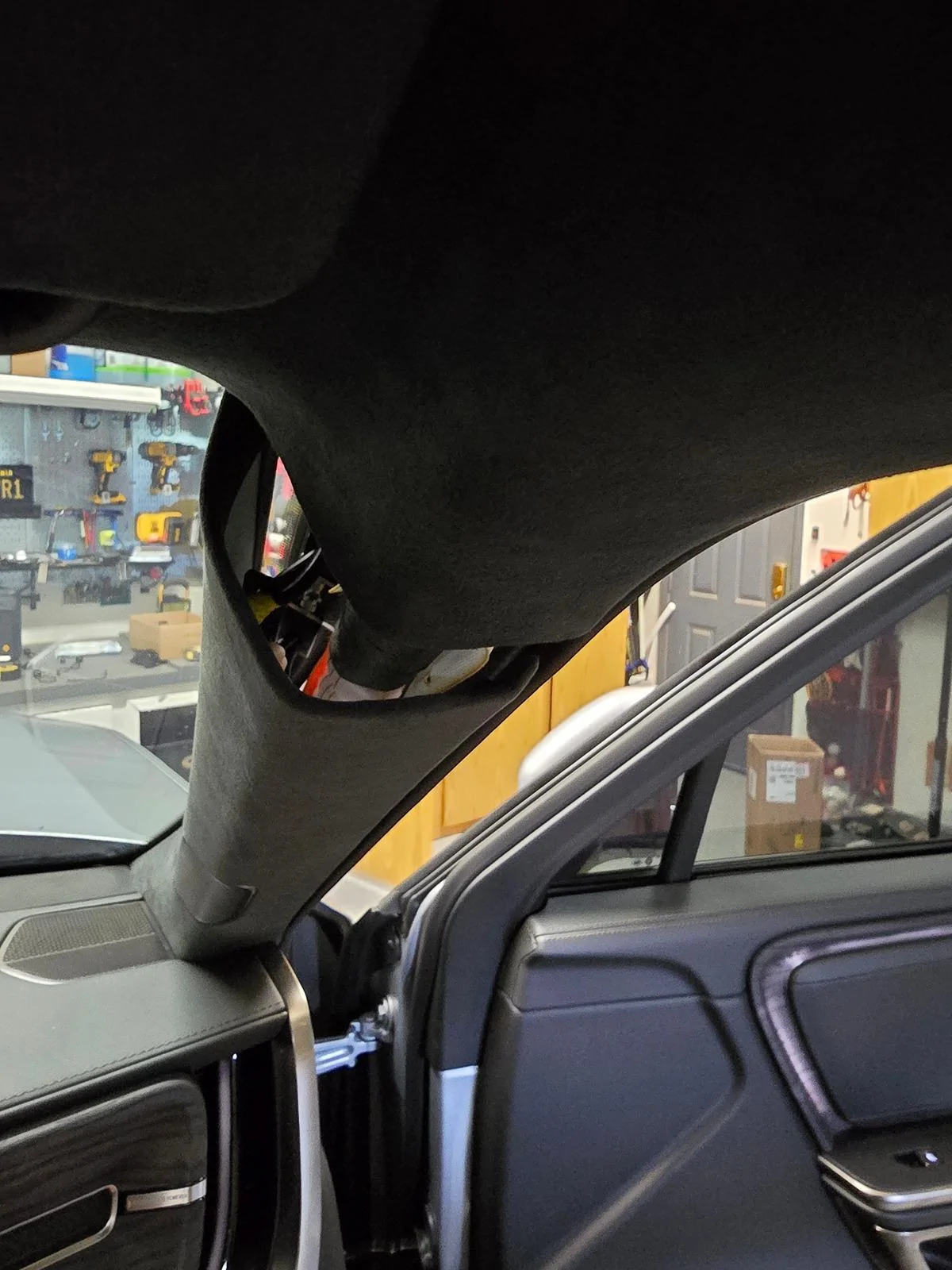

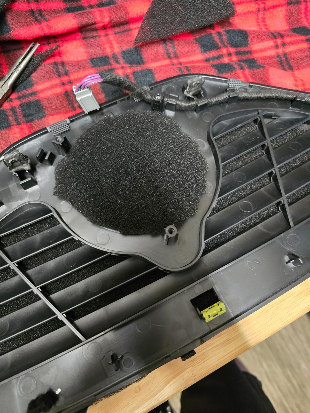

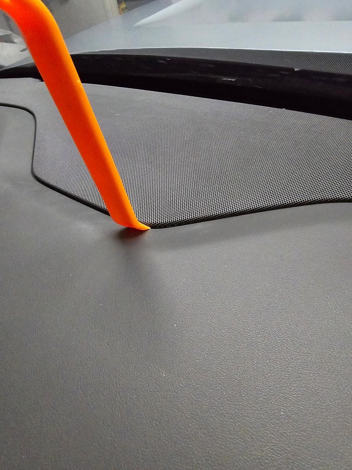

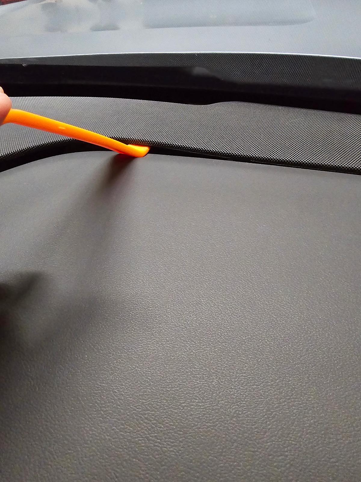

Thanks for the inspiration Have Blue. I tackled this today since the squeak was killing me and it was Friday and the boss was out of town. ?. I wouldn't worry too much about the airbags. There are no sensors in there and not connected to trim that is removed in any way that I could see. I used the same method as Have Blue. I'll add some pics to help give more perspective. I used hvac foam between the hard plastic skeleton and wire mesh top by bending a few of the mesh tabs of the metal screen and laying the foam in. I also put some foam between plastic frame and speaker. 'll post a follow up if it worked or not in a week or so. Foam here. Frost King Air Conditioner... https://www.amazon.com/dp/B000BO68BU?ref=ppx_pop_mob_ap_share

Very nice. Thanks for adding content. I don't believe the rattle is coming from the speaker rattling against the grill. I should have clarified that. The speaker has foam around it already and was tight to the grill. I believe the weight of the speaker hanging from the grill causes the grill to bounce and rattle against it's other mounting points.
Hmm, looks like you put foam between the metal grill and plastic backing frame? You know that could very well be an issue with the two parts rattling against each other.
