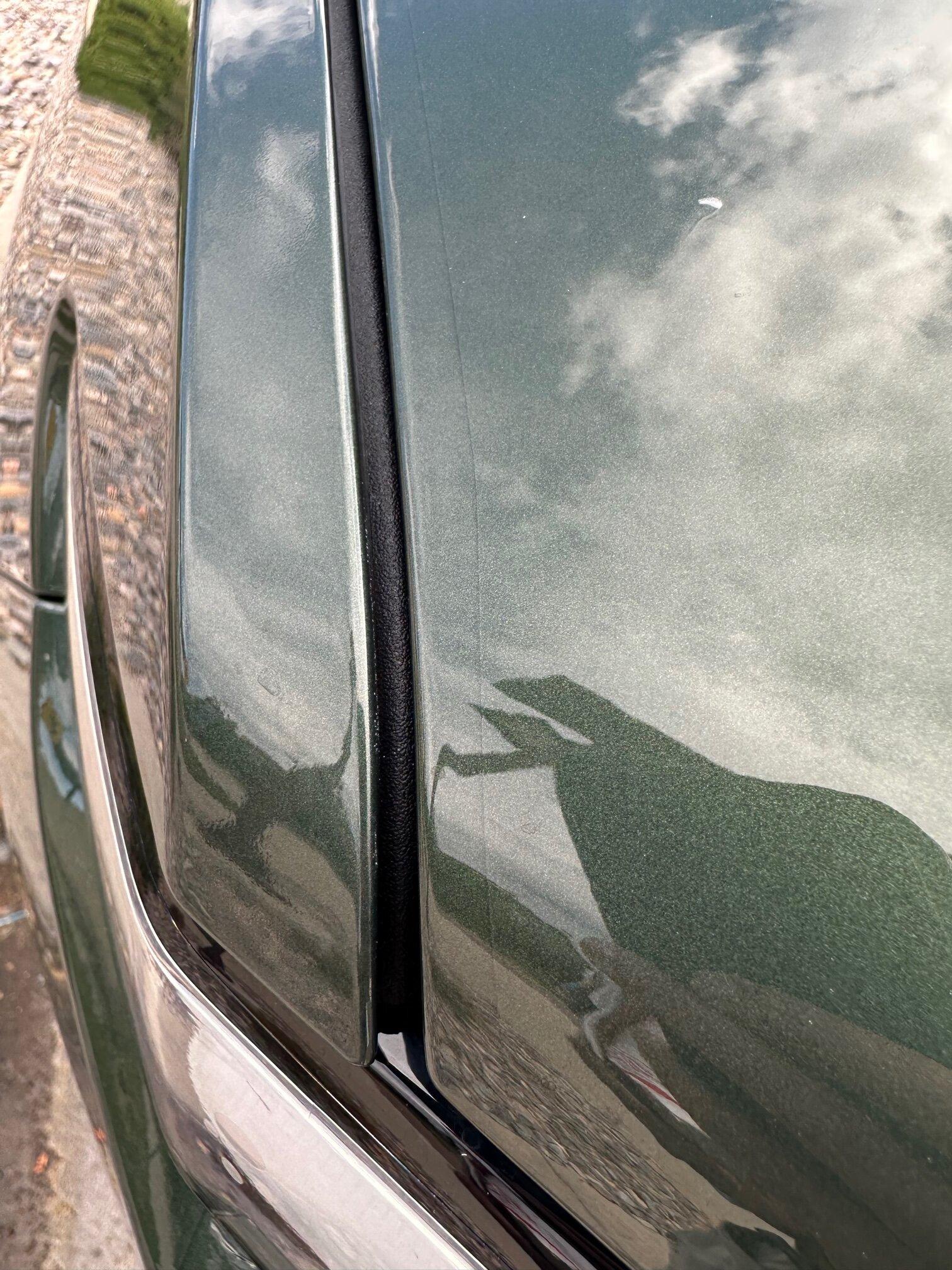

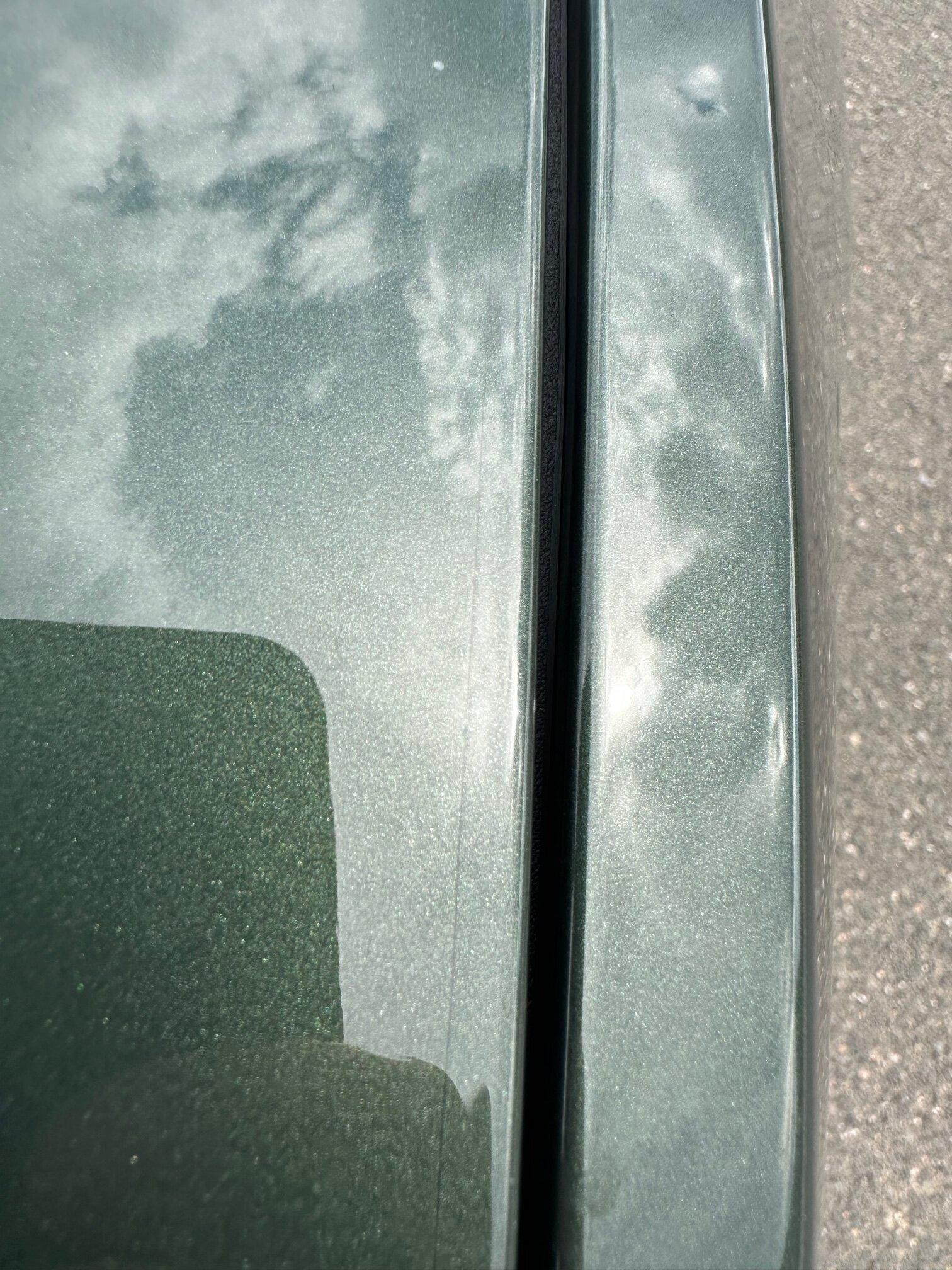

How much of a gap on each side did you end up with and ~ how long did it take you?
@twraps, this is what I wound up with. Maybe half an inch? It's enough that I'm afraid to apply ceramic without blocking off the gap in case I ever install a full piece later.
Thanks....That is pretty substantial. I've done some DIY ppf in the past and the gaps were about 1/8"
That would've been closer to what I would've expected. The rest of the panels I've done so far are closer to 1/8 - 1/4".
Noted! I will revise the cut model, I have my R1S now just need to find a little time to re-check and re-do, and I will also be doing a version with edge wrapping (for all panels). If you want this replaced (if you are not happy with the fitment) just let me know and I will arrange it as soon as I revise the model.
