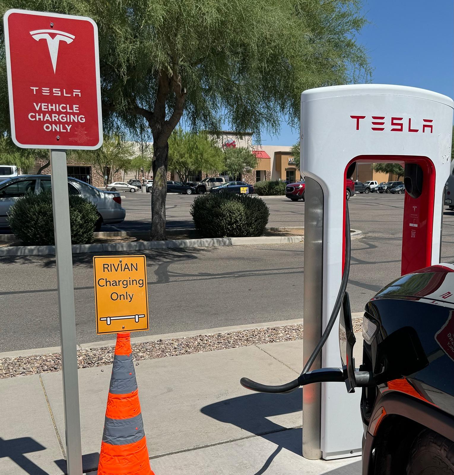

Major game changer, and the ONLY reason I considered trading the Tesla for a Rivian.
I've never seen a Supercharger outage, or even a single broken station, in years of usage.

Sorry, I should have worded it differently and will go update it.
I saw the charge rate plummeting for no apparent reason, touched the adapter, and it was hot. This was in Tucson, mid day, hot as hell. I poured water on the adapter and the charge rate went up. But I cannot say that the adapter itself caused it, and didn't mean to.

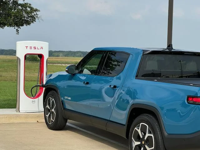

A2Z yesterday. Love the SC network. EA and Chargepoint and EVGO are dead to me. LoL.
