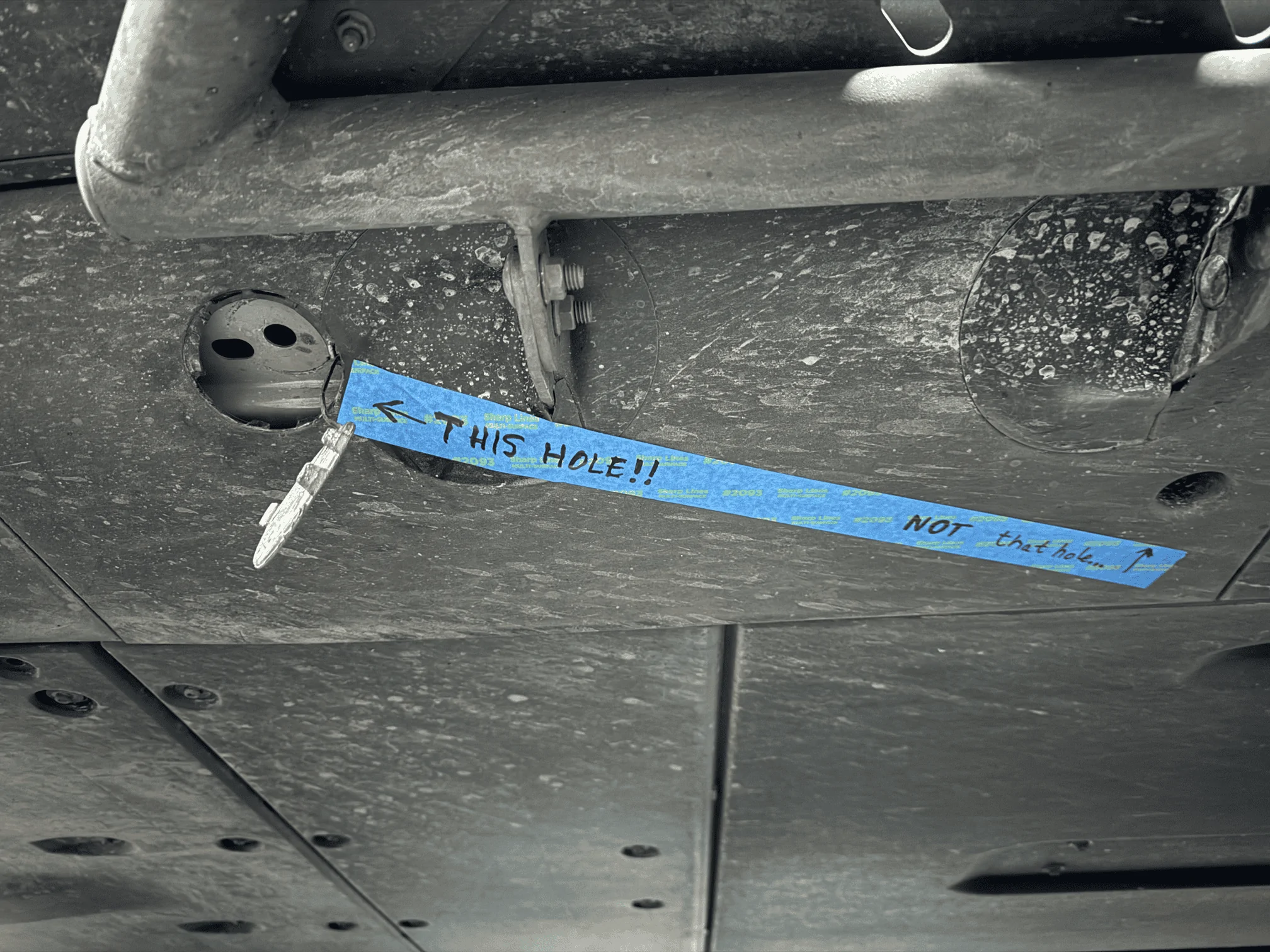

The stuck the pucks into the panel bolt holes for me, now they’ll be replacing them. So far the insurance claim process has been fairly easy, just waiting for them to approve the claim.
my favorite part is they all cannot fathom how one of their employees could possibly mess it up, and yet they keep doing it wrong

Had a similar issue at the local discount tire with my Rivian when I had it. I asked if they were familiar with the process and had the pucks to lift. They said yes to all. The kid working on my Rivian placed the puck in the wrong hole causing a plastic panel underneath to pop out. He had placed the pucks into the panel bolt holes. I was pissed!

Sorry to say I had a horrible experience at Discount Tire in Kirkland, WA. I had an appointment for a tire rotation. When I arrived and I was getting checked in I specifically asked if they had worked on a Rivian before, had jack pucks and knew how to go into tire change mode on the software. He said yes to all.
I waited in the lobby as they pulled my truck in and was watching them. I didnt see anyone go into the software to enable tire change mode so I walked out to check and sure enough, it was not on. I turned it on. I had to do some work so was not watching for 5 min. When I look up I see them jacking up the truck with floor jacks that have a rectangular rubber/foam material that's being placed directly onto the underbody. No jack pucks.
I walk out there and tell them they need to stop, lower the vehicle and lift it up using jack pucks on the jack mount points. They tell me its fine because I have rock sliders which have the underbody shielding that they can jack the vehicle on. Only I dont have rock sliders, I have running boards. There's a difference. Mine don't have any underbody shielding. They were lifting my vehicle on the plastic body panels. WTF.
Anyways, once they get the truck down, they go and get the jack pucks so I go back inside. A few minutes later the technician comes out and says they cant lift the truck using the jack pucks because it doesnt fit. What? I ask them to show me the puck and its plastic and it has no nipple to secure it properly to the jack points on the truck. I had brought mine just in case and show them the kind of puck they need to use. I had to end up giving them my pucks to lift the truck.
Unfortunately, they had already jacked and rotated the tires on the other side. There's damage to my plastic panels. Hopefully there's no damage to the body underneath the panels.
Very disappointing experience when I was told they know exactly how to lift the truck when clearly they did not. I will not be going go back to this location. Probably not going back to Discount Tire. I''ll just pay the extra to have Rivian do it.
oh, and now they charge for tire rotation unless you bought the tires from them.
the force of the jack on the plastic panel and the weight of the vehicle caused the panel to get pushed up into something, likely a bolt/screw and create an indent.
You can clearly make out the rectangular outline of the floor jack being put directly up against the plastic panel
