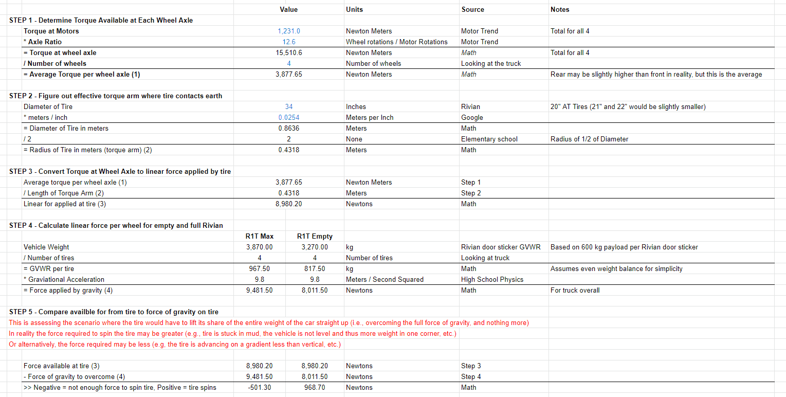

My biggest fear around our current 4 motors system is that the lack of wheel spin we see in the videos may in fact be a real limitation of the total torque potential of the respective motors.
I ran some numbers to get a sense. You can check my math on the image to keep me honest.
Full disclaimer: I'm not a scientist, or a mathematician, or a magician, etc. although I did graduate from high-school.
The bottom line from my analysis (assuming I didn't screw up that math, and I'm sure someone here will correct me if I did) the problem may really be that the motors just arent' powerful enough (especially once you start loading up vehicle with weight and introducing other factors like mud/rolling resistence, etc.) to spin the tires in some situations.
This is not the answer I wanted to see, as it would diminish the hope for clever software fixes (unless they can increase the total torque.)
(Incidentally, the smaller radius, non-AT tires would have a small advantage in having more available force due to the smaller torque arm.)
This same thing is hinted at in one of the videos from Kyle. One of the trucks doesn't have the power to pull itself up against the rock, you hear him saying in the video that it ran out of power.
Finally, some math! It seems a lot of people forget that any given wheel is only driven by one motor. If only one wheel has traction, max torque is a quarter of total vehicle torque (ignoring any programmed safety limitations), which may simply not be enough given the gearing and vehicle weight.
A locked axle (even in the dual motor setup) would increase the available torque to either wheel on the axle.
Really good point, and strengthens my conviction that moving to a dual motor architecture will help. With power split between axles rather than wheels, you would have at least 50% power to any given wheel rather than 25%.
