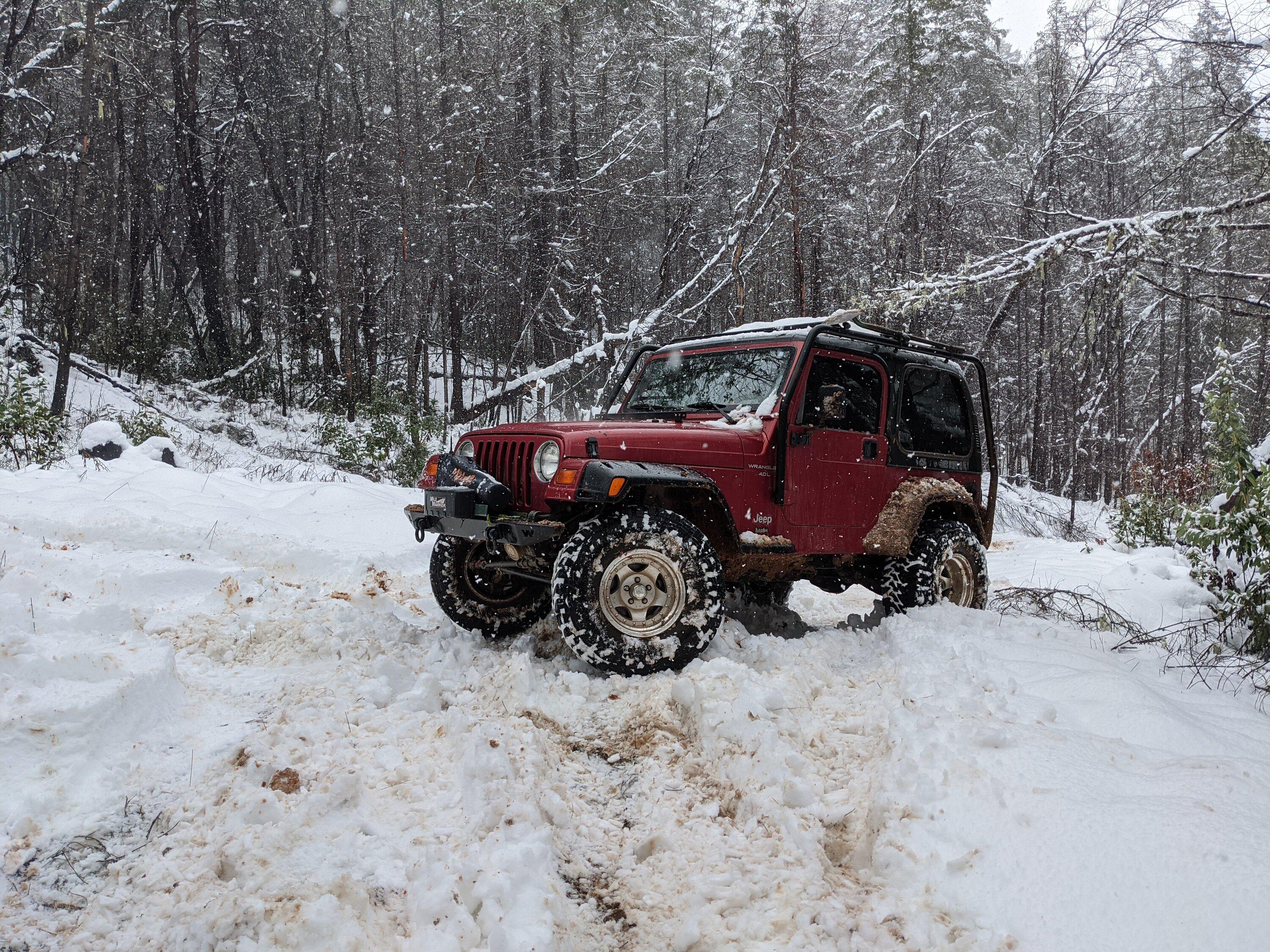

Please read the entire thread before tossing around statements like someone doesn't know what they are talking about, and do not bring the Tesla-style fanboy toxicity from those forums to this one.
It seems all threads eventually get taken down by the keyboard warriors, so why not have some fun with him lol.
I think we really have played this thread out anyway. I am hoping for improvements to report as updates come in, but more likely than not the off-road tires will not go back onto that truck. Mostly because it is not a "fun" truck to try to get through the obstacles. Most of our outings have a destination, and riding in somebody else's truck for the last half of the run because yours did not make it up a portion of the trail is not fun; it is a little humiliating lol.
This, I am sure, is not the case for all terrain types. The quad-motor seems to do quite well on rocky and hard pack surfaces. Most any surface where you are not dealing with soft ground, or ultra-low traction.
Unfortunately, we have those two things in abundance here.
