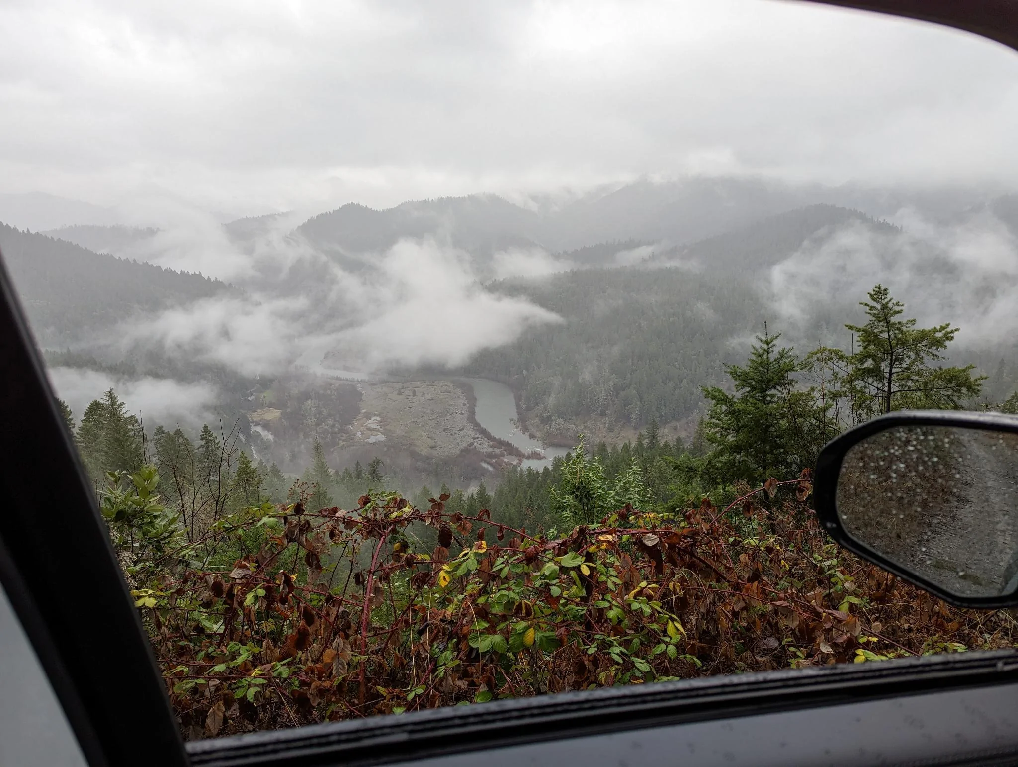

That is the Rogue River below me, taken from my driveway. It is over 1,500 feet below me, and my steep driveway winds down to it to hit the pavement. Slipping off my driveway could easily be fatal.
I am far less concerned with the Rivian's rock climbing ability than I am with it's ability to keep me on this road when conditions deteriorate. The quad-motor's penchant for freaking out & going sideways is the thing I could not live with.
That is where I hope the dual motor will help me most. I am hoping it will handle more like my Y, which handles these conditions brilliantly BTW.
Does the visual help?

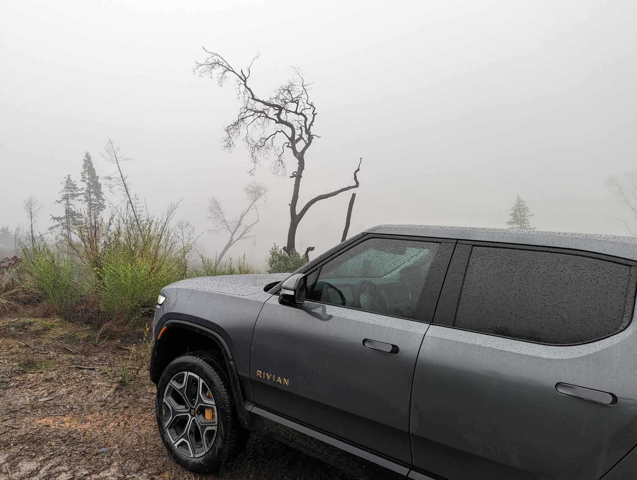

I'd love to see a picture of it before it goes. Or better yet, a picture of it on a trail.
Rivian R1T R1S Quad motor vs locking diff signal-2023-01-12-18-54-35-945-1
She did not do well on trails lol, but that has been covered. She is back on her street 22s & all cleaned up. The trails remain the domain of my far more expensive rig:

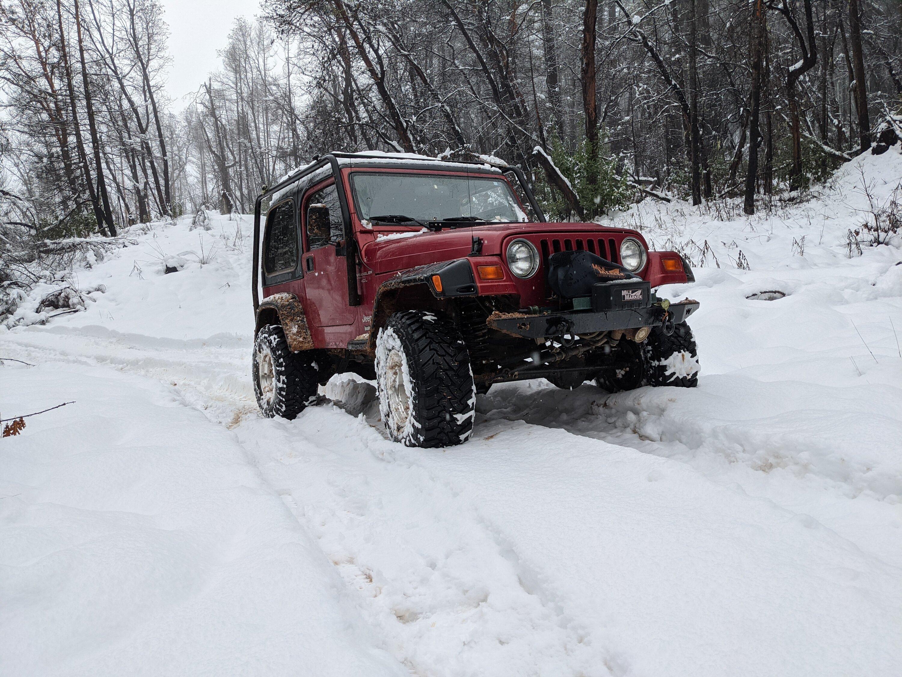

Nice, but surely you must have a picture of it on a real trail with real offroad tires, no? Or at least something other than the OEM 22" wheels & street tires. I had this impression in my head that you really tested your Rivian offroad.
