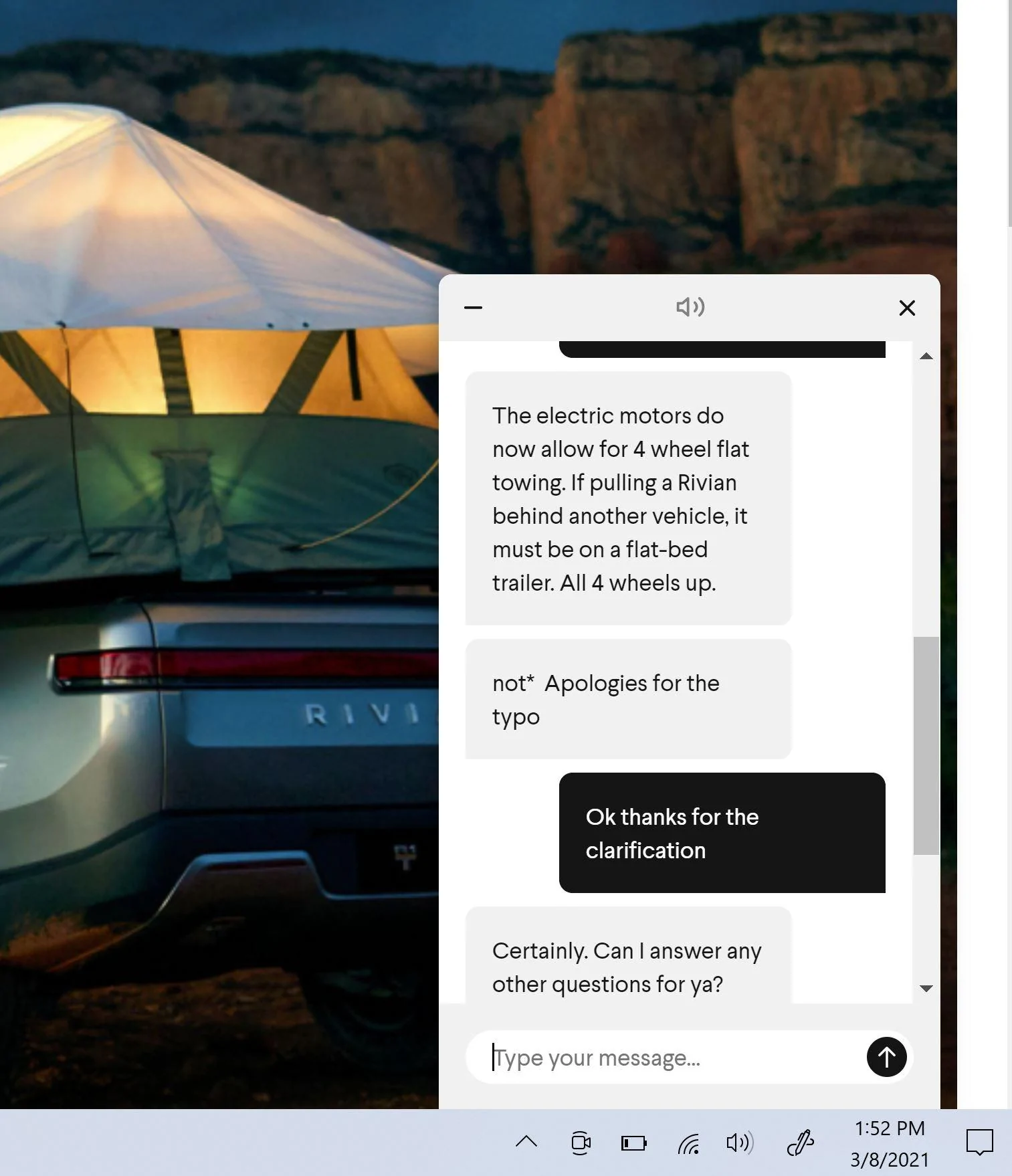

Rivian did verify it. I posted the proof. You just choose not to believe Rivian for some reason. They have confirmed NO flat towing.
Posting a screenshot of your conversation with a low level customer service representative is not evidence that they won't offer flat towing. The CEO stated otherwise.
Also, there is nothing about the electric motors that would prevent flat towing. It is the software.

I had hoped to be able to flat tow an R1S behind my diesel pusher but Rivian told me neither T or S is to be flat towed since the motors are not disconnected and the inverters would suffer damage. Currently here is no disconnect to make this possible which evidently applies to all EVs based on my research to find a towable EV. And while it would seem that if you can tow charge why can’t you flat tow, they are two distinctly different processes. The vehicle is moved for short distances while tow charging and must be occupied by a driver while doing so. Flat towing is different in that the vehicle is towed the duration of a trip, except when disconnected for use at a destination. It cannot be occupied and must have an auxiliary braking device in most states.

I know this won't meet Cappy's standards for evidence, but i checked with CS for clarification, and they stated that this is a question they've been getting a lot and therefore asked engineering for an answer, which is:
Rivian vehicles are capable of being tow charged but are otherwise not flat towable. If you are looking to go long distance with a Rivian towed behind you, the vehicle will need to be secured on a flat bed trailer.
