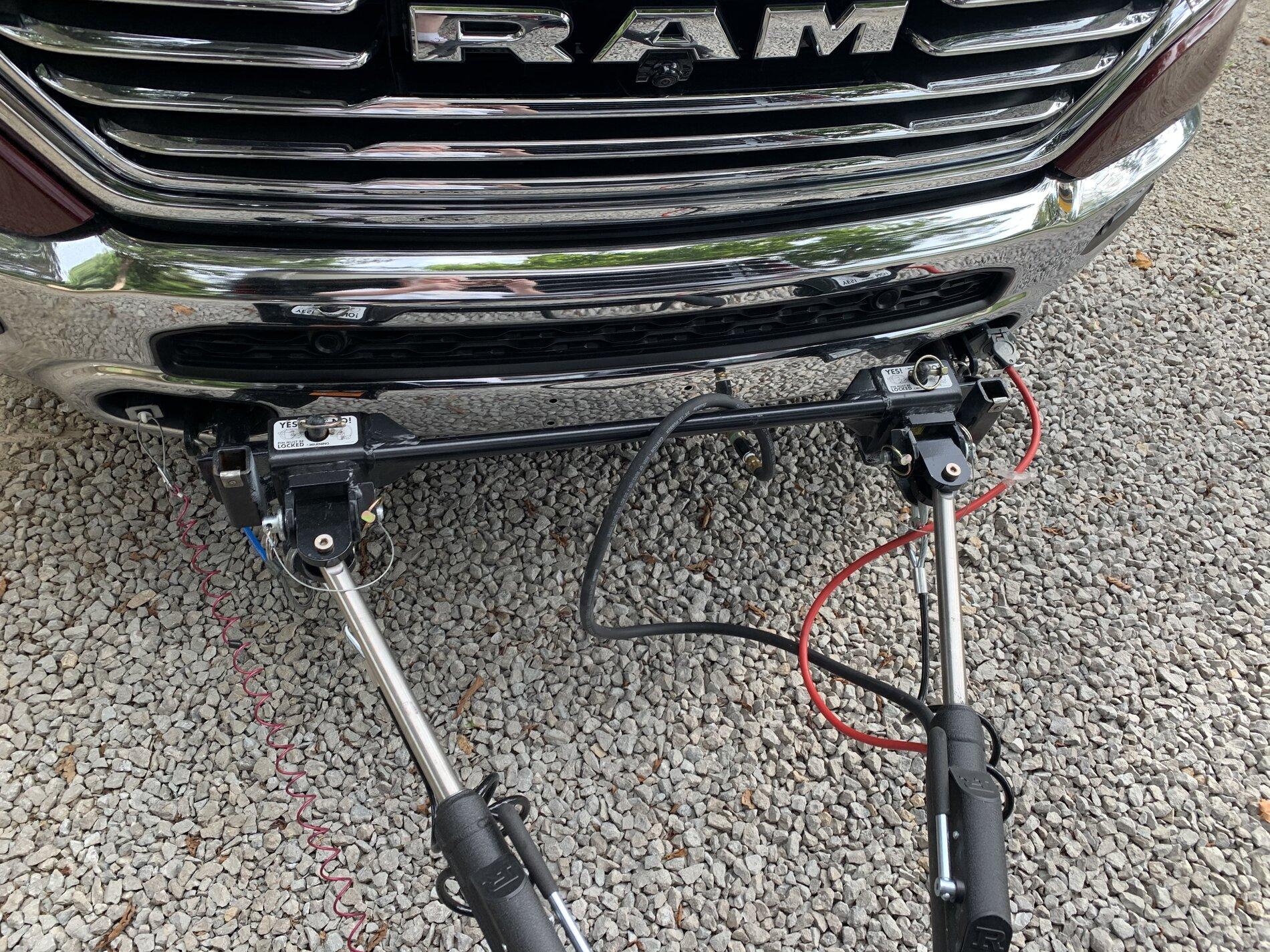

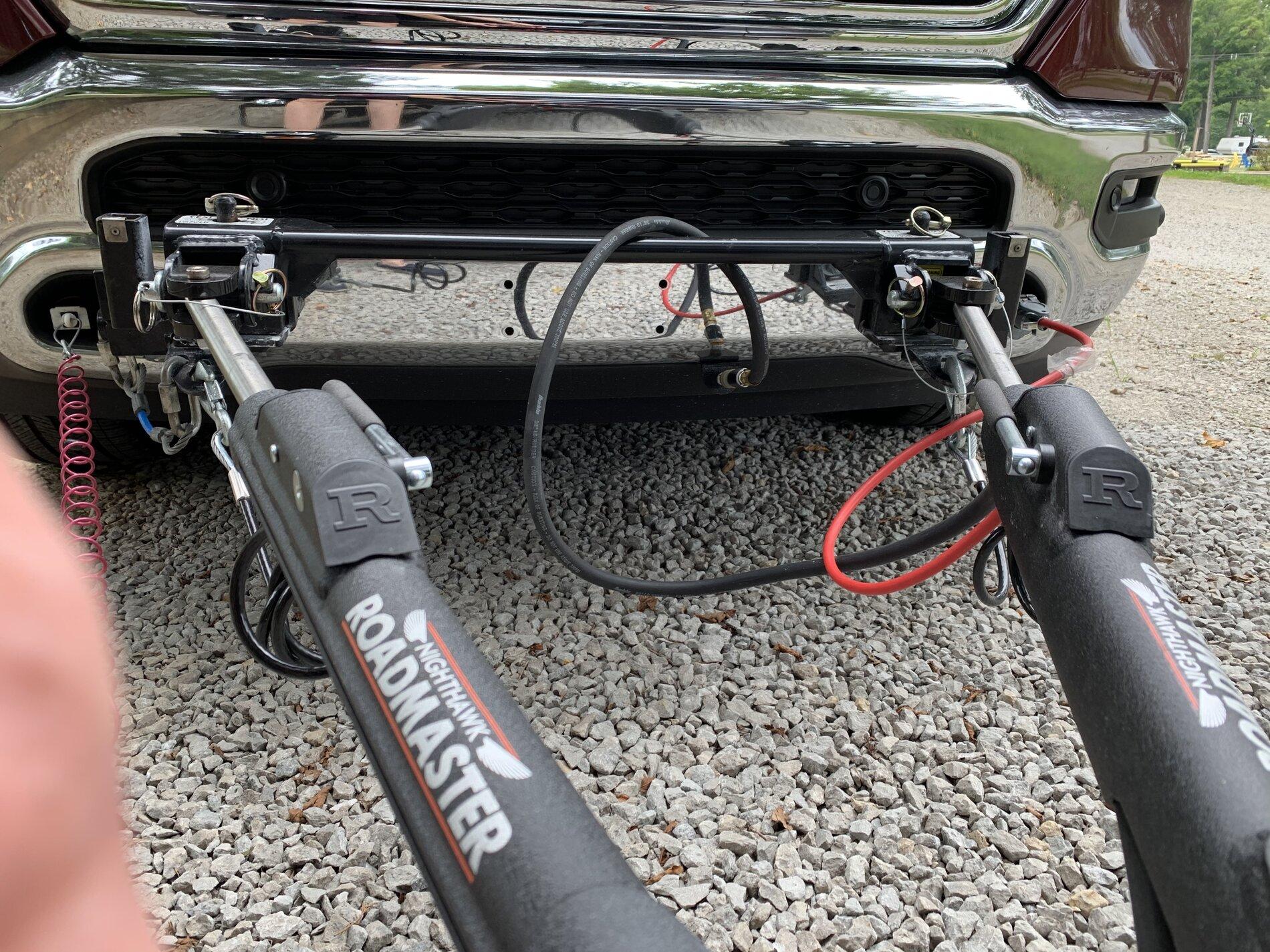

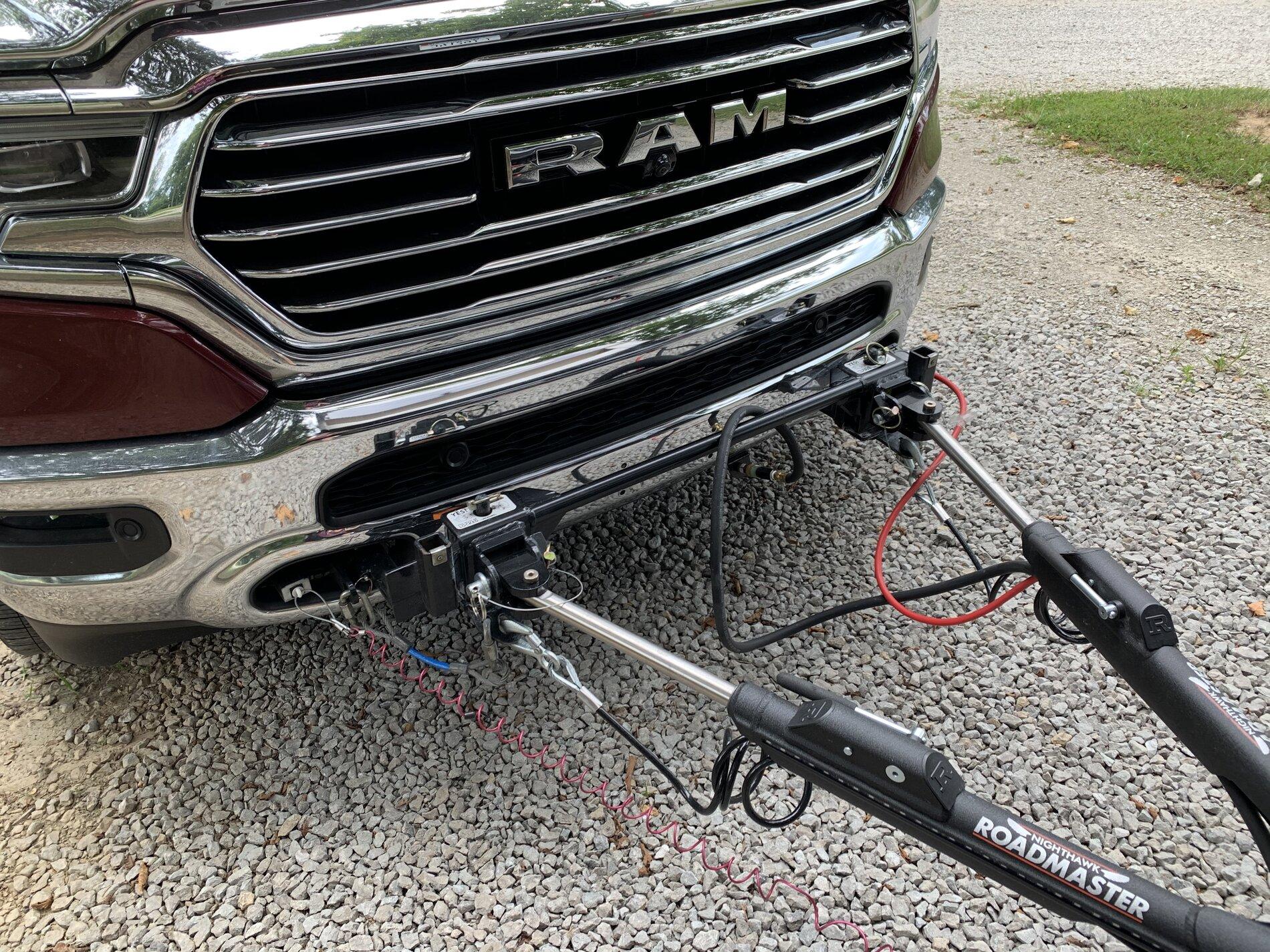

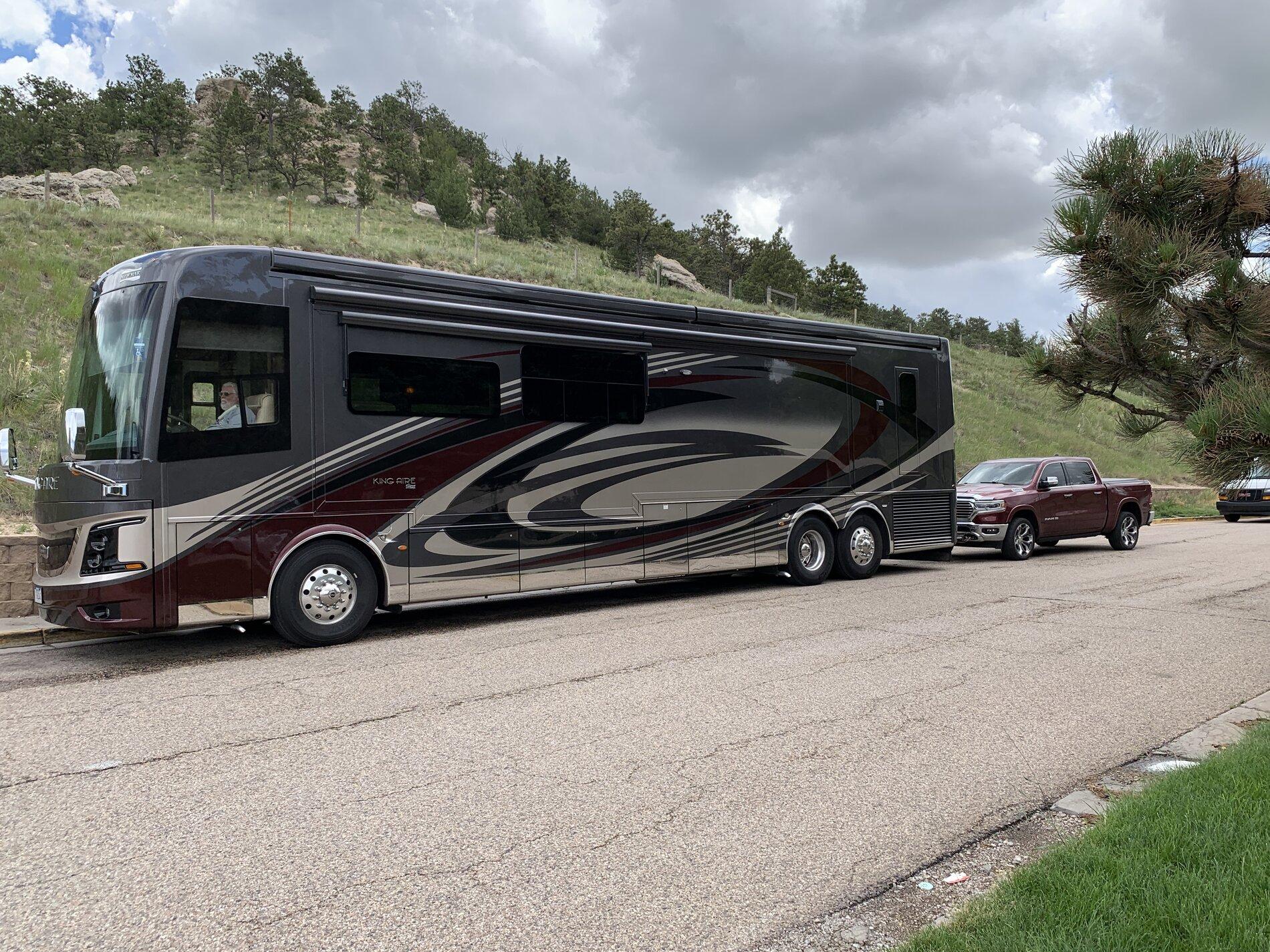

As a full time RVr who travels a lot, I see a lot of larger vehicles being towed including hummers, pickups, and large SUVs. My toad is a RAM. I also see some stacker trailers, some of which can carry two or more vehicles. If Rivian doesn’t want to address this market, I would hope that they would release the driveline specs so companies like WARN could supply wheel lockers for all four wheels.. We can then manually unlock the drive lines at each wheel hub as we connect the Rivian TOAD and lock the drive lines when we disconnect. It makes a lot of sense for me to have a Rivian and towing it to my next adventure spot is just my way of getting there.

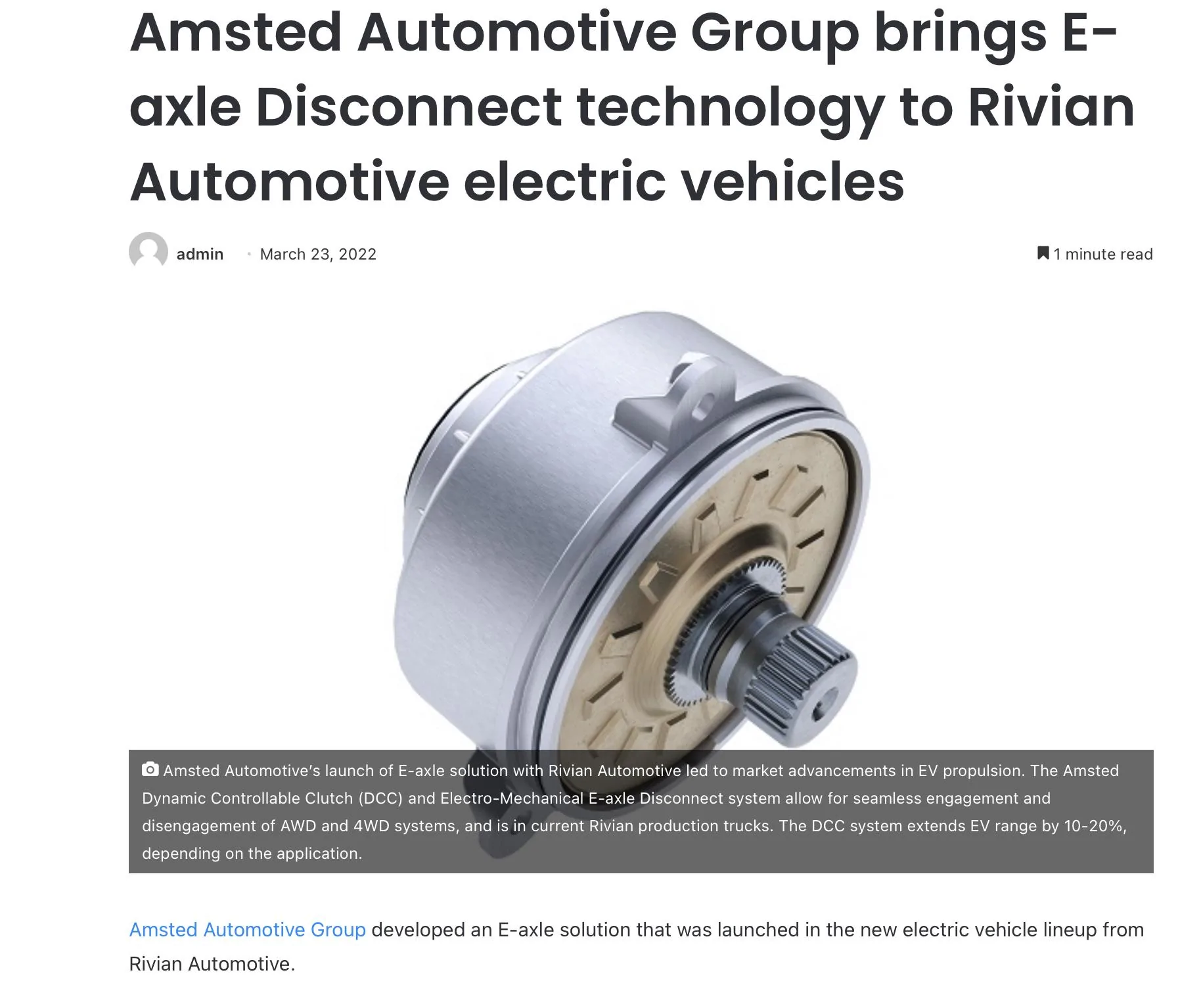

The latest info I found is that Amsted has supplied a drive shaft disconnect system that (at a minimum) is fitted onto the rear motors. It is passive requiring no power when it has connected or disconnect the wheels and only requires power to switch between the two states. It’s used to realize the ECO mode that disconnects the rear motors. It would great if Rivian also installed the hardware on the front motors and all we are waiting for is the software. Considering that they didn’t even tell us about this feature maybe the rest is cloaked, too.

Doesn't conserve mode place the Rivian in front wheel drive?
If Rivian figured out how to disengage the rear wheels to temporarily allow front wheel drive, why can the front wheels not also be disengaged in a similar fashion?
Are the front motors somehow different than the rear motors?
150
13,717
27,836
Engineering, Dog Petting
Front motors don't have the axle disconnect modules on them. It does look like the front and rear units both have the mounting points for them though, so it would be interesting to hear an industrious person manually adding them and setting up a way to use them to flat tow.
