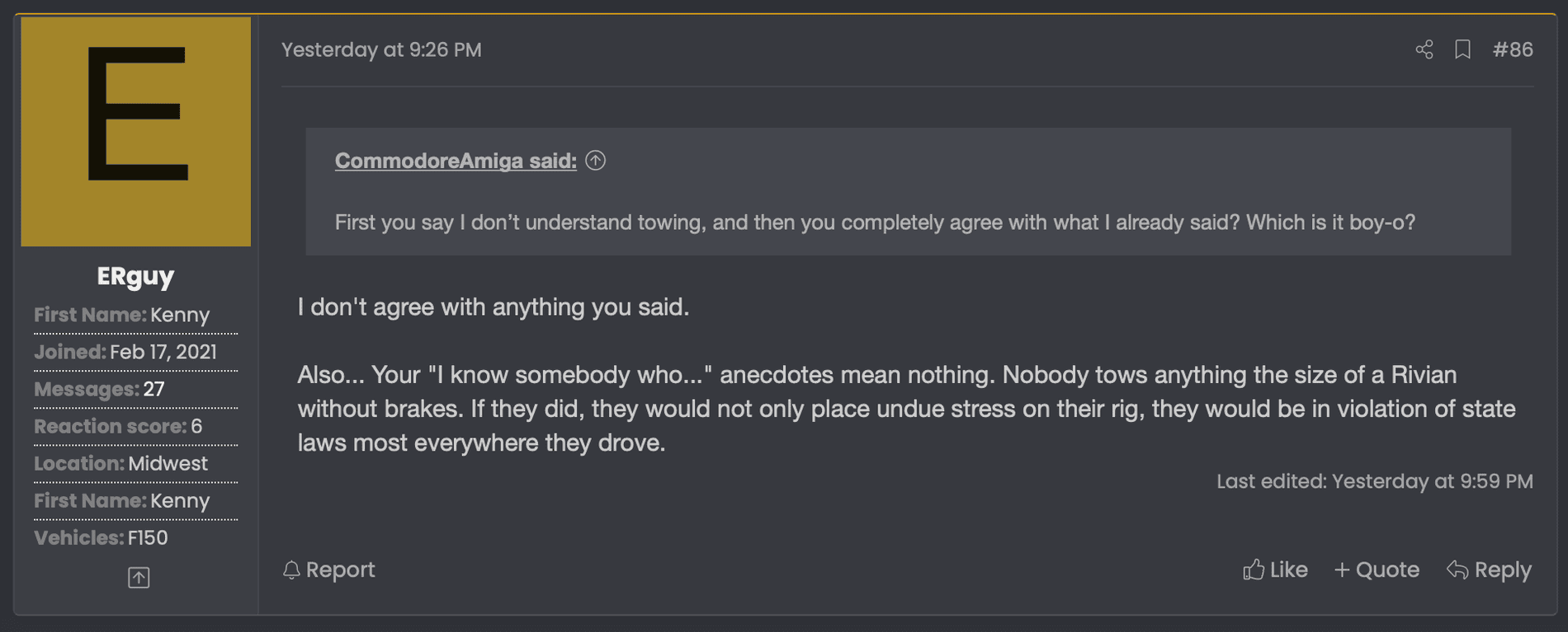

Wait... I'm confused. I responded to someone else's post, and you then responded to me saying
How did you get all bent out of shape saying something like that to me even though I had not even responded to you at that point?
I apologize if I mistook your reply for being directed towards me. You have quoted me and doubled-down, which reinforced my belief you were disagreeing with my position (screenshot below).
Rivian R1T R1S R1S flat towing behind an RV? yfko9t0
If that was a misunderstanding, then I apologize.

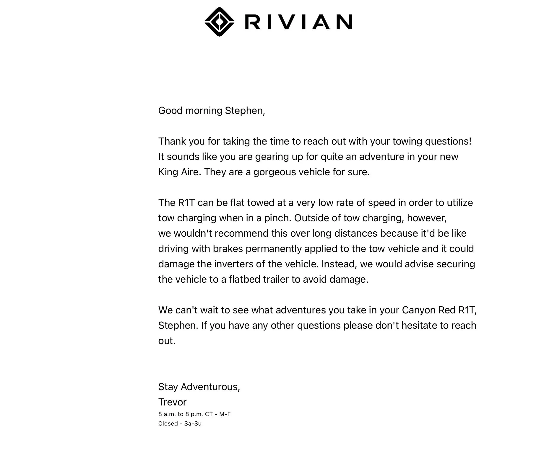

The official word, from RJ, unfortunately:
Rivian R1T R1S R1S flat towing behind an RV? EB1A5E4E-D6AC-4CD9-BCFE-AFD7D385D622

Just get a trailer? It doesn't seem like it would be that inconvenient or expensive to get a trailer for the R1T, also I expect it will save you money on tires. Admittedly, I have zero knowledge on the subject.
Trailers present other issues I don’t want to deal with! I’ve been RVing since 1970 and feel that I understand this a bit more. To some, a stacker or flat trailer works, especially when you find a place to park the trailer when one’s traveling. One nite in a back in site can mean unloading the car, moving the trailer, and then backing the RV in. Do the reverse in the morning. Obviously without the trailer, I still need to unhook the R1T to back in but usually I can easily park it in the front as well as most likely using it for sightseeing, etc. After many years using many Class A RVs and many different TOADs for my definitive of a venture lifestyle, I don’t see the need to change. I was interested in the Rivian because RJ said it would flat tow.

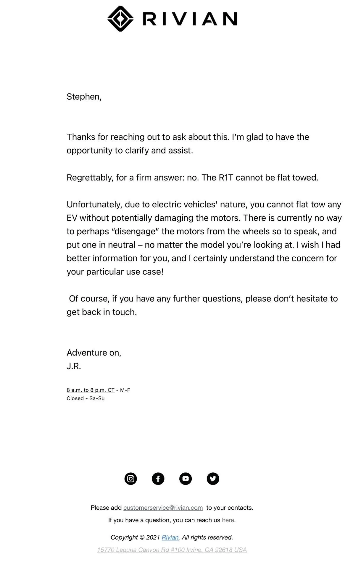

J. R. is a member of the CS team. RJ is the founder and CEO. Not the same person...

Thanks for posting. Not the answer many were looking for but it is nice to finally see a definitive answer coming out of CS.
CS has been confirming no flat tow for months. It's just that some folks on the forum refuse to believe it. I'm assuming this latest confirmation doesn't change anything for those people.
