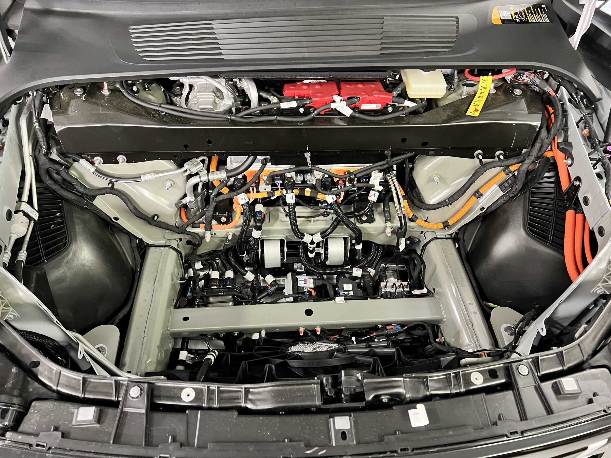

Agreed with all of your points besides your statement about no radiator being present behind the bumper. There is an AC condenser, which is essentially a radiator, and an actual radiator for the battery coolant loop in that front stack as well.
Puller fan behind the cooling stack in pic below with frunk liner removed:
Rivian R1T R1S R1S / R1T aftermarket bumpers img_1083-
Will it require additional protection when off-roading? No. But it's there.
The heat exchanger(s?) are angled and pretty far back. Which is what I meant by “there is no radiator in that location“. Potato, potato. 😬
