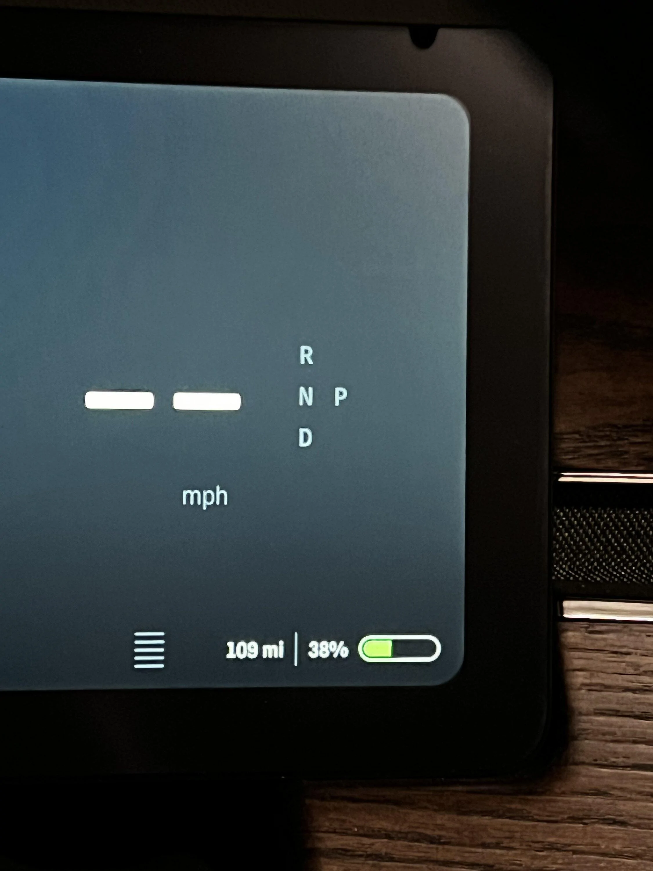

Updated this morning when I got home from work. Woke up @2pm and opened the truck to put sunshade in the windshield, it had ~38% battery post update. My fob still wouldn’t update, so I submitted a ticket for that and received a call maybe an hour later to take care of it as well as the passenger seatbelt recall. Washed the truck to use it tomorrow before dinner and noticed the radiator shutters were cycling randomly?

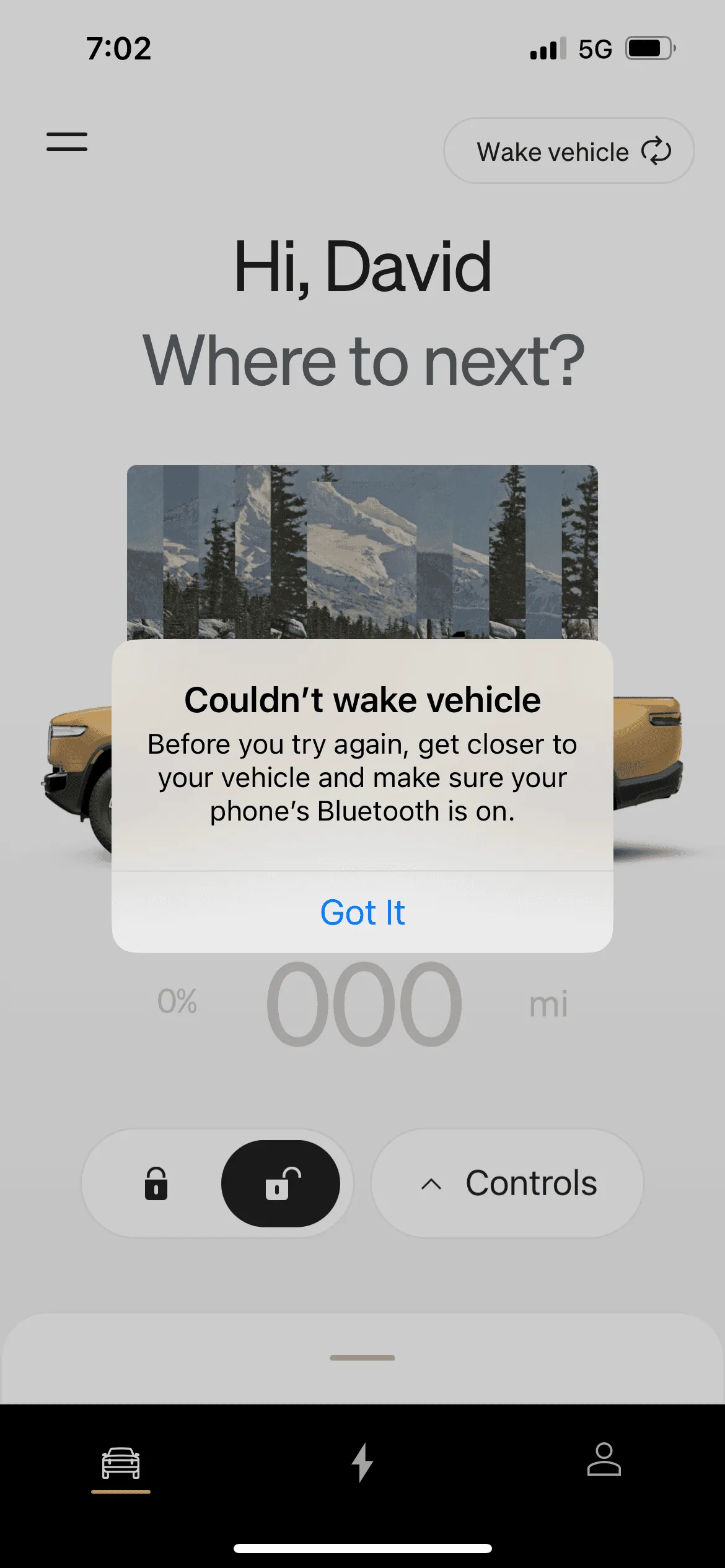

After dinner I went out to plug the truck in to charge overnight and it wouldn’t unlock with the app. Key cards and fob also wouldn’t get truck to respond. Called roadside who answered and understood the issue then would call me back with a solution.

App still won’t lock/unlock and shows 97F inside (which it was earlier today)

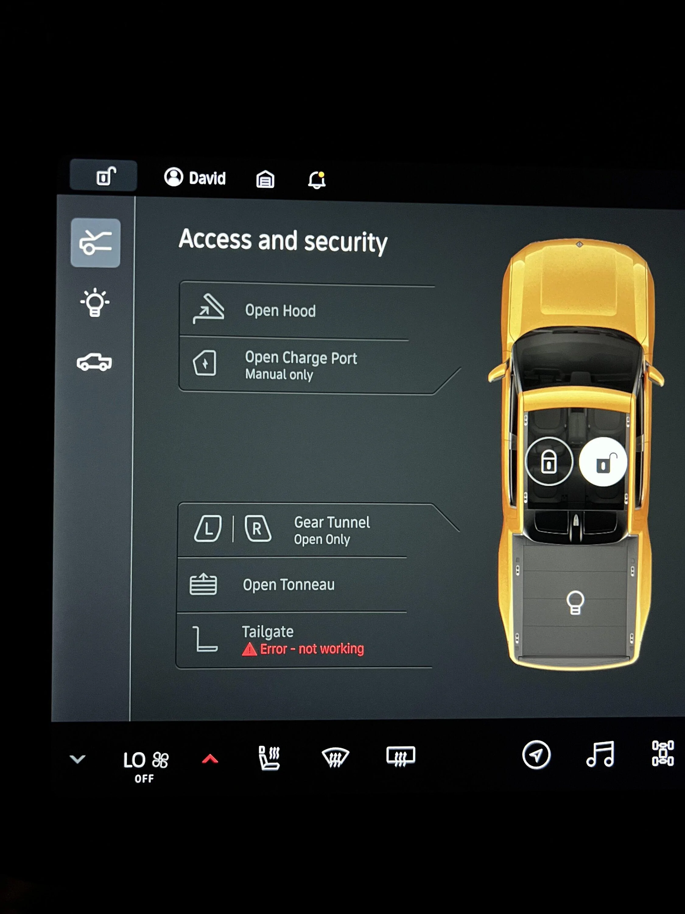

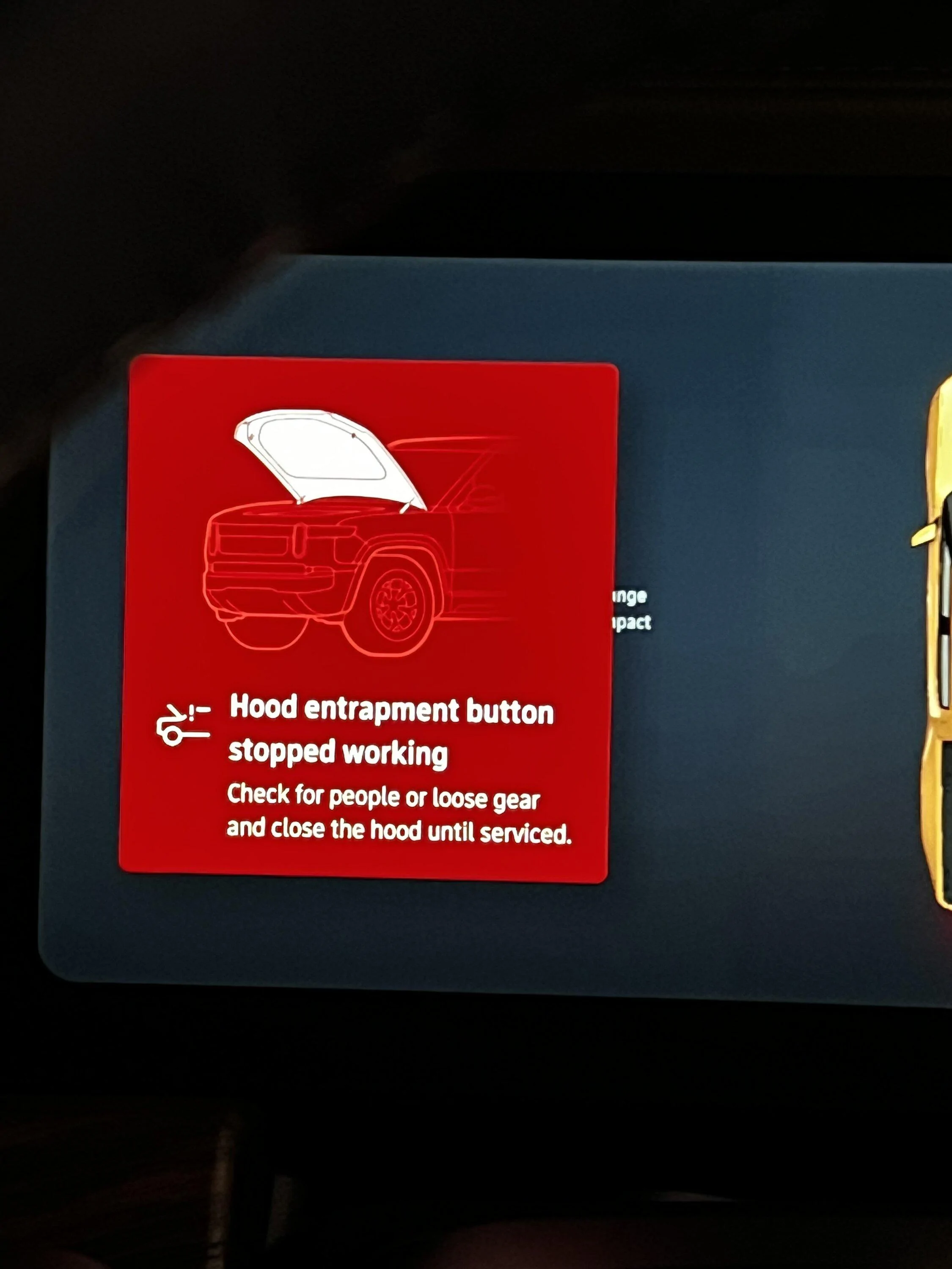

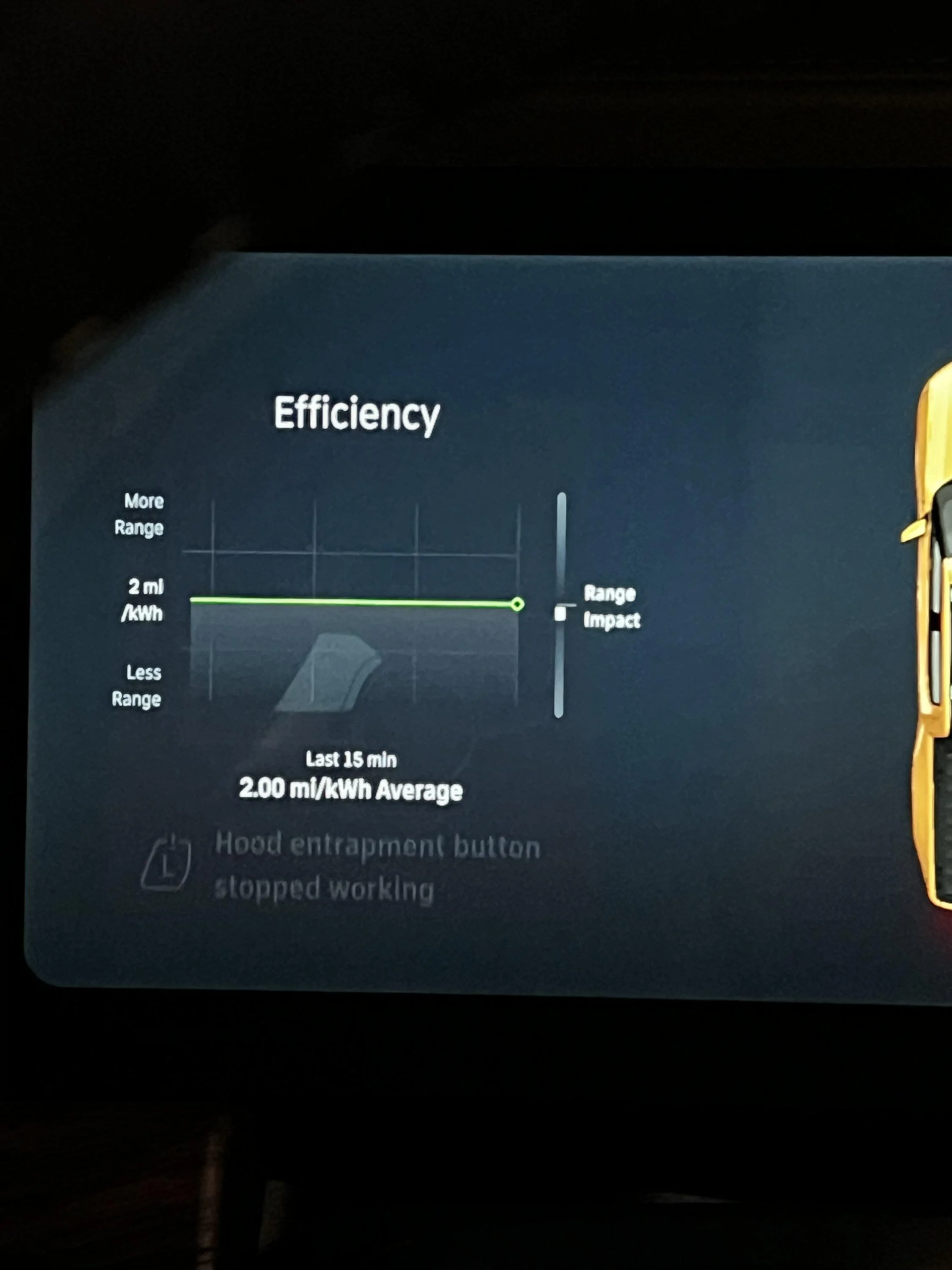

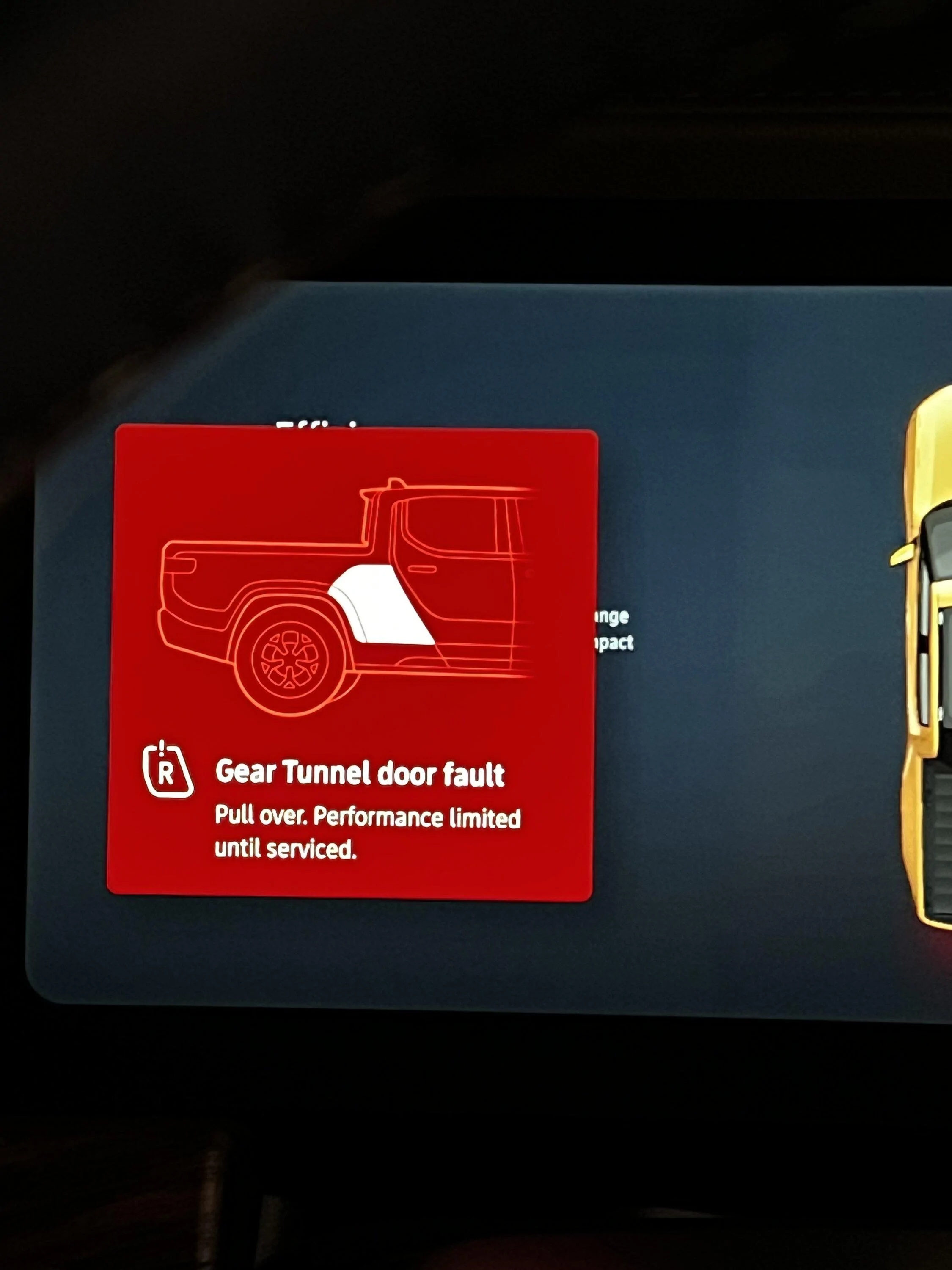

Add me to the list. I have a 11xxx R1T. Monday night the car would not go into drive or reverse. After a half hour the lights all flickered and then the truck fully died. Luckily we were able to get in before it all went down, but the gear tunnel was inaccessible.
