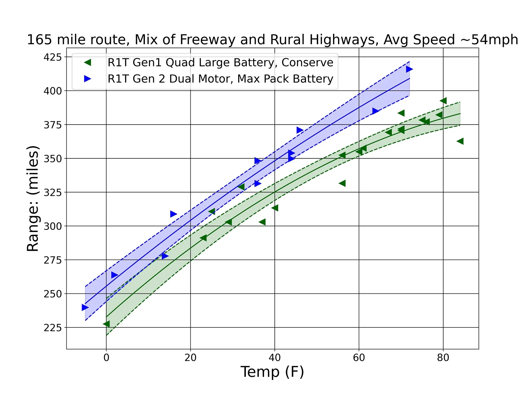

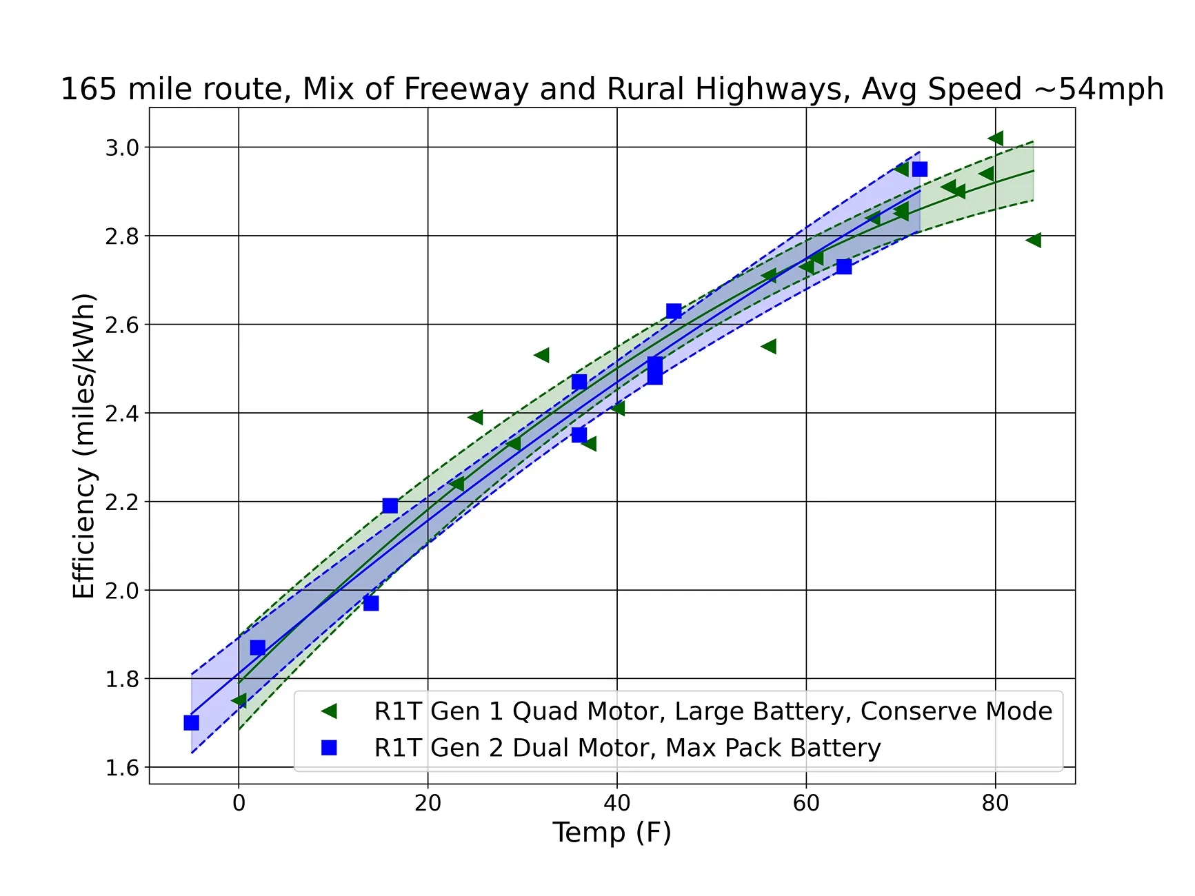

The charts empirically measure the efficiency of two different vehicles under highly similar conditions. It doesn't isolate the impact of the heat pump, but you'd think if the heat pump made much difference to cold-weather efficiency then you'd see a bigger difference on the left side of the chart. Maybe the temperatures don't go low enough.
Jeremy's post doesn't make much sense to me because for one thing half the variables he listed actually ARE controlled for in Budman's test. For another thing we know the Gen 2 is supposed to be more efficient in every dimension. So if the data showed Gen 2 is more efficient, we wouldn't know if it was because of the heat pump or not. But since the data shows Gen 2 is not significantly more efficient than Gen 1 conserve, we can draw a conclusion that the heat pump can't make much of a difference in the kind of environment he's testing in.

You are leaving out some facts that matter in this discussion and provide support for @Budman ’s data. As the temperature of the outside air drops the COP drops as well. It’s disingenuous to claim 300%-600% efficiency compared to resistive and not mention these facts. The spec COP of any heat pump system is at a specific test temperature, usually around 47F in the US and up to 60F in the EU. At 30F the COP can be around 2, and it will hit equilibrium with a COP of 1.0 somewhere around 0F, give or take. At that point the heat pump system is equal to a resistance heater, assuming the electrical heat energy is efficiently transferred to the coolant loop, which would be expected with a hermetically sealed compressor.
In real world operating conditions, especially in the OP’s homeland of Minnesota, the heat pump will translate to around 5% range increase compared to a resistance heater. This has been well proven by numerous owner tests. At temperatures around freezing and below, lossy operation of the motors starts to kick in to provide the necessary heat for cabin and battery warming.

A heat pump might not be that big of deal. Gen 1 R1T did not have it, Gen 2 does. I’ve had both and have kept VERY careful track of my efficiency while driving around MN and WI. I have found little evidence of a benefit.
Heat pumps matter more for daily use vs extended trips.
