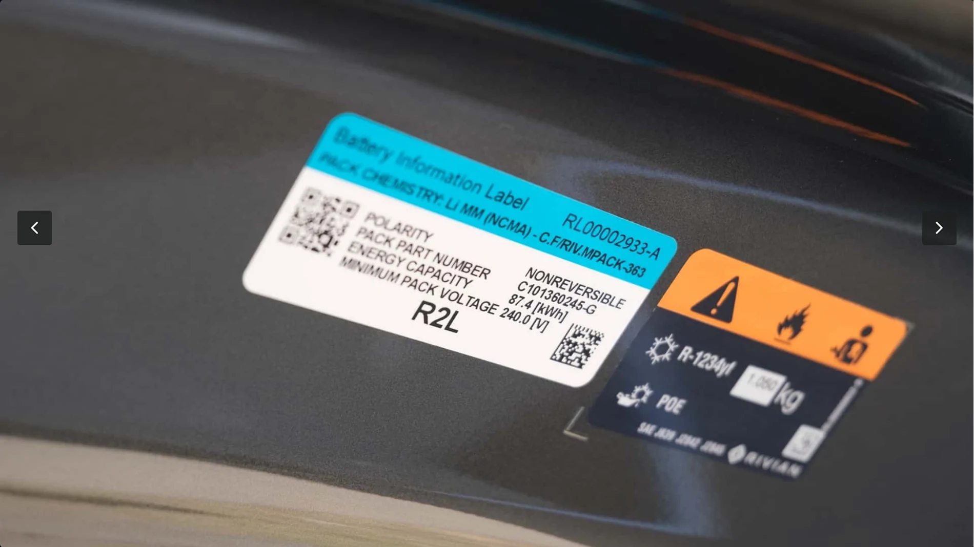

Where is this battery “sticker” that everyone is talking about?
It has been mentioned in a couple tweets. Apparently Kyle from Out of Spec was texted a picture of it. It was a battery information label...87.4 kwh capacity and minimum pack voltage 240v.

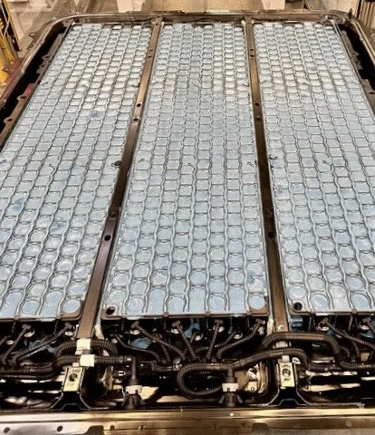

87.4 seems small to me for a large pack. Either R2 is more efficient than most people expect or this is the standard battery. It seems a little big for a standard battery as well. So that makes me think of another option. Maybe there is 3 battery pack options. I remembered when I seen the pick of the 3 compartments in the battery that there may be 3 options.
I saw this analysis on X.
768 cells of which I'm assuming are LG 4695 which are 3.6V at 34AmpH
-Based on the disclosed charging performance, we are still at a ~400V architecture.
-We need around 120 cells to hit the ~400v nominal, but given 768 is the total number, I'm using 128 Cells per Module which gives a total of ~460V MAX voltage (seems OK)
-That will give us 6 modules of 460V at 34Ah each, for a total of 204 AmpHours.
Hence, 460v * 204Ah = 93840wH or 93.8kWh
So yeah, 87.4kWh looks to be the USABLE capacity out of 93.8kWh
Just Passing By
Jan 18, 2025
241
330
Bay Area
(Ancient Audi A6 gone) - 2 wheels-only for now Honda CB500X
Something to consider. The vehicles used for this media launch might just have been equipped with the small battery. Rivian deliberately didn't provide specific battery capacity, charging or range numbers, or at least required them to be kept under embargo, if they briefed the media on them at all.
If embargoed, then would InsideEVs still go ahead and post a picture of embargoed information? Seems unlikely. It also seems unnecessary for Rivian to provide this data so far ahead of the main March 12 launch date, knowing how such information tends to leak.
So then why would Rivian go ahead and hold back battery capacity, charging and range numbers, but still go ahead and paste a very obvious sticker with battery capacity information? They would also have to presume that someone like Matt could just go to a Tesla fast charger to get additional data? It seems an unlikely oversight by Rivian when they know the R2 will be under such scrutiny.
Thanks, this makes sense. And it makes sense for the 110-115 mile range estimates for this performance duel motor with AT tires. I hope they make a Lower HP long range model. I can see a 450 HP duel motor R2 with 350 miles range. That would be the model I would want to buy.

I really hope 87 kWh isn’t the largest battery size. That just won’t cut it for highway range. The Mach E large pack is 91 kWh.
Why are we still speculating about this (and still getting the details wrong, e.g it's THREE modules not 6 ...)?
We've known the right numbers for a year now, directly from RJ's keyboard.
https://www.rivianforums.com/forum/threads/r2-r3-battery-pack-photos-from-rj.42860/
Why do people think that "secret" information in ABRP (which has been there for two years) has more credibility than official information straight from Rivian?
