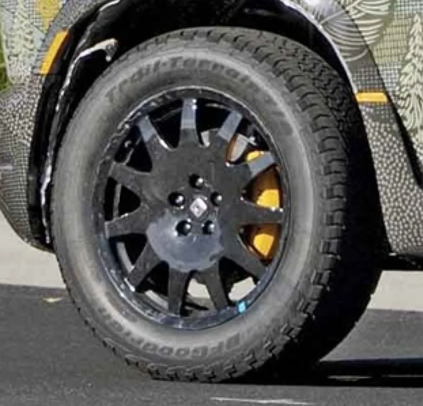

I was wondering today about what the tire/wheel size is on the R2 validation builds. I wasn't able to find anything definitive that has been posted. Using the photos posted and some math it looks like the R2 validation builds are running on different rubber size than the R2 prototype:
255/55R20
Here is the info and math using measurements taken from the recent photos of the validation build pulling out of the Rivian facility.
The tires:
Rivian R1T R1S R2 Tire Size = 275/50R21 1755902304940-uh
These are BFG Trail-Terrain T/As not the Pirelli tires seen on the original prototype from 2024.
I downloaded the full photo and pulled measurements using photoshop.
The measured wheel base on the photo is 8.15625" which is a 14.17318008 ratio with the 115.6 published wheelbase.
The rims diameter measured 1.40625" (averaged between the front and back because the R2 validation build photo was at a slight angle) and with the 14.173 ratio is 19.93103448" or 20."
The wheel diameter measured 2.1875" average and with the 14.173 ratio is 31.00383142 or 31."
Comparing those dimensions to the BFG Trail Terrain specs points to 255/55R20. It makes sense as this an XL load range tire and the R2 is expected to be in the 5000-6000 pound range.
255/55R20
The tires:
