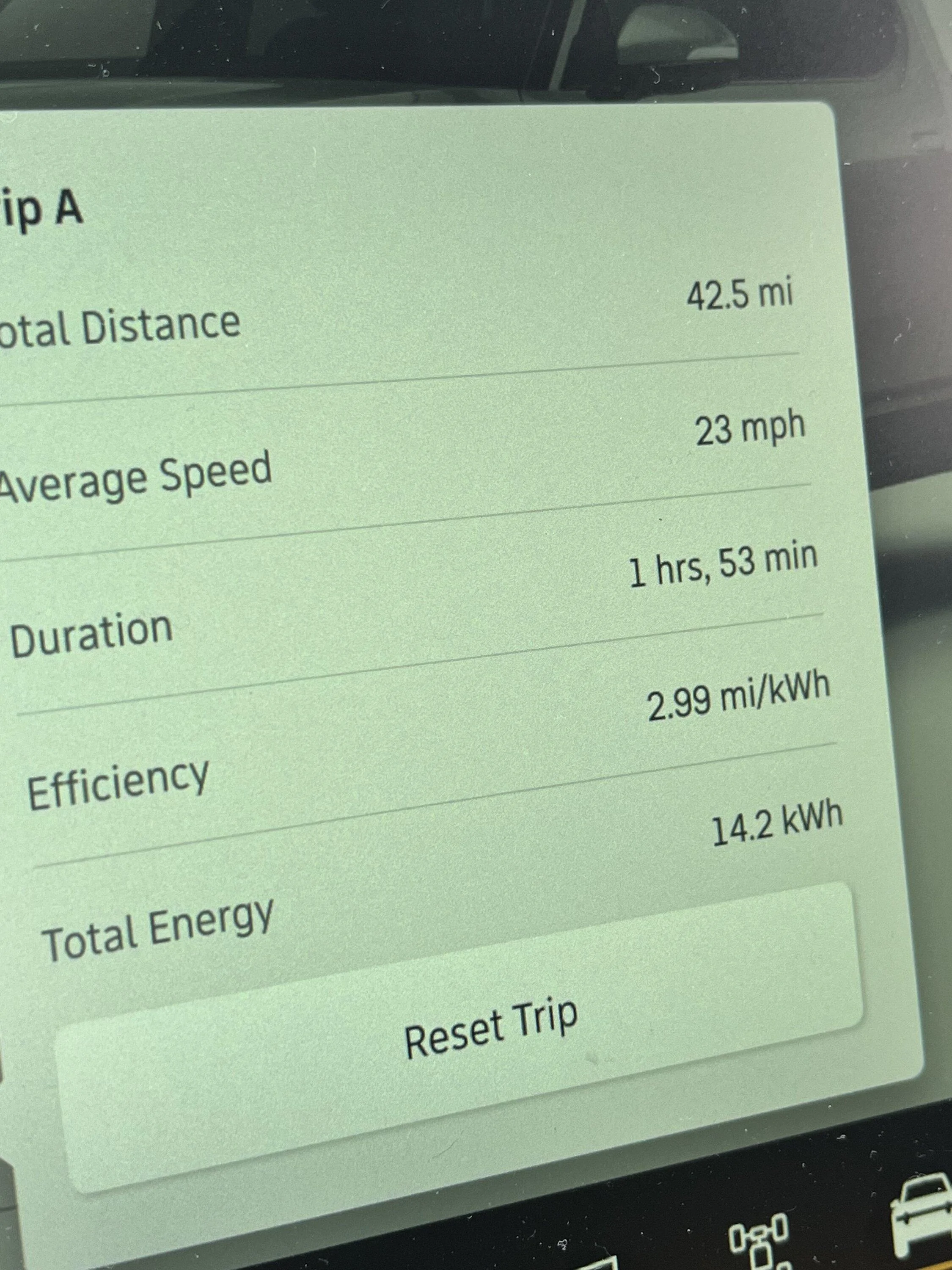

3pm. 48 degrees. No traffic. No hills. Sucks.
Rivian R1T R1S Range and efficiency on 21s WITHOUT Aero Covers???. 3527A7DB-F778-4F04-ACFF-040E6C9A07A5

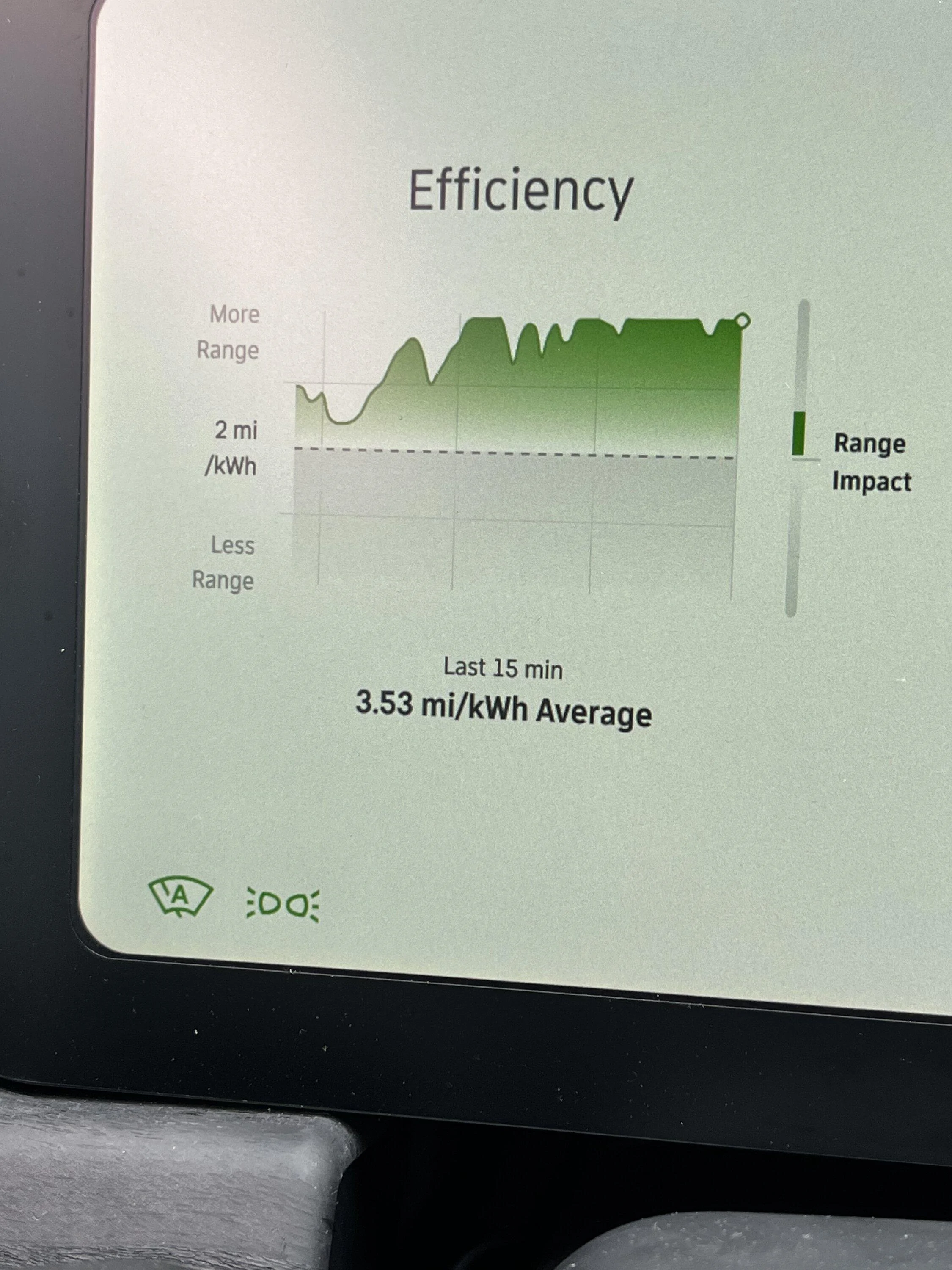

same weather and driving but 10am instead
Rivian R1T R1S Range and efficiency on 21s WITHOUT Aero Covers???. 45B2A4F6-9DAC-48C0-B882-F183136C4FF9
so confused.
hovering around 2.03 mi/kWh on daily trip meter and lifetime trip meter. I try to drive with a soft foot, which is so dull!

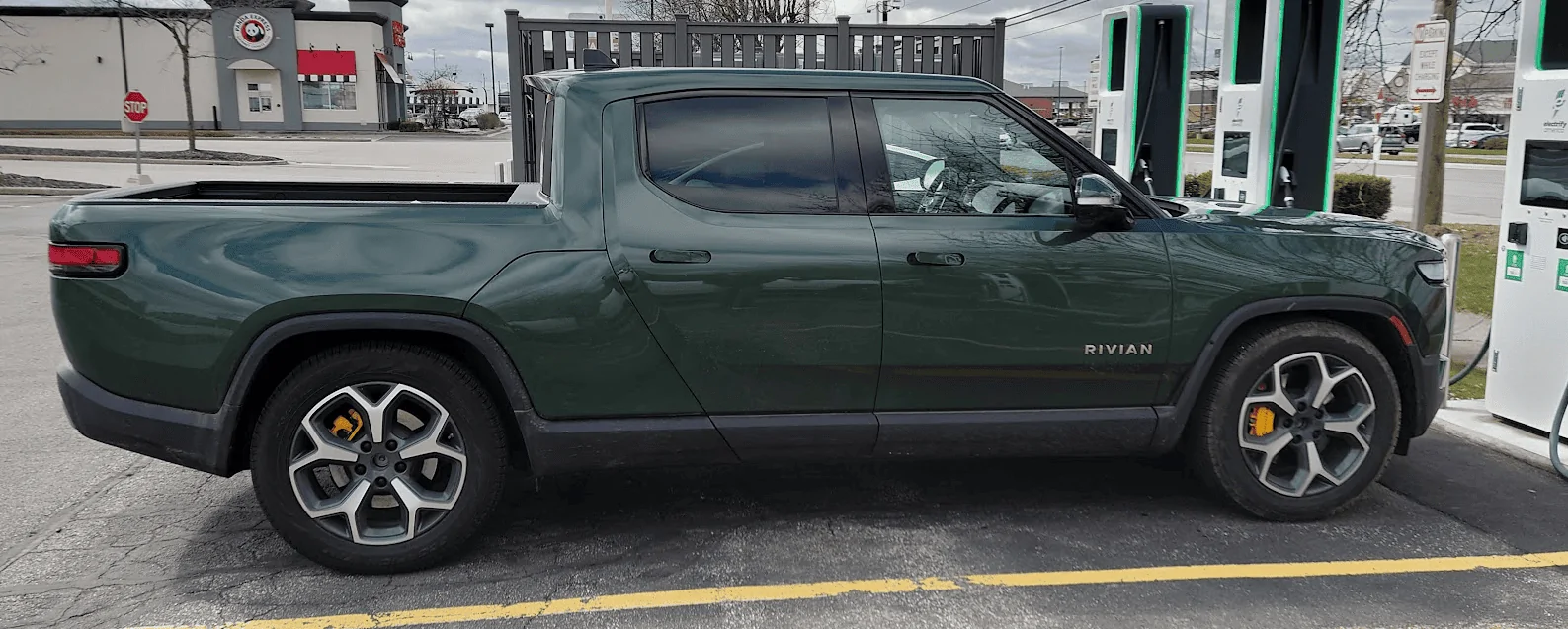

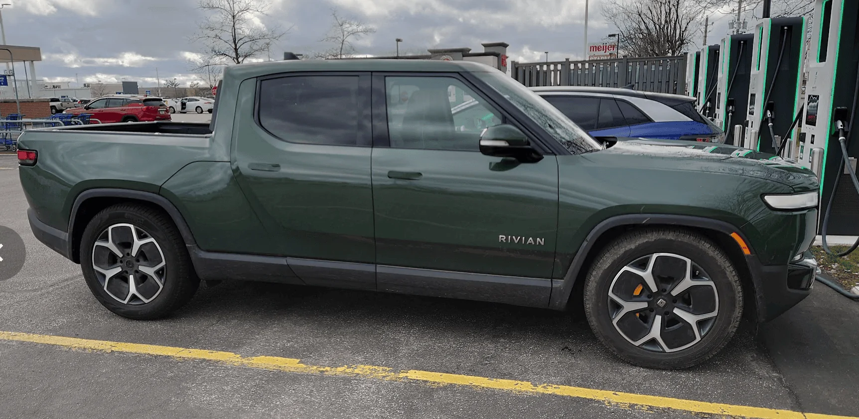

Ok, so I did a somewhat scientific test today. I should have gone one more lap, but it was getting late in the day.
Weather was not ideal - windy/gusty with a few light showers (only on the first cycle). Traffic was mostly not a factor.
Method:
Arrive to EA, charge to 70% (let truck end charging)
Drive in conserve to 70mph for ~16 mile trip
Dogbone highway exchange, drive ~16 miles back to EA station
Record data and charge to 70%
Repeat

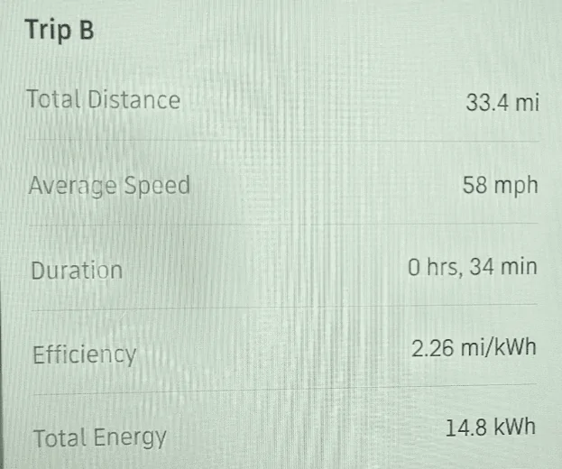

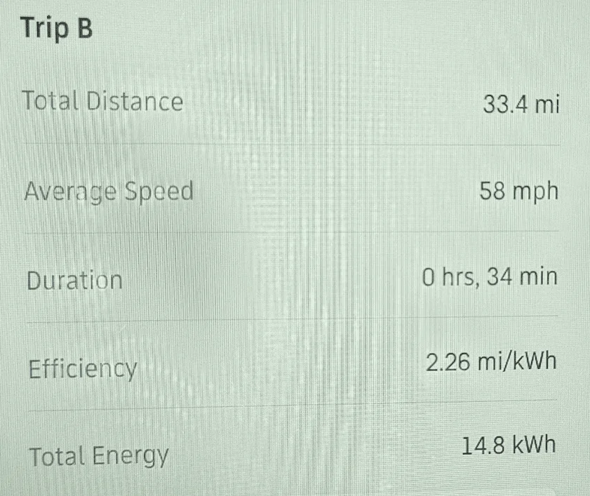

Cycle 1: No covers

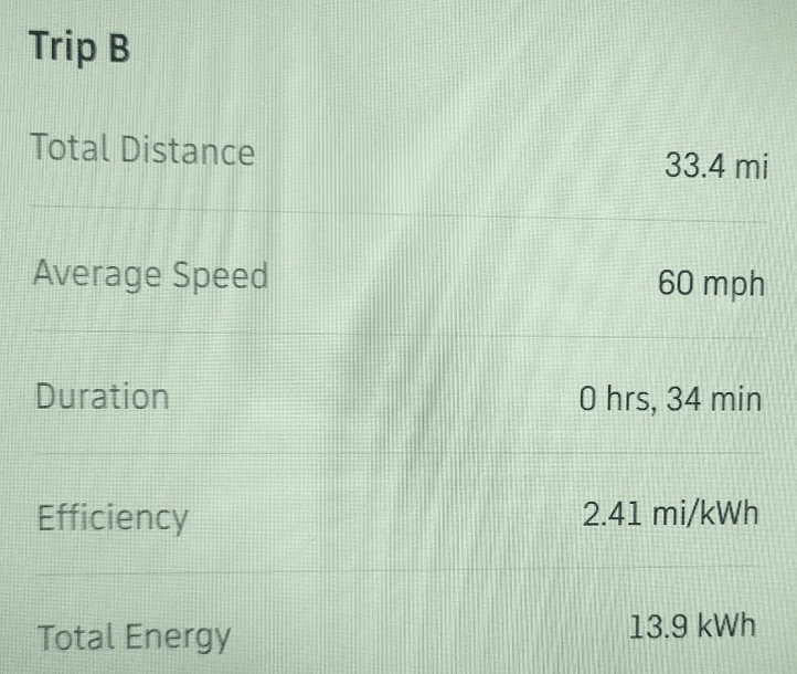

Cycle 2: Covers
Cycle 3: No covers
1 (No covers)

2 (Covers)
Rivian R1T R1S Range and efficiency on 21s WITHOUT Aero Covers???. 1679795676953

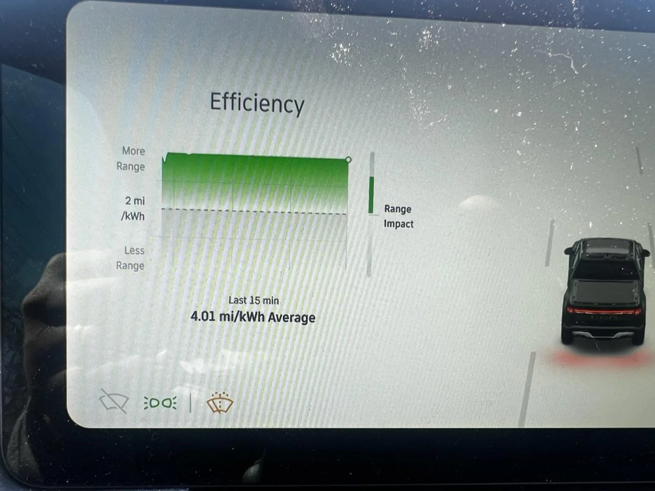

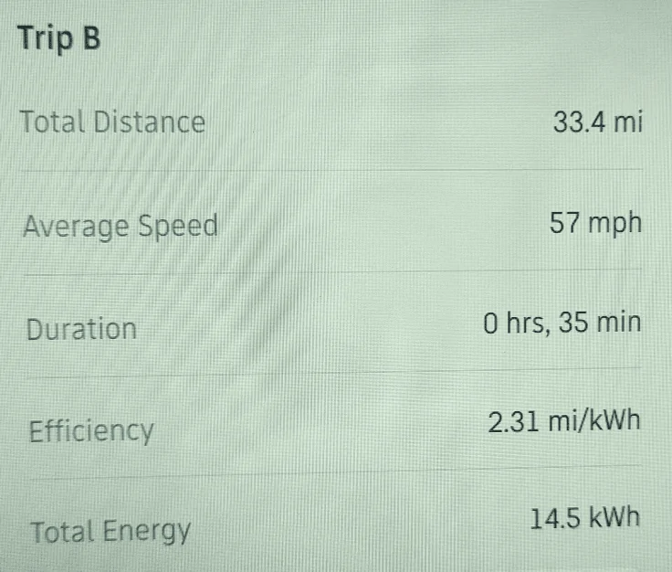

3 (No covers)
Rivian R1T R1S Range and efficiency on 21s WITHOUT Aero Covers???. 1679795702408
Rivian R1T R1S Range and efficiency on 21s WITHOUT Aero Covers???. 1679795864135
I also captured video of the drive and grabbed the truck measured consumption at the turnaround point ("first 15") and at the highway exit ("second 15").
I also grabbed the amount of energy EA delivered to the truck ("Added kWh")
CycleWheelsTrip mi/kWhAdded kWhFirst 15 mi/kWhSecond15 mi/kWhAvg of 15min
1Blank2.2616.6532.152.182.165
2Aero2.4115.8512.442.342.39
3Blank2.3115.6672.482.232.355
Aero Vs Best104.33%101.17%98.39%104.93%101.49%
Aero Vs Avg105.47%98.09%105.40%106.12%105.75%
So, what's the takeaway?
It's somewhat in the noise, but it looks like the gain is no more than 5%, probably about 3-4%. That's more than I expected... and seems to be similar to the difference between 21" and 22" wheels. Knowing all this, I wish I would have opted for 20's and gotten highway tires or 22's like I had originally planned.

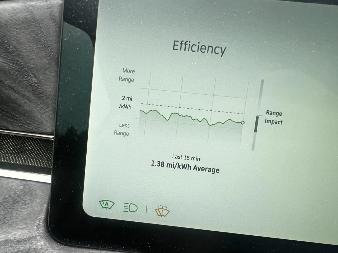

I’ve experienced hovering right around 2kwh/mi for awhile as it’s been colder temps average and more interstate/hwy driving with heavy wind. However, this week we finally got up into the 70’s here and man I’ve seen a big jump…
Rivian R1T R1S Range and efficiency on 21s WITHOUT Aero Covers???. 0BA861D1-E001-4692-81A9-B9F20077B17F
Rivian R1T R1S Range and efficiency on 21s WITHOUT Aero Covers???. EC0F4DE7-9DF8-461E-A1BC-41CFE7977132
