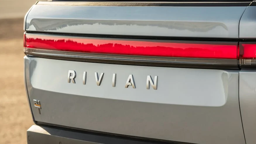

Someone needs to offer a mod to illuminate the LED light bar in the tailgate when the brakes are applied. The current brake lights are WAY to small to be seen when driving in fog, sleet, etc. I drove behind an R1T over the weekend and was rather shocked as to how small the brake lights actually are.

No truck, at least in the US, can use lights on the tailgate as brake lights. This is actually a safety regulation since the tailgate is moveable and the truck can be operated with the tailgate down. They don't want auto manufactures to rely on brake lights that may or may not always be visible while operating the vehicle. Im not arguing that this is the right or wrong approach, but this is the reason why the lights on the tailgate dont function as brake lights.
To clarify, you can’t have your ONLY set of brake lights on a moveable body panel, but you absolutely can have brake lights on a movable body panel. Several vehicles do this by having supplemental lights that work when the body panel is moved (like the Audi Q5 which has its brake lights on the hatch).

I know the cyberchonk doesn't exist yet but the latest prototype switched to a segmented tailgate light, with some of the segments used for braking. It looks awesome and seems like a much safer and more logical use of the real estate.

The idea of the entire light bar becoming a brake light is important. To put in aux lights for braking and using the trailer wiring is not enough. The truck will automatically want to put you into tow mode when you plug in. I have been considering LED strips to put on the back but I'm waiting, hoping Rivian will change the function of the existing light bar OTA.

Yeah not sure why it isn't a brake light, there are definitely cars with brake lights on trunks that move.

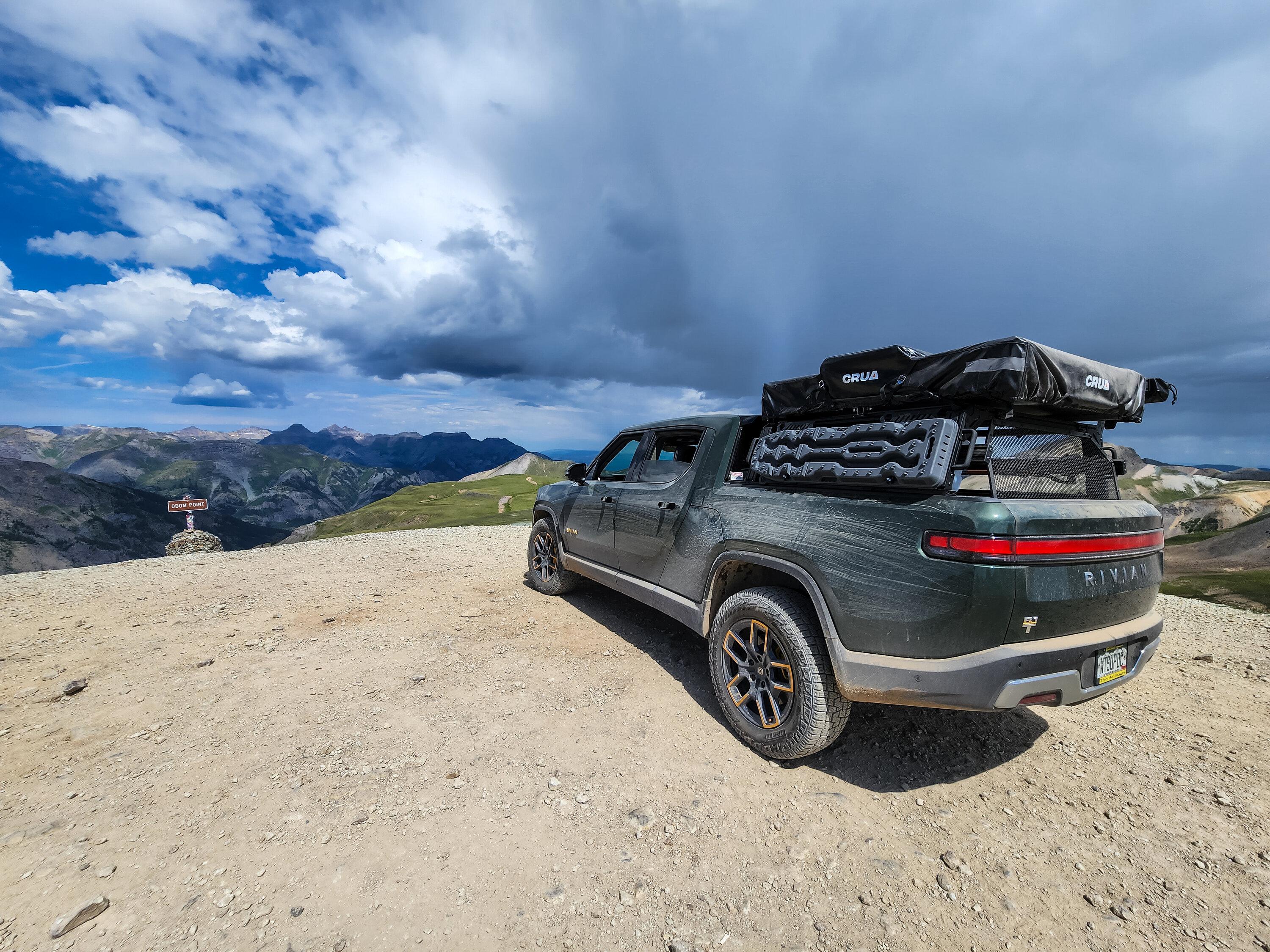

As an aside, the RTT mounted on my bed rack blocks the 3rd brake light. I tried wiring in an auxiliary light directly to the passenger rear light assembly, but it was a fail. It's not an analog signal, but rather digital. I since found out it's not even simple digital, but a modified version of CANBUS (thanks Robert). LIttle hope of adding an aux
Rivian R1T R1S Rear brake light bar? 20220805_182421
light until someone decodes the digital logic.
