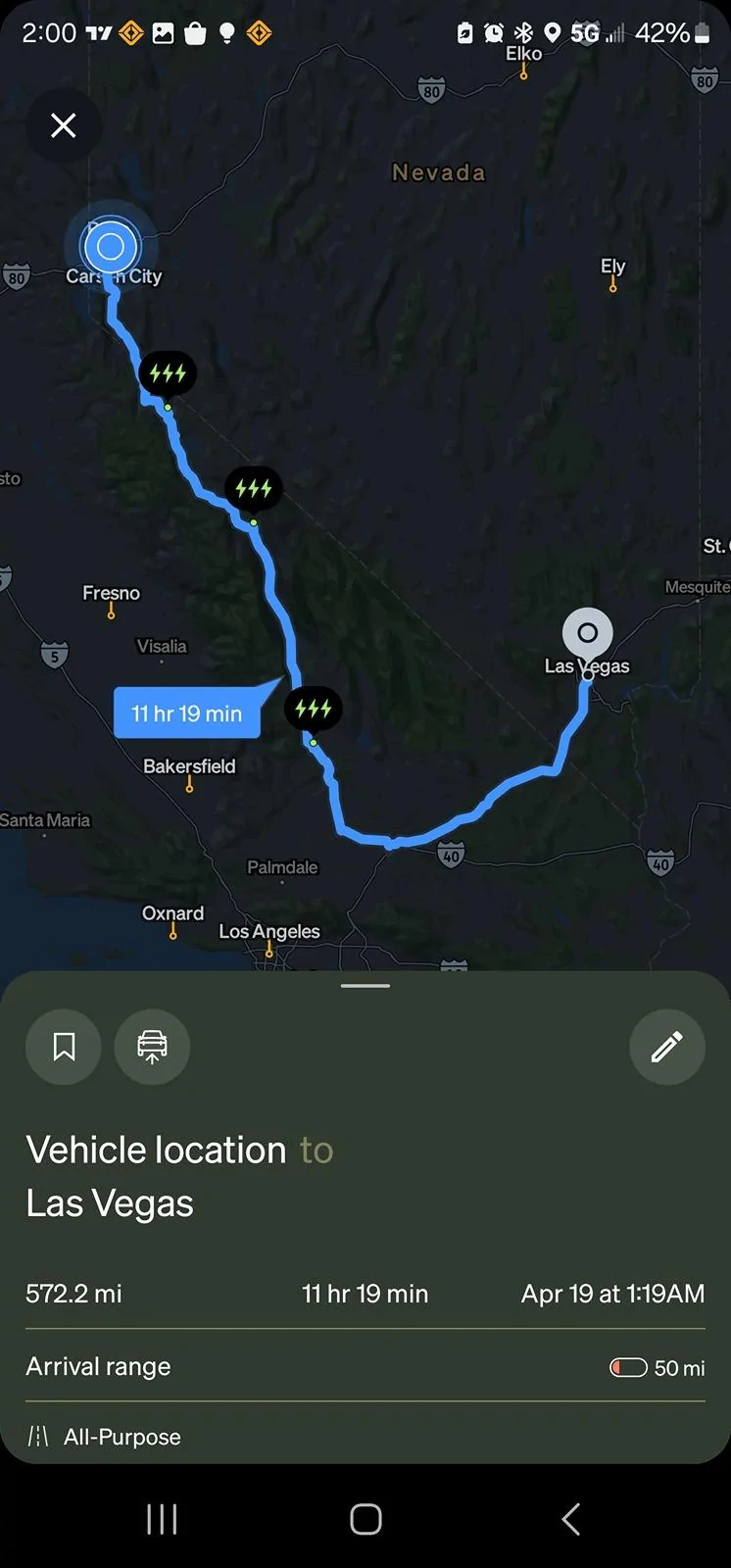

I think part of the challenge here is that route planning in the app is suboptimal. I'll agree with OP that I wouldn't drive the route suggested.
I have a similar issue with a trip I'm planning to SE Utah this summer. Just to give a few examples, ABRP and the app are proposing two different routes. ABRP has the trip taking 19hrs, 29 minutes and the app has 27hrs, 15 minutes. I'm too lazy to convert the ABRP percentages into Rivian app miles, but it looks like there's a significant difference in efficiency assumptions.
OP: Go with the ABRP plan.

I did not point out Rivian's shortcomings, that was someone else saying that they don't use the route planner in the app. Someone offered a solution that isn't viable because one of the chargers along the proposed route is non-functional. That is not a Rivian shortcoming, either (chargepoint). BTW, I also pointed out that the infrastructure in nv sucks which is really my only problem. Vegas to Tucson is a piece of cake. This is my issue:

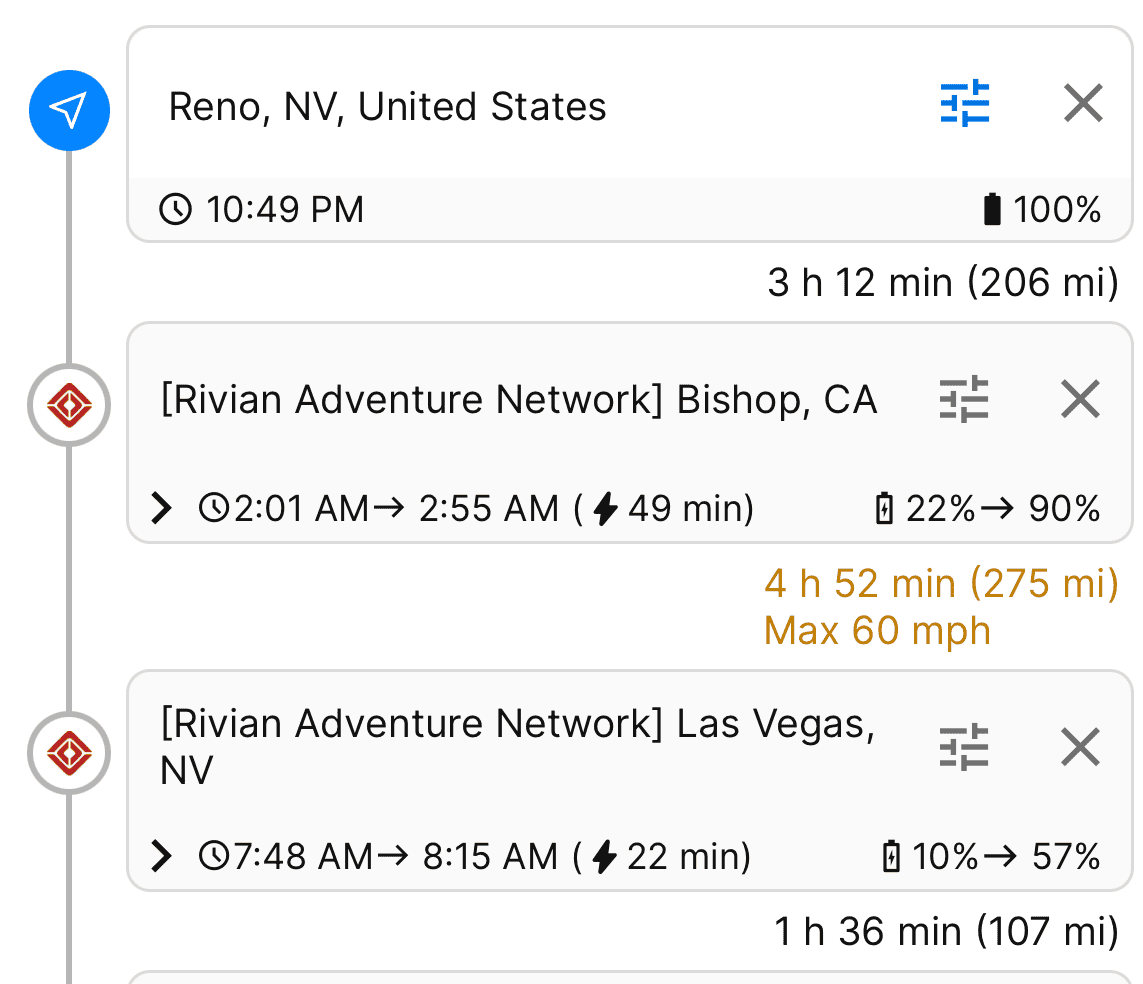

Take 395 to Bishop, charge to 100%, then head to Vegas. It’s about 260 miles to the next charger but you should be able to make it just fine in conserve if you keep a light foot.

This is precisely what I needed to hear. Thank you!

My ABRP, which has been decently accurate so far, says to do this:
Rivian R1T R1S Reno to Tucson... Can't get there from here. 1713505867385-ox
I have my speed set to 110% of speed limit but it has the option to recommend going slower. This is the plan the previous poster wrote. Looks like going slow will get you to Vegas.
