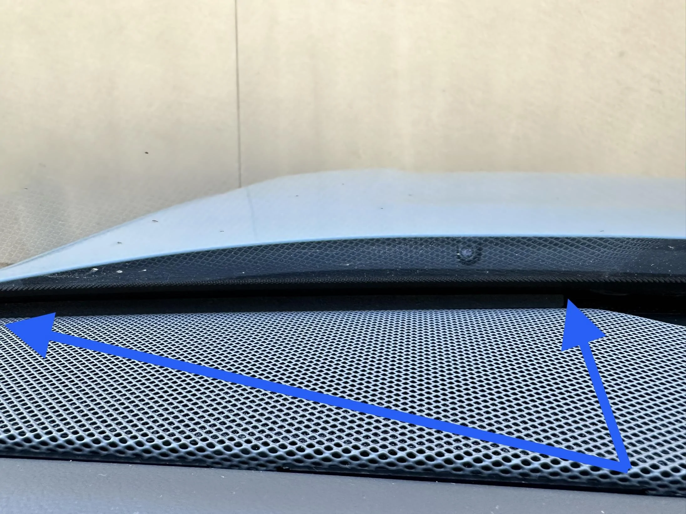

I did this quick DIY project to significantly reduce the rattling from the dash mesh at the top. The rattling isn’t 100% gone, but it’s been reduced enough that I can wait for my service appt to see if they can do a better job.
I bought this window foam seal. https://www.homedepot.com/p/M-D-Bui...ndow-Seal-for-Large-Wide-Gaps-06635/100353487
I cut about a 1ft long strip. Then I wedged it into the gap between the mesh grill and the front windshield. See picture. Repeat other side.
You can use something plastic (eg from an auto panel kit) or even a wooden chopstick to wedge the foam into the gap. If you screw up, use needle nose pliers to gently bring the foam out.
(You can keep or remove the tape on the foam bottom… doesn’t really matter here)
I noticed this foam insert reduced/removed the amount of vibration that happens here, (where there seems to be some plastic on plastic contact).
It should be pretty simple project. Let me know if you have any questions or how it goes!
