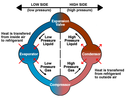

I don’t hear a hiss in my R1 but I have heard this in my other cars. It is probably normal. When the compressor shuts off, pressure in the system needs to equalize. Compressed refrigerant will return to vapor state as the pressure drops until the system pressure equalizes on both sides of the compressor.
Regarding the compressor discharge line (what you refer to as the exhaust valve) , the purpose of an AC compressor is to move heat. The compressor discharge contains high heat refrigerant vapor - the heat that was removed from your cabin. It should be hot, and can be too hot to touch. That’s normal. That hot refrigerant goes to the condenser which blows air through it to remove that heat - just like the outdoor unit on your home. If this line and compressor was not hot, your AC is not working.
