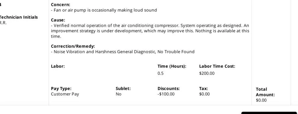

One more DFW area ... high 5000 Vin # Took to Dallas service center on paper they say "No trouble found" but service advisor acknowledged that they are aware of problem and looking in to this
Rivian R1T R1S Rivian executive acknowledges R1S AC noise problem WhatsApp Image 2023-06-26 at 12.04.54 PM

52. Nkp907: "One more DFW area ... high 5000 Vin # Took to Dallas service center on paper they say "No trouble found" but service advisor acknowledged that they are aware of problem and looking in to this."
