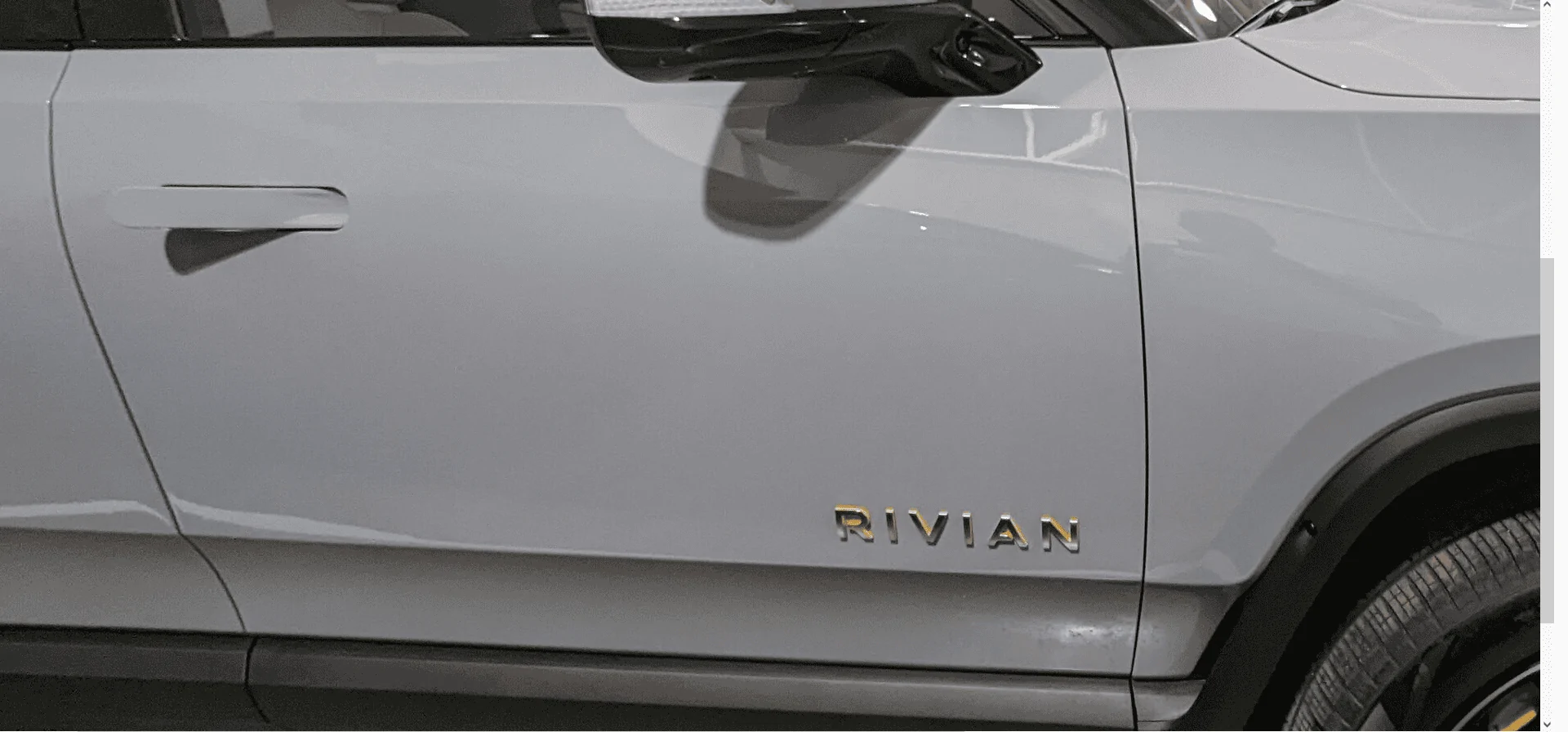

In my quick inspection, I found fit and finish pretty good. I am attaching some photos for everyone to review.
Rivian R1T R1S Rivian executive acknowledges R1S AC noise problem 1687530651365
If you do bring it it to the SC after the Q2 rush.. ask them to lower the door a few MM as it's clearly mounted too high compared to the front fender trailing edge and the rear door leading edge.

This is not what I have experienced. The noise does not stop once my cabin cools down after 10 minutes. I've reported this to Rivian several times...interesting they are telling customers the opposite.
Ohh great thanks, I looked at the photos multiple times and didn't notice once. Surprisingly it aligns perfectly with rear door in the bottom atleast and top seems confusing in photo. Instead, do you think fender can be upped a little bit to match to the door?

Oh great thanks, I looked at the photos multiple times and didn't notice once. Surprisingly it aligns perfectly with rear door in the bottom at least and top seems confusing in photo. Instead, do you think fender can be upped a little bit to match to the door?
That's one of those things they will have to determine at the SC because if you move the fender down.. then the hood won't line up, etc... it becomes a big can of worms. They have plenty of experience aligning doors, etc.. at this point in time. I'm confident that once they are made aware of the issue they will 100% resolve it to your satisfaction.
Sure, makes sense. I am a novice on this topic so definitely leave it upto SC to fix it the right way they think.
