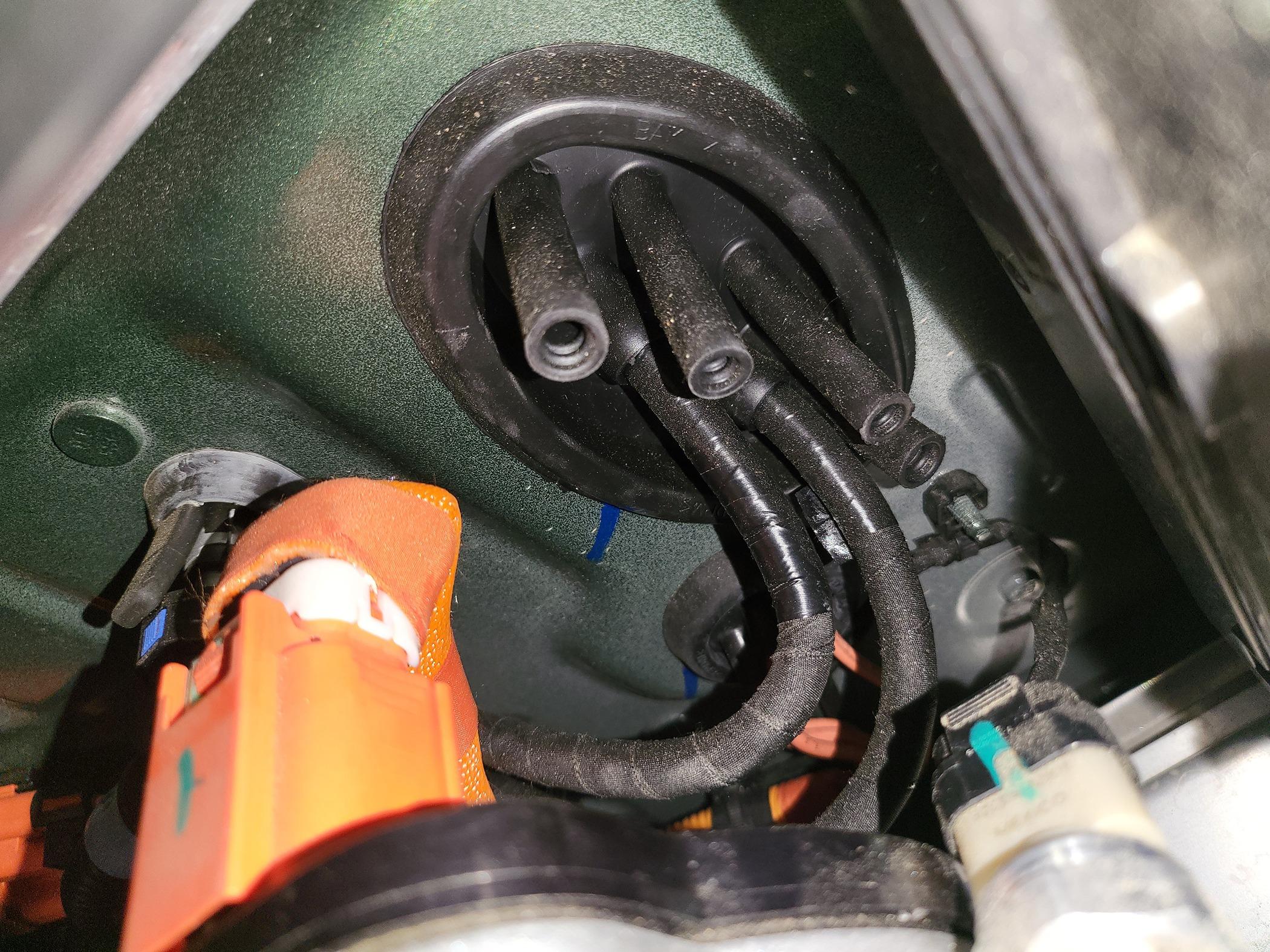

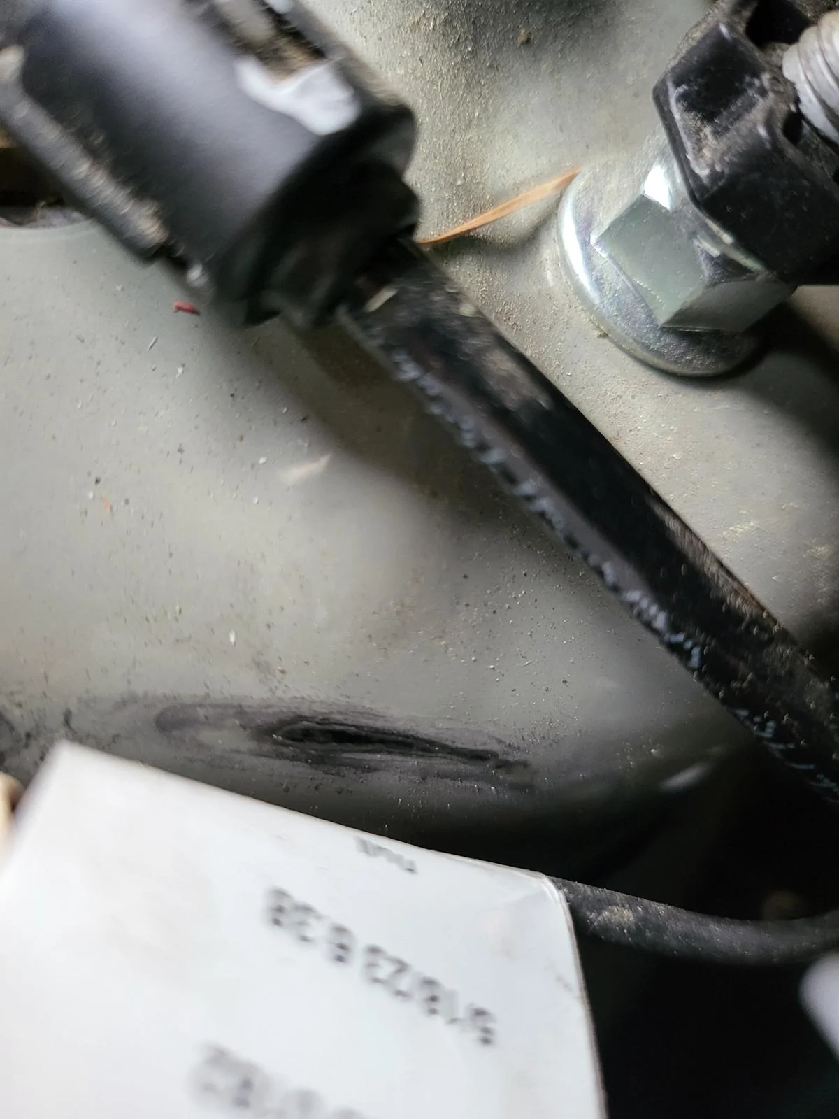

Here's where I have issues. The ground connector on the compressor rubbed against the strut tower. It's bad enough that it wore through the paint and the car has 4k miles. I bent it out of the way.

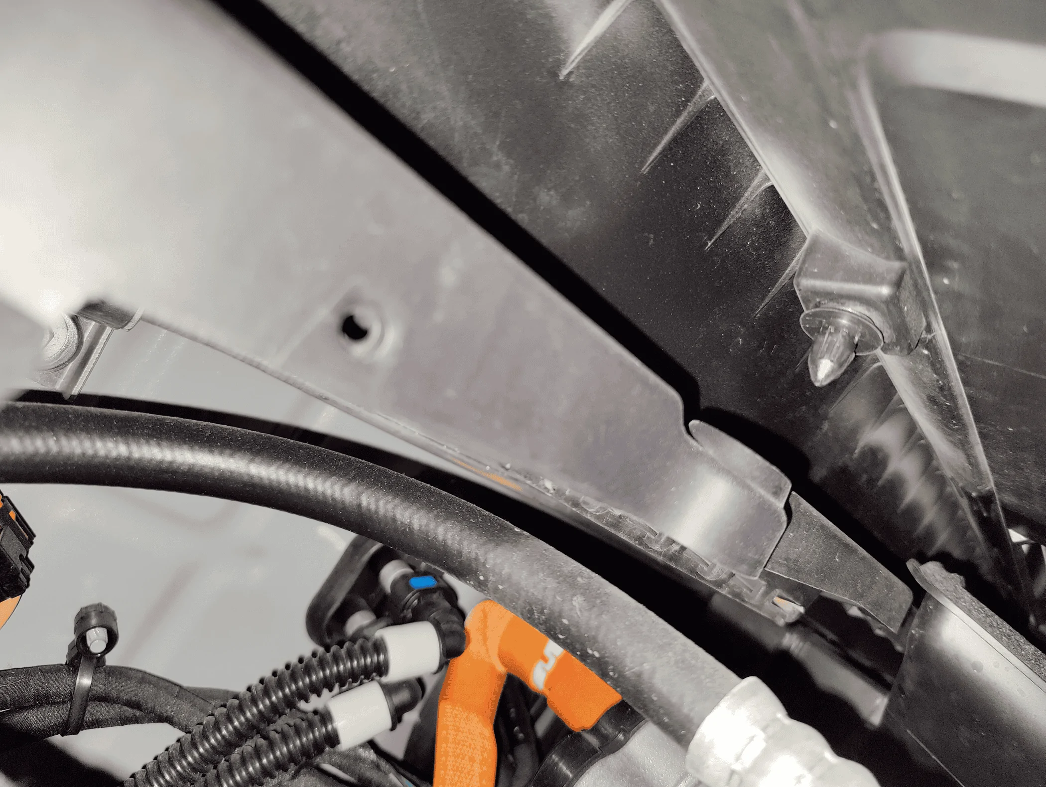

The cabling going through the firewall hits against the HV orange line coming out of the compressor. Bent those a bit as well as they continually rub.

There are also a couple of sensor leads the rub on the lines. One off the compressor back and one near the battery. I moved those as well.
