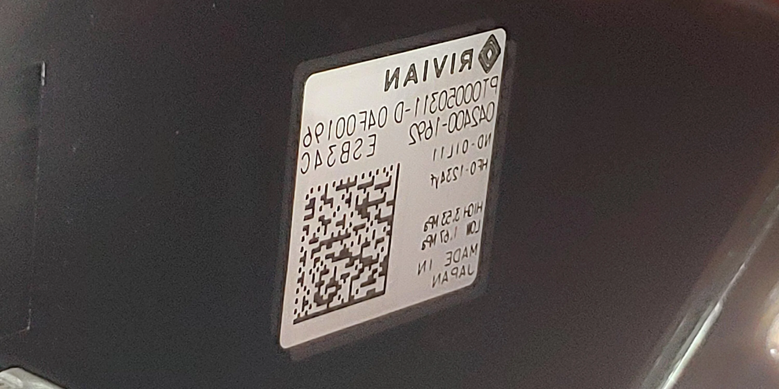

Sorry if I missed it, has it been confirmed that the noise is definitely coming from the AC compressor? A few "last resort/divorce eminent" ideas for the OP:
1) Is the compressor (or whatever is making the racket) custom made for Rivian? If not, is there a manufacture listed on the part you can contact and get some more information from? They might be tight lipped, but maybe not. Maybe they say, "oh Rivian used part# 7382-A, but should have used 7382-B. It's an easy swap." Maybe another manufacturer has a replacement that is better suited to the job/doesn't make that noise.
2) Is the noisy part just for A/C, or is it responsible for other things like cooling the batteries? If the former, and it is a non-custom part, a qualified mechanic that specializes in A/C might have some ideas if you brought the vehicle in.
The electric compressor is used for both AC and battery cooling. There’s a good probability it’s a custom design for Rivian.

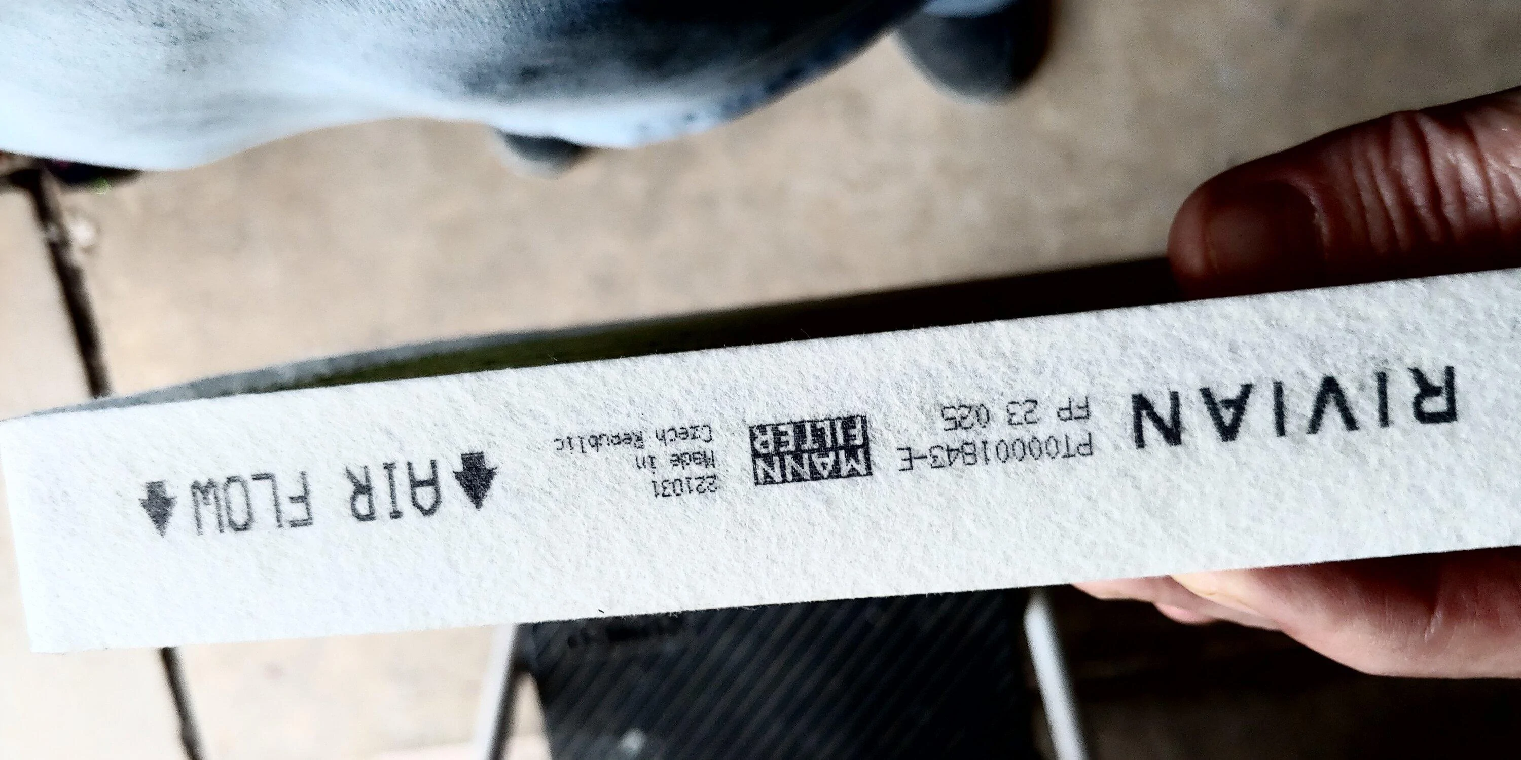

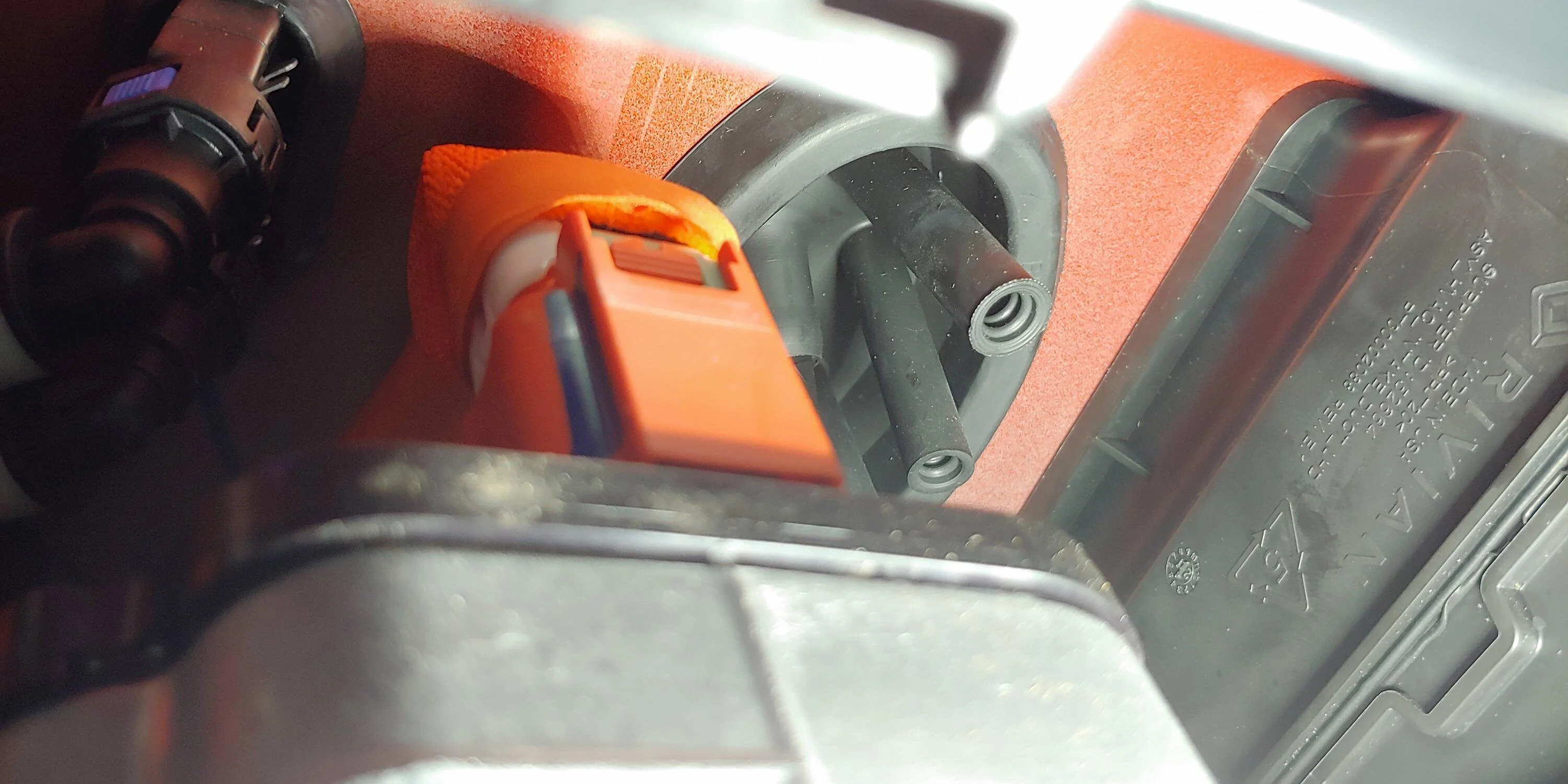

Here is a video of Leaf Blower Mode. My R1S is normally quiet. This would be what it sounds like when loudest. Some vehicles seem to be worse than others. I'm going to wait and give Rivian time to correct the issue. I can't believe they would let their trucks drive around in public sounding like this so they have to address it at some point.
Part of the audio only comes from one speaker for some reason. It's not your device. The cover is easy to remove and is how you would replace the cabin filter anyway. I did not film it when it was quiet, which is the typical noise for mine. It's not the ground strap. I moved that first and suggest you bend it away from the shock tower if you remove the cover. First picture is the compressor tag in reverse. Did not bother to get my scope camera out. You can verify this yourself easily. The noise is absolutely coming from the compressor and is not the fan or something vibrating.
A couple of unrelated things in case someone is searching the forums.
Directly behind the compressor is a grommet with vacant ports. You could use this to pass cables through the firewall.
Cabin filter is 9" x 7-7/8". Sorry forgot to measure the thickness.
