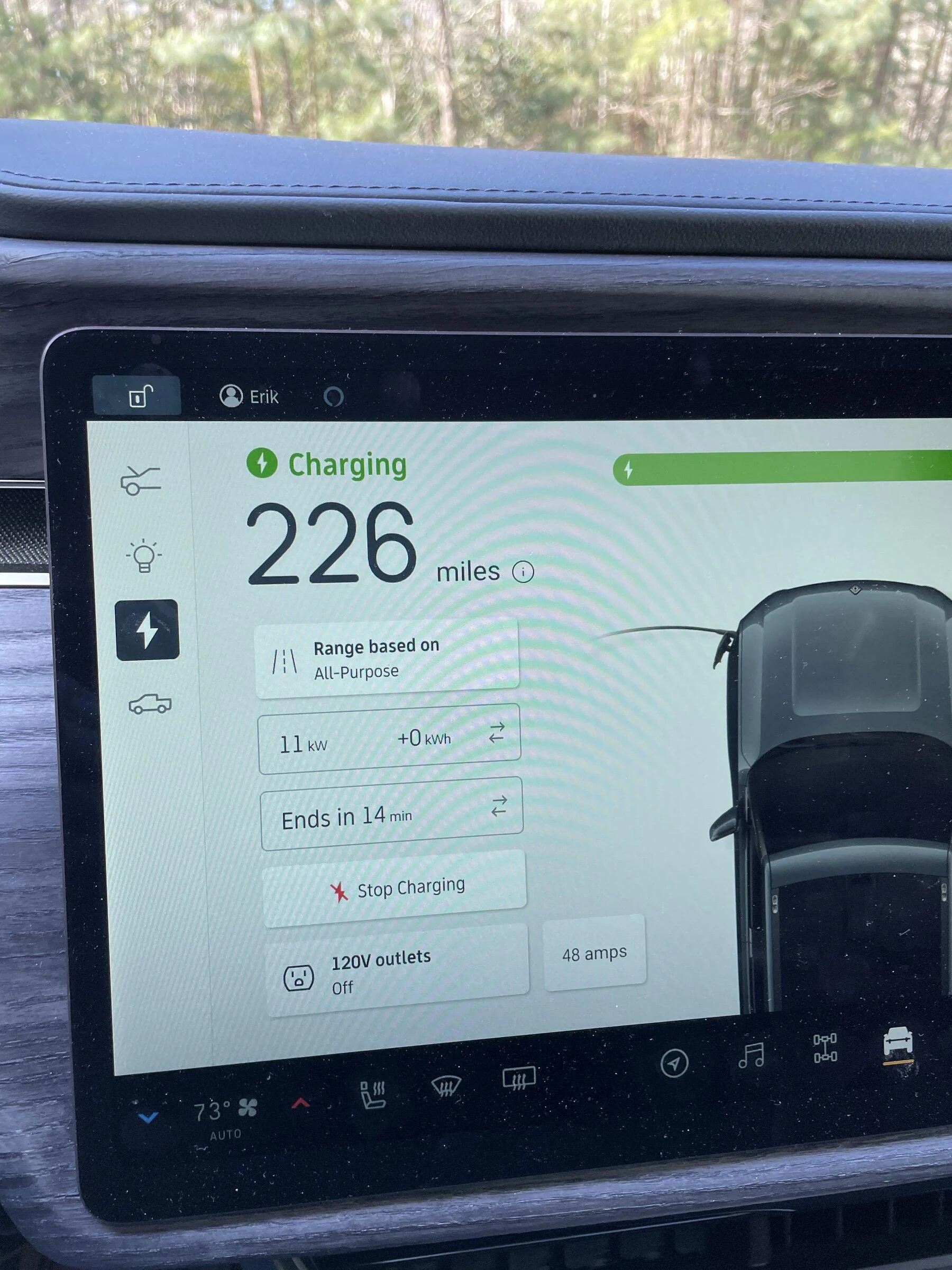

My Rivian wall box arrived last week and I had a chance to install it this morning. I replaced a Juicebox 40 that was plugged into a Nema 14~50. Direct wired it to a 60amp circuit. Pulling 11kW. Very easy install.

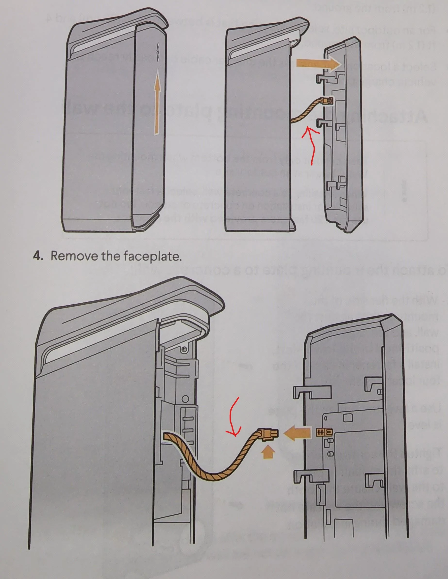

Yes (my electrician had never seen this charger before). Make sure you connect the cable to the face plate...
Mine is also not allowing for connection via bluetooth in the same way. I've tried two devices but, admittedly, they are both Android devices. When you say "connect the cable to the face plate" are you talking about the cable pictured in my attachment?
Yes.

I ran into this exactly same problem with the same light show on the charger. When I found this thread I found the info saying to connect the wire to the front panel. I opened the box (breaker off) and indeed - the wire was not connected. I'm assuming that the bluetooth and wifi radios are built into the circuit board that is attached to the front panel and that's why it never showed up in my app.
Even if yours is connected it might be worth disconnecting and reconnecting to make sure the connector is seated fully. This connection completely solved my problem.
