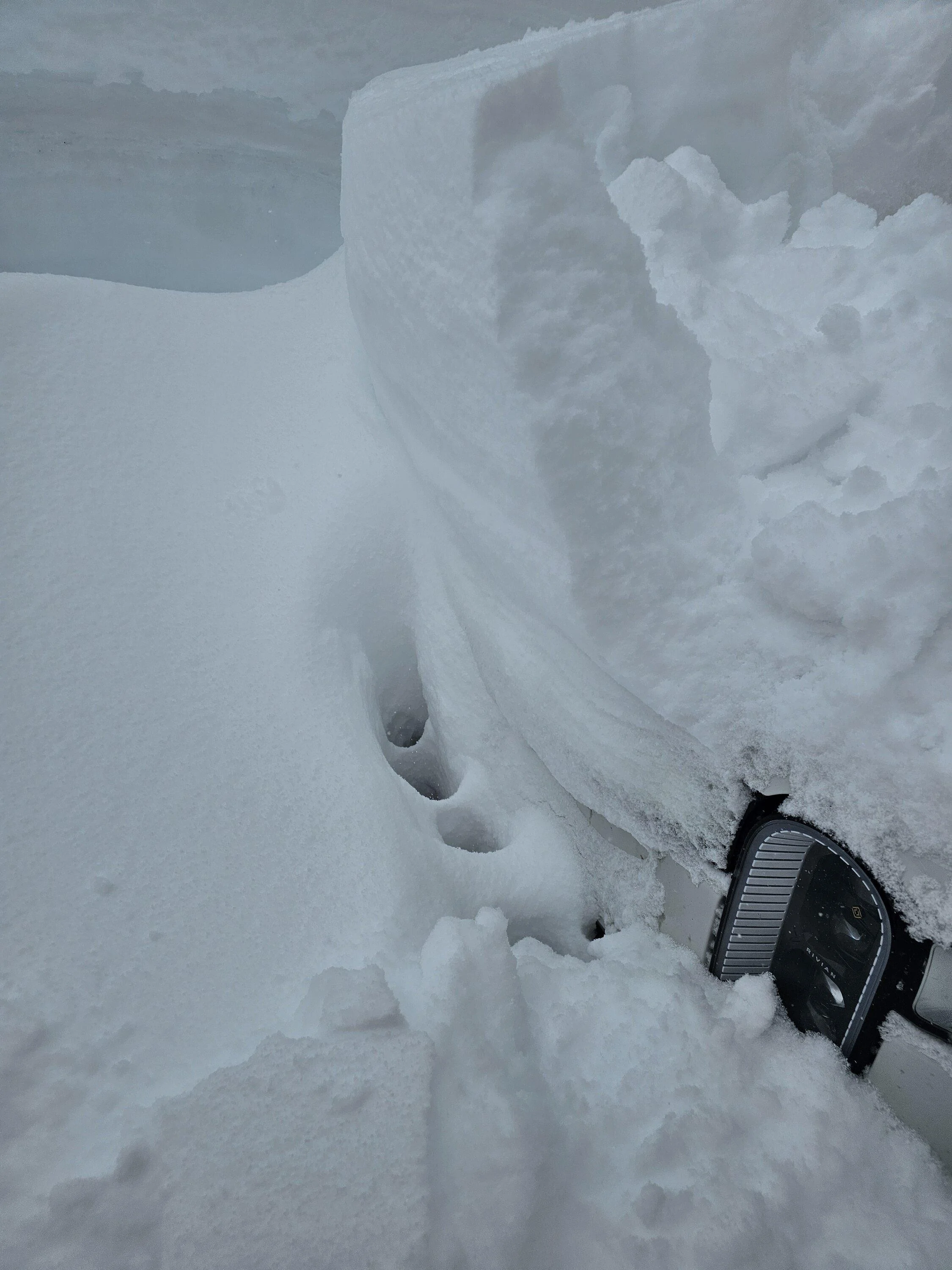

Even if the R1 is not plugged in, it will use as much battery as it likes to keep the battery temp comfy … this wastes a lot of energy (money) and still doesn't pre-condition the battery for anything more than a drowsy teenager level of regen effort in the morning for the first 10-20 miles.
Tesla now uses additional friction braking to simulate regen.
Here's a visual of how much heat escapes the R1T:
Rivian R1T R1S Rivian introduces LFP Batteries 20230228_132739
