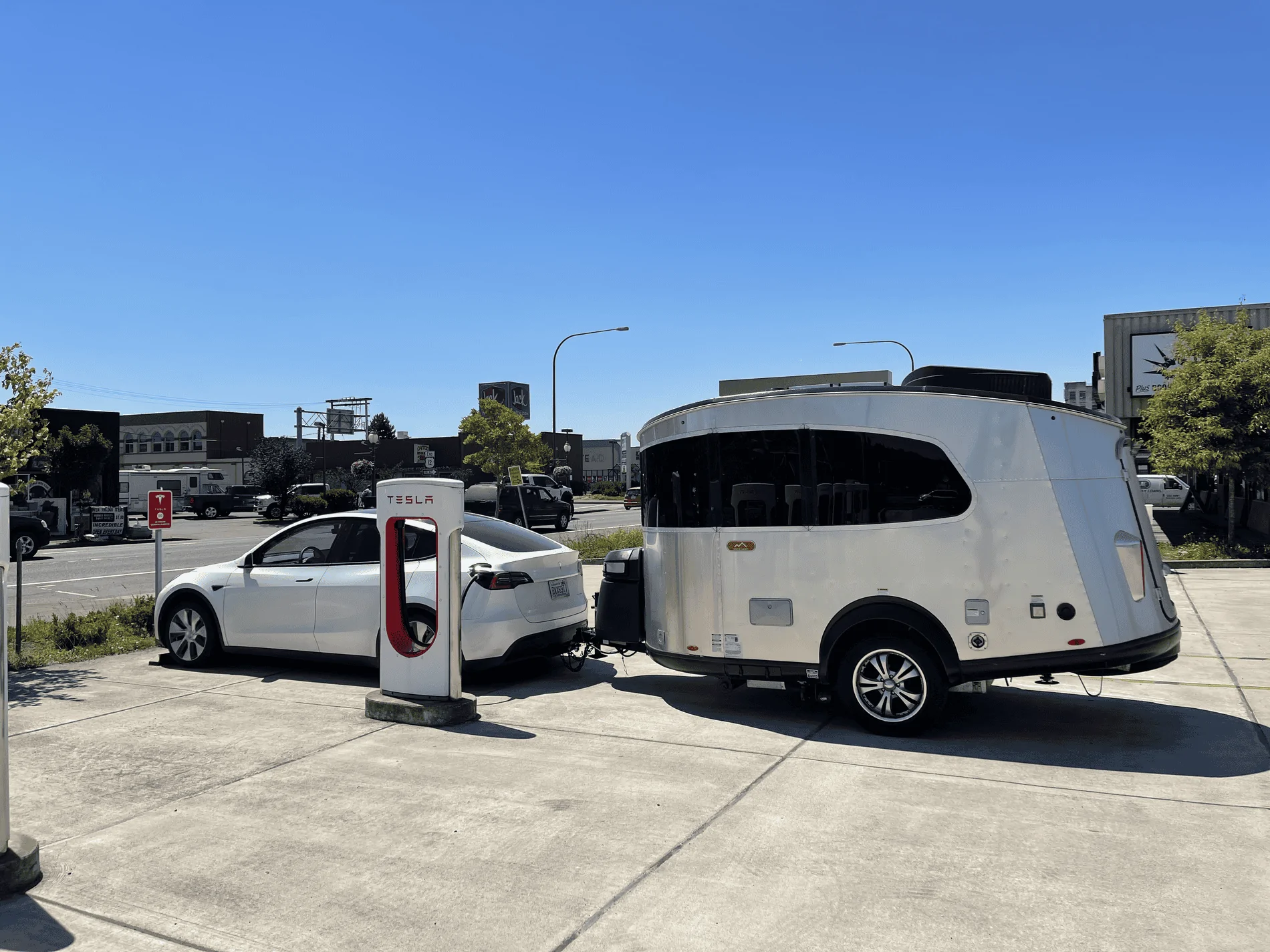

There's a lot of doom and gloom about towing in this thread. No, the Rivian is not a cross-country freight hauler, but it can absolutely do some recreational towing.
I'm confident because I just got back from a road trip around the Olympic National Park in WA with a Model Y towing an Airstream Basecamp. It cut our range by slightly better than half vs. the rated mileage, and we had no trouble charging (only needed to unhook once). It performed incredibly well despite >110 degree temperatures. An R1T should be better in every way.
No, you probably won't be shotgunning 11,000lbs from coast to coast, but you can have some fun.
Rivian R1T R1S Rivian payload / towing capacity and trailer brake controller Untitled
For the brake controller, we found a wireless one (accelerometer-based with adjustable sensitivity) that we were really happy with - I dialed it down to the lowest level to avoid interfering with regen as much as possible.
It's entirely justified. If you tow something with large Cd and large frontal area it's going to cut range way down. If you tow something with low Cd and moderate A, as you have done, you are going to lose about hald your range as you have just demonstrated.
Another thing I haven't seen mentioned (maybe I missed it) is the effect of frontal area.
There. I just mentioned it as I have done on every other post, this forum or other, in which I have posted on this subject. What a trailer does to your unfettered range depends on how many Wh it takes to pull the trailer a mile relative to how many Wh it takes to pull the truck a mile.
Sure, as you mentioned, the impact will depend on the aerodynamics of your trailer, the weight, and speed, among other factors. My point is simply that there are many cases, even with relatively large trailers, where it's feasible for recreational or occasional hauling - whether it's moving a boat across the state, moving house, towing a travel trailer, etc.
It's probably not the right vehicle if you're frequently taking a toy hauler from Seattle to Moab, but that doesn't mean we should dismiss it out of hand. If I learned one thing in towing the Y, it's that everyone dismisses it out of hand because they've been told electric towing is impossible. It's certainly not.
I have repeated over and over again what I put in #55: if Cd*A is small enough then it is quite possible. I've done Monte Carlo simulations and numerous calculations showing that on average you'll probably lose 50% just as you found to be the case. How many will click on a YouTube video titled "Monte Carlo Simulation by Retired Engineer Shows Towing Feasible" rather than "TESLA TOWING: DISASTER!" posted by a self appointed BEV expert?
It's very hard to counter negativity like this once it gets out there. The best we can do is if people like you continue to publish you real world experiences.
