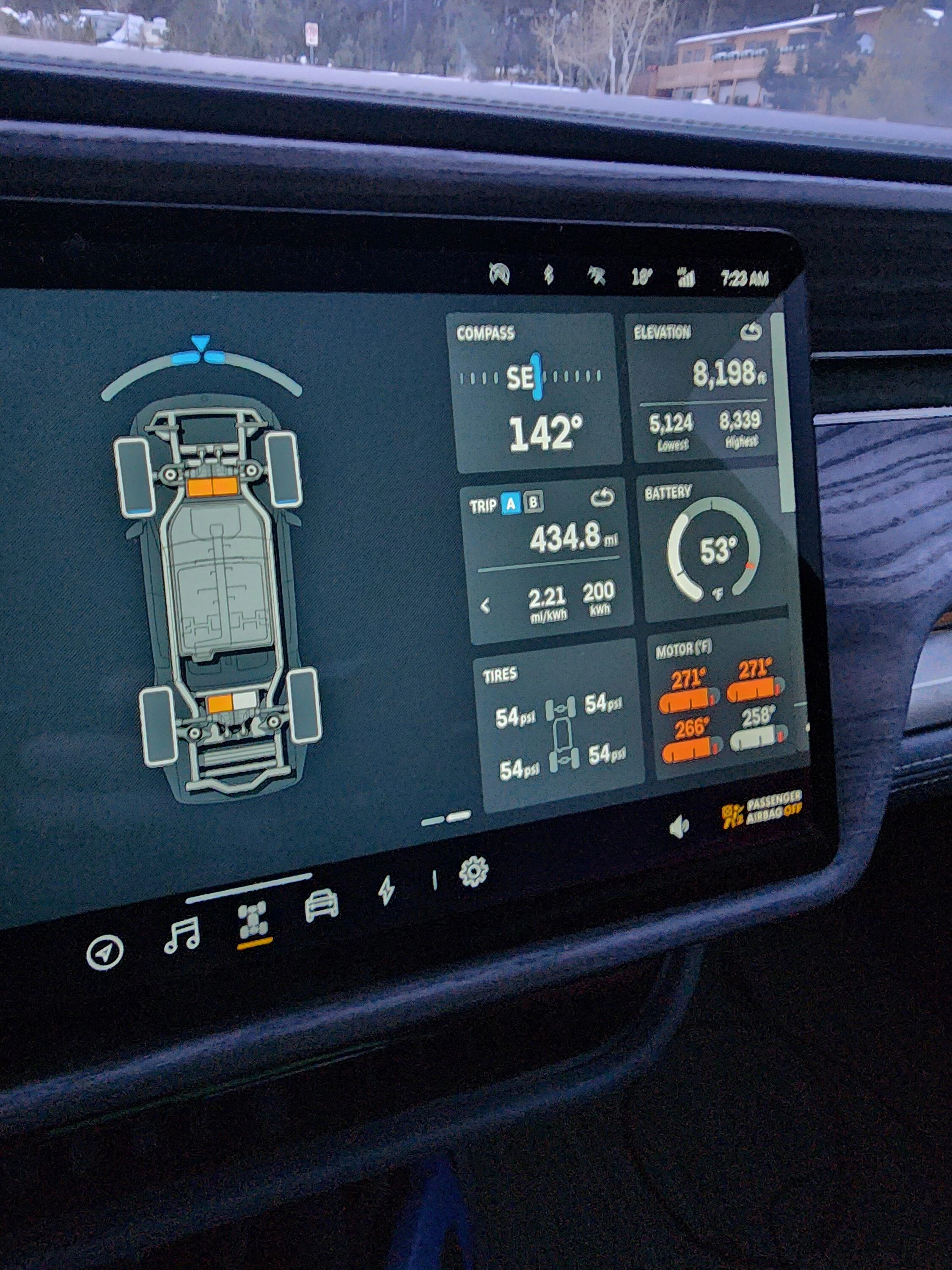

I hate this system to heat the battery, it's wildy inefficient when you have to have you car parked outside and not plugged in(while at work for me)and it seems to make the heat in the hvac system not as effective while it's taking place, also since it can do this they really need to add the function where this waste heat can also be pumped into the cabin like an ECO interior heat function like Mercedes uses.
Today was pretty cold when I left work and I got to watch it overheat my motors even though the battery was at 42 degrees(not freezing) just to get the battery to 53 degrees and I lost 30 miles of range covering 8 miles on flat ground.
Not much solace to QM drivers, but they did fix this issue in the DM, making it much more efficient.

DMs need to create far less heat to do the job, because the oil bath pulls it more efficiently off the coils. So whereas you will see them heat up a bit, you won't ever see the high heat the Bosch motors have to create just to export a little bit.
