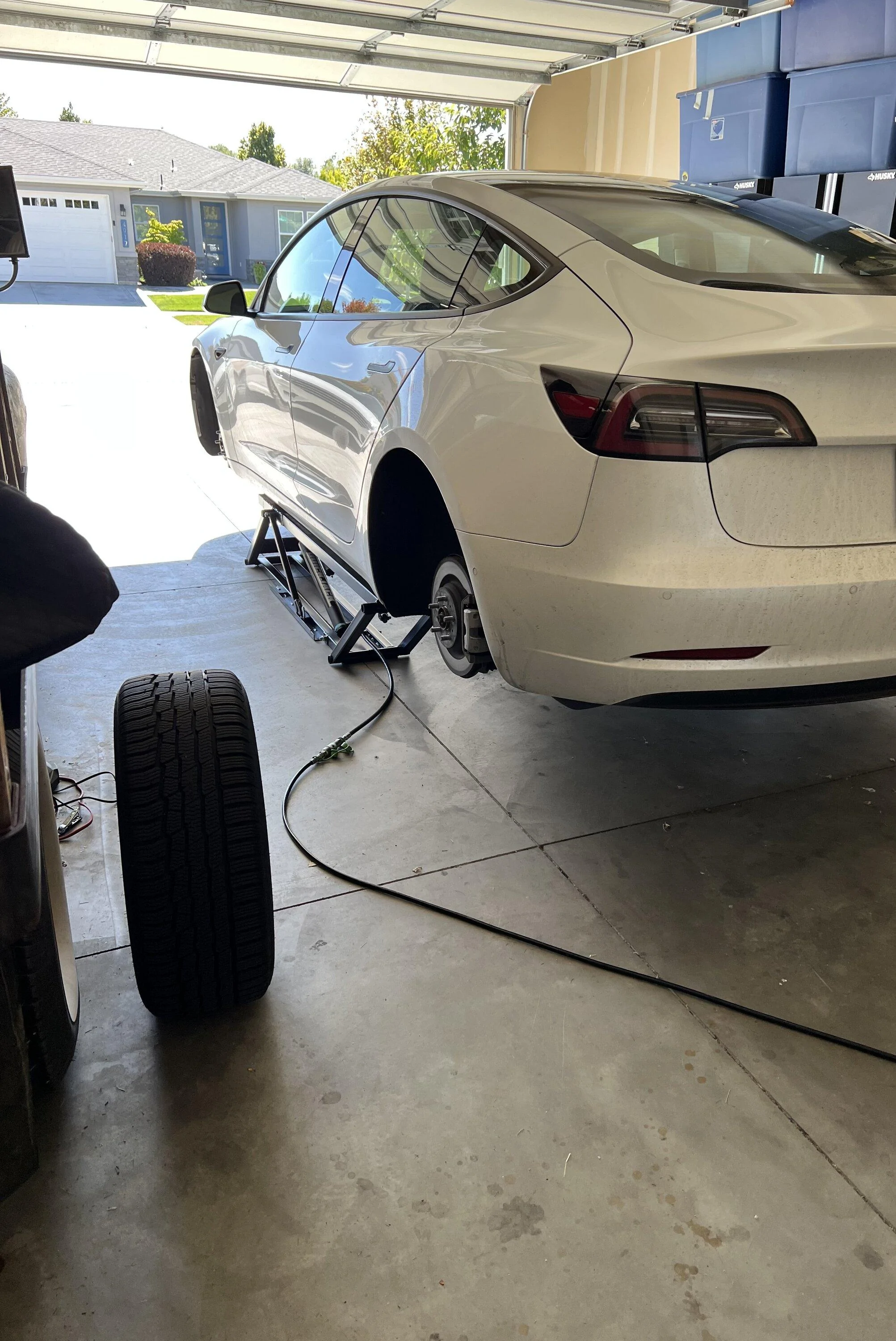

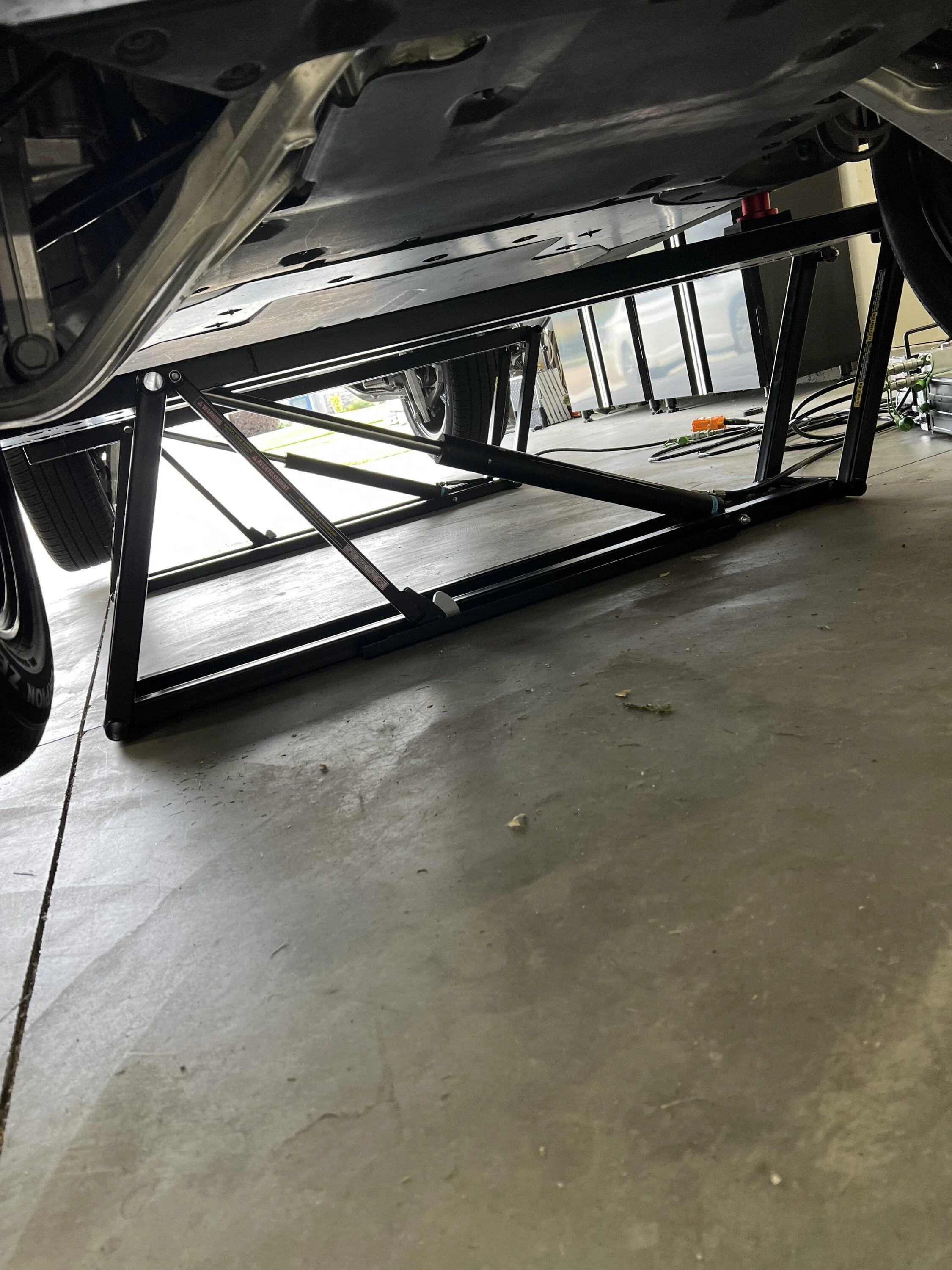

It’s a quickjack 7000 tlx. Got it mainly for my model 3 with hopes I could lift the Rivian. It does work for the Rivian but you need to be pretty careful a go easy when lifting the Rivian. Wish they made longer frames that would reach the Rivian jack points without turning the lifts sideways.
PSA: I reached out to QuickJack as I was going to get this exact setup and they were VERY adamant I not use it with the Rivian, as it exceeds their weight rating.
I totally get there's safety factors to consider, and that this seems to be working for now, but repeated use can result in catastrophic failures when you're using pneumatic or hydraulic systems. Likely worst case is simply you 'drop' your vehicle OR it gets stuck in the air, but .... not worth the risk in my opinion. I did ask QuickJack if they had any plans to build bigger systems, and as of April 4 this year, they said they weren't planning to build anything bigger.
151
13,762
27,979
Engineering, Dog Petting
They can't say "you'll probably be okay" because if something happens, even if it was your fault, they could still end up liable. I'd consider this setup for rotating tires but I'd never get under a vehicle where it's overloaded.
R1Thor
Joe
Aug 9, 2023
1,545
2,442
Lancaster, PA
Mechanical Engineering Lead
You're not wrong, but again, I'm going to look at this from an engineering standpoint. Do all of the statics lineup in a way that it's likely non issue? Yes, likely. But highly improbable this system was ever tested with repetitive stress to raise and lower (which is actually more stress on the hydraulics, counter-intuitively) such vehicle weight that you're inviting premature failures.
Can you drop the R1 from the ~12-16" of height and cause no damage? Likely... but then you go to use that setup again on your Model 3 and drop it and suffer suspension or sub-frame damage, that's on you.
Everyone considers static loads, but in situations like this, it's the dynamics and recursion that are going to shorten the lifespan of EVERYTHING within the lifting system. Hell, even depending on what fluid they're using, will only be certified for specific loading due to thermal thresholds and the opportunity for fluid shear to prematurely break down the fluid, which is going to cause seals to leak prematurely.
Like seriously, this is just a bad idea...
My RIS scales out at a few pounds under 7000. No underbody shield or spare. Lifts rated for 7000 according to their documentation so within their limits to lift my R1S
151
13,762
27,979
Should also consider that there are some R1s that are actually under 7000 lbs when empty. All R1 GVWRs are 8,532 lbs, and Rivian says the maximum payload capacity is up to 1,764 lbs depending on the configuration.
Mine is well over 7k though.

On the R1S and even the tesla I am not a fan of the quickjack rubber blocks. They deform and compress a bit under each of these vehicles. Probably going to order some UHMW blocks to replace the rubber…. Or just make some out of some steel tubing.
from a mechanical prospective and use prospective in my brain I think the lift of the tesla is a bit harder on the lift then the Rivian lift. The lift is pretty much flat and takes some wiggling to get the jack pucks and the blocks on the quick jack when jacking up the tesla. The lift cylinder is pretty much horizontal and the steel supports are pretty much horizontal when it has to lift 4500 lbs or so. On the Rivian with it in offroad mode and tire change activate the lift cylinder is at more of an angle pushing up and the steel supports more upright when it starts taking weight. You can hear the difference in the electric pump load between the vehicles and it is working less hard when lifting the Rivian IMO just based on sound. Yes there is a structural component and just based on life experiences steel is stronger in compression Versus a longitudinal force like a lever. When lifting the tesla all the stress appear to be more of a lever type stress vs a compressive type stress when lifting the Rivian.
I bet quickjack has engineering data on failure and I would guess it’s stronger the higher it lifts just based on physics and design.
