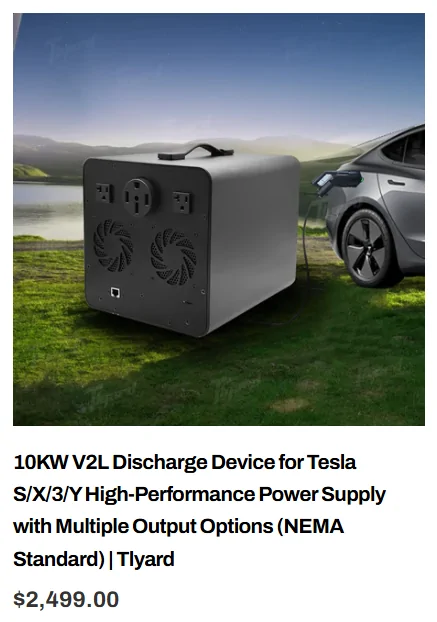

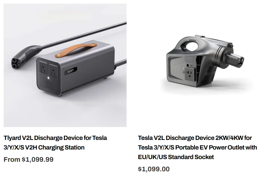

The Sigenergy V2X module costs about $3500, but it is up to 25 kWh. Tlyard has three solutions that are designed for V2X but at a lower power; however, I have not seen any tests with Rivian to confirm they actually work.
The Tlyard options are much more reasonably priced, and in line with what you are trying to do. Maybe the cost of these solutions will drop over time as more competition emerges, but I expect the cost will never drop down to the price of that Sunboost inverter.
Rivian R1T R1S Rivian V2X V2H Solution available now using PointGuard/Sigenergy BiDirectional? 1772652766794-14
Rivian R1T R1S Rivian V2X V2H Solution available now using PointGuard/Sigenergy BiDirectional? 1772652823453-1u
The 10 kW version follows the NEMA standard for V2X, so it is the one that is most likely to work with a Rivian. The other two are definitely questionable, and are designed for use with a Tesla. If I had the time, I would buy one of the $1k versions and see if it works or not. Maybe this summer unless someone else beats me to it.
