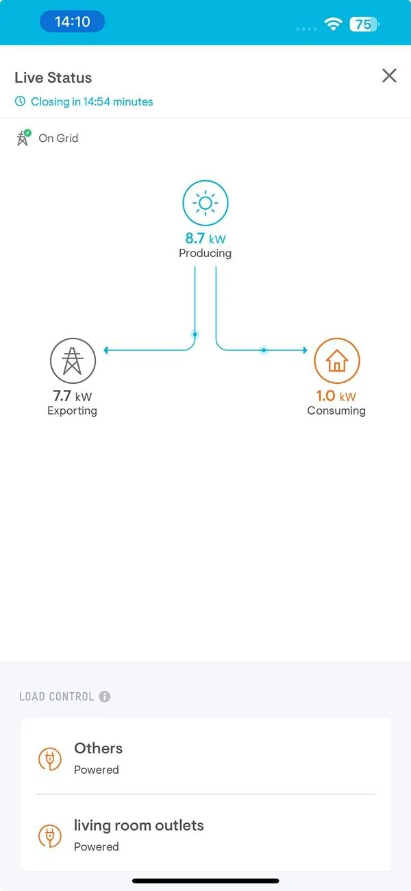

When we installed the Enphase system, we added a controller (you might already have with your battery BU) to allow us to operate off-grid using daylight solar production from the IQ inverters. Our installer set it up with the CT's so that solar power is used first and augmented with grid power, as needed. Here is when the EV's are charged:
Rivian R1T R1S Rivian V2X V2H Solution available now using PointGuard/Sigenergy BiDirectional? enphaseEnergy
I also set the scheduled charge for 9:30 am to 4:30 pm using 32 amps for each EV. I can adjust, as needed for low solar or high travel days--in that case Enphase pulls just enough from the grid to hold the charge rate.
Here is when the EV's are being charged:
Rivian R1T R1S Rivian V2X V2H Solution available now using PointGuard/Sigenergy BiDirectional? enphaseEnergy2
