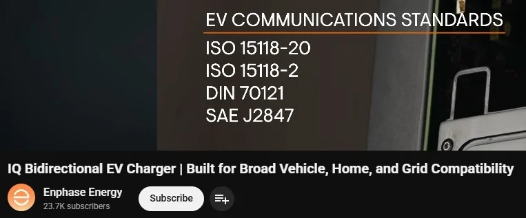

New video from 3 days ago.
IQ Bidirectional EV Charger | Built for Broad Vehicle, Home, and Grid Compatibility
via: Enphase Energy
And datasheet.

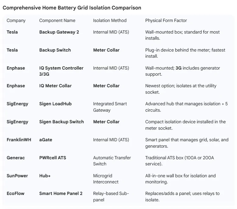

I had AI help with the list below. Personally I'm looking at SigEnergy w/Sigen LoadHub that can take two SigenStor battery stacks at 11.5 kW each into the LoadHub to pass on to the house electrical panel. Winter and worse case is heatpumps defrost cycle and the hot water tank.
It seems Tesla pioneered the use of the meter collar. Enphase now have theirs approved for use by PG&E in my neck of the woods. I assume every supplier will offer this as a solution eventually, since it seems to help with a lower system cost on smaller systems and can help avoid having a separate critical loads panel installed.
via: Enphase Energy
Thanks for posting.
Our existing system is grid-forming with switching for grid isolation. Not sure if Enphase requires the newer controller (6 vs the 3 we have) and/or an Enphase battery (10 vs 5) for full integration. The Green EV charging is welcome, to pace solar production to the EV.

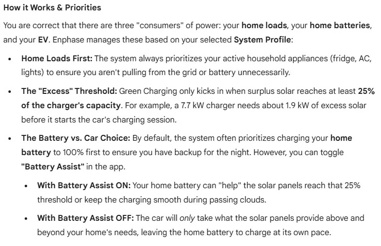

Our existing system is grid-forming with switching for grid isolation. ... The Green EV charging is welcome, to pace solar production to the EV.
Ha, switching makes more sense than swathing as I thought you were using some new term I didn't know (happens a lot!).
The Green EV charging thing is more complex than it sounds. I was going back and forth a little with one of my AI LLM friends :)
Rivian R1T R1S Rivian V2X V2H Solution available now using PointGuard/Sigenergy BiDirectional? 3 kW sources Screenshot of Google Gemini

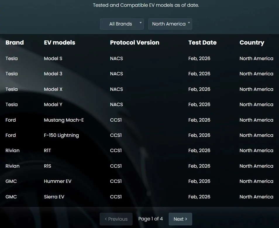

I keep reading that there has been some official interaction between Rivian and SigEnergy (was Pointguard in USA) but I have not found anything official.
There are standards for all this (see second image of one example) so as long as both parties follow the standards it is OK. The common thought is as long as it follows the existing capacity warranty, then all is OK. A non-issue for me since it is for outages and not for daily TOU rate arbitrage.
https://www.sigenergy.com/en/index/v2x_compatibility
