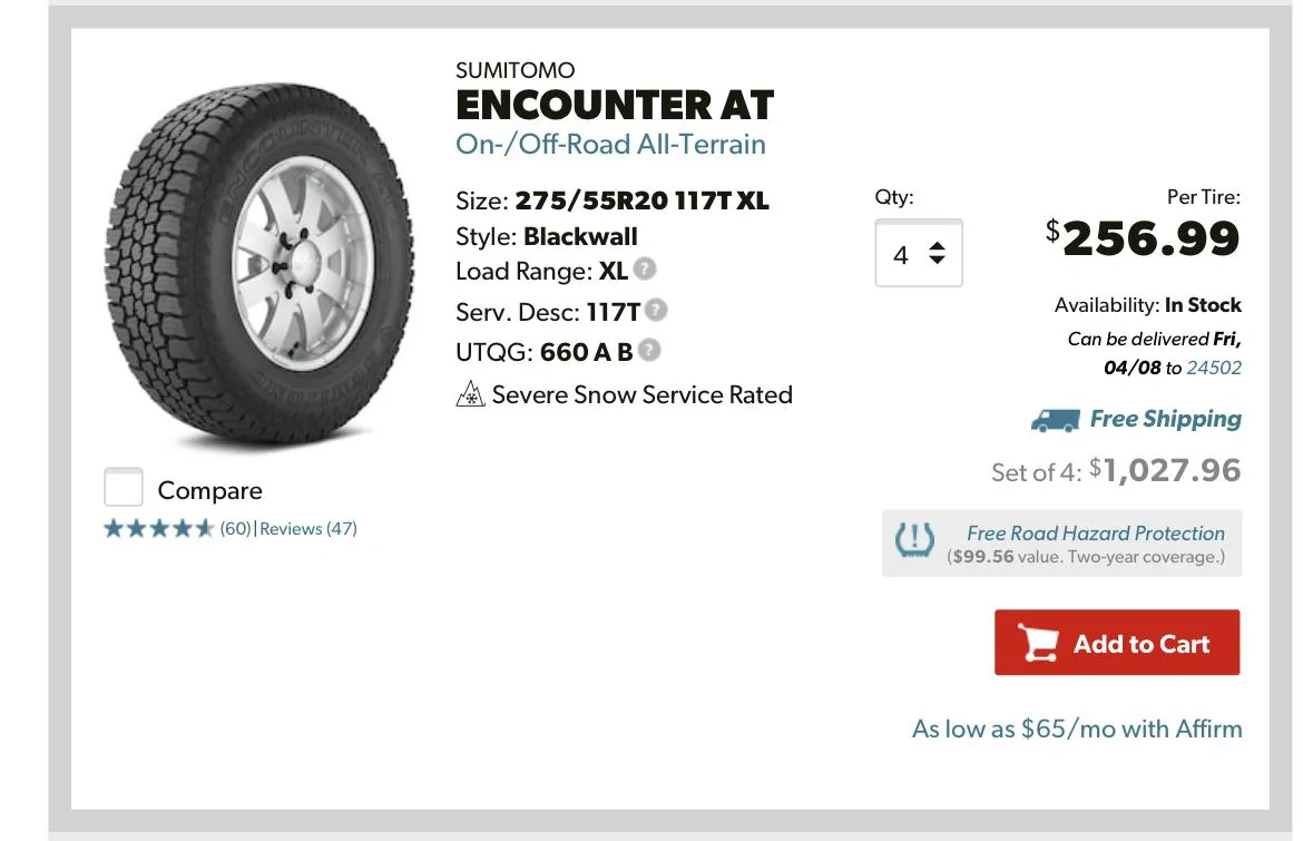

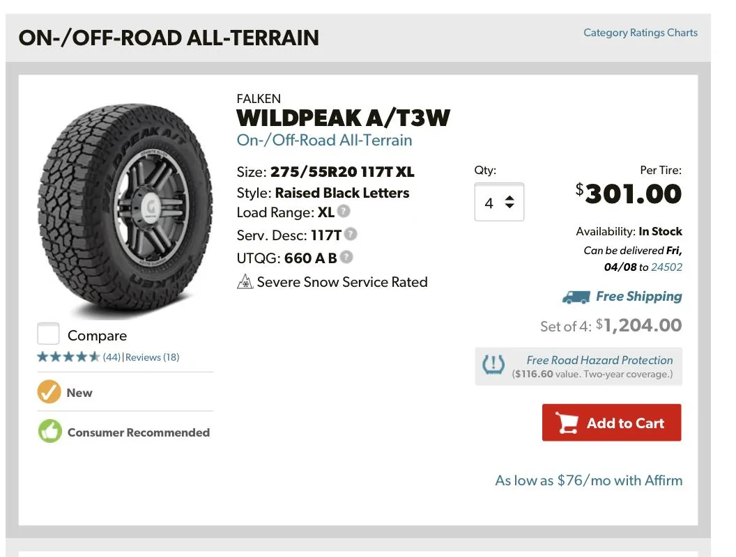

How will these handle the weight of Rivian?
Absolutely fine. New to EV people get stuck on weight. Truth is F150 gvwr is almost the same as R1, but Evs are subjected to higher g loading due to CG and acceleration from a stop. And they're both XL, so the Falken has a 2833lb rating per tire, but it's heavy at 48lbs each.

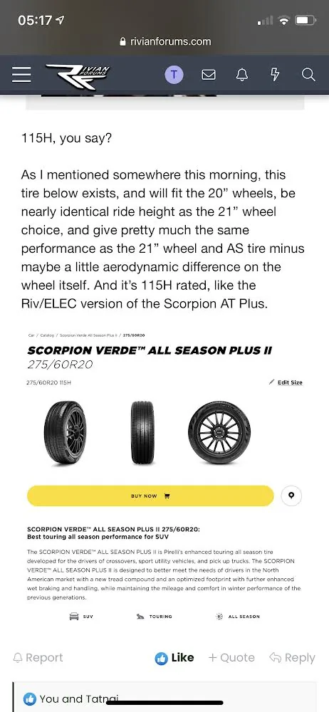

Someone on Reddit reported a delivery with 20” wheels with AS tires directly from Rivian.
Very curious to see what size this tire is if confirmed, but I bet it would be this one, which seems like the best AS tire for the 20” wheels:
i highly doubt this is an option. particularly based on the news that Rivian wants to batch builds as much as possible. id also recommend going with 21s and then buying aftermarket rims. i also dont think the 21s will have many more options in the future. it remains unique to Rivian and based on just the number of vehicles that will be out there, dont expect a lot of otpions. if you want to save money get the 21s for now. once the original tire is worn, look for either 20s or 22s that fit. you'll have more options short term and long term and it'll be cheaper than buying the Rivian 20s or 22s.

you are right, and the person confirmed it was an error (they took delivery of 21s).
