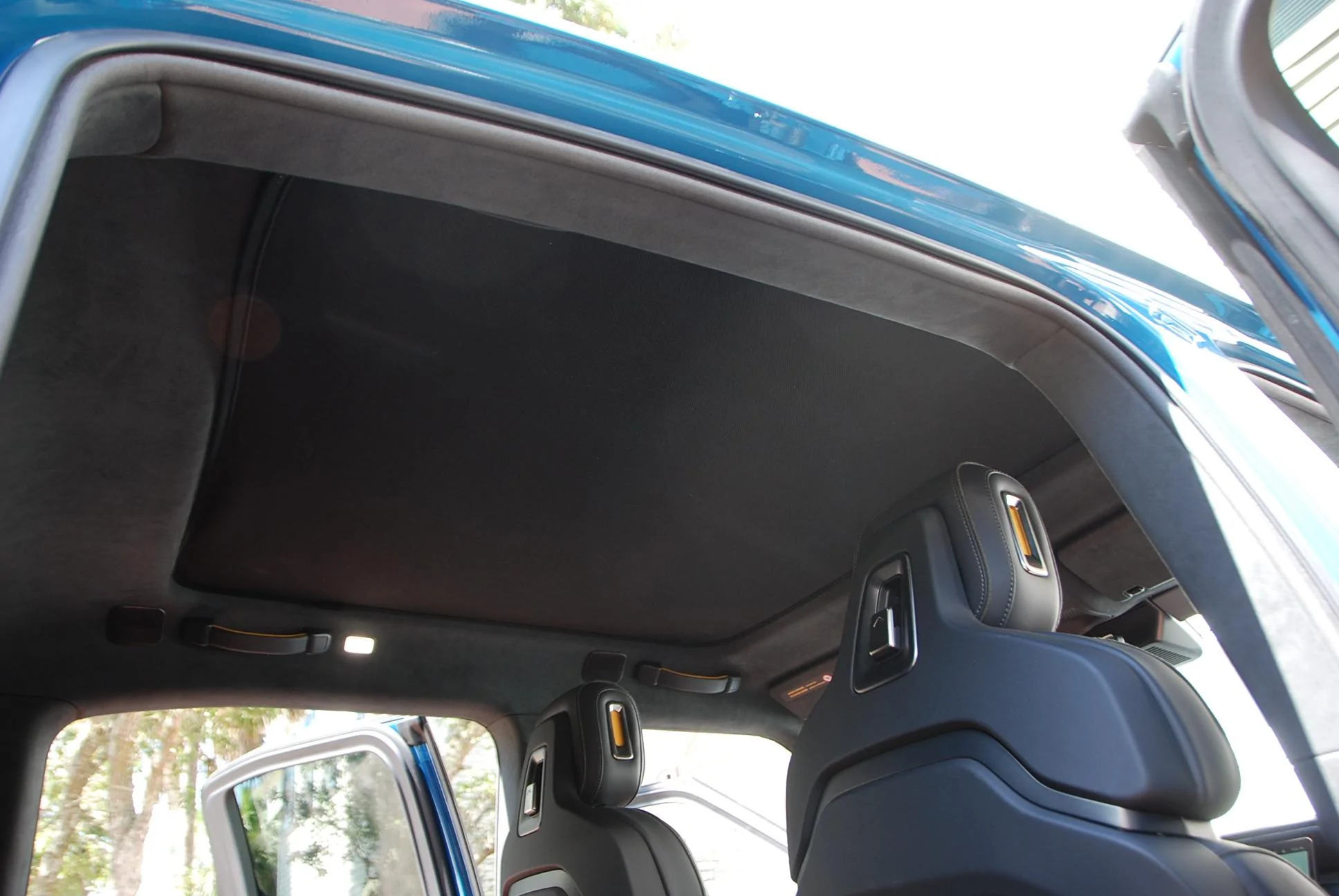

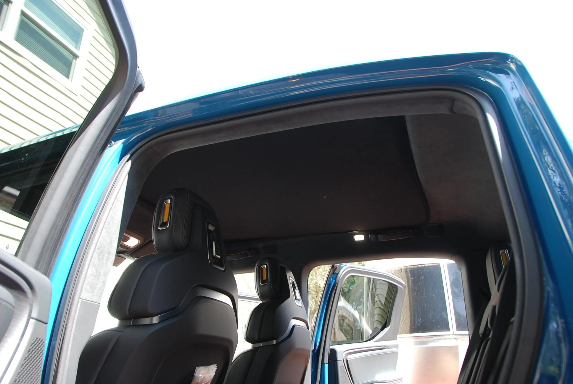

Brian, are the roof coverings on the interior or exterior? I have avoided getting an interior roof shade as I think it would be much more effective to reflect the radiation before the glazing.
Our is the Rivigear Sunshade. It is mounted on the inside of Opal's glass roof. We purchased this sunshade on Amazon from Rivigear. We took Factory Delivery of Opal in Normal in April, 2023. We had prepurchased the sunshade and installed it on the day that we got her. This has worked very well for us.
I went on my Amazon account and found that this sunshade is no longer available on Amazon.
Rivian R1T R1S Rivians in hot weather -- experience / tips? DSC_0023
Rivian R1T R1S Rivians in hot weather -- experience / tips? DSC_0024

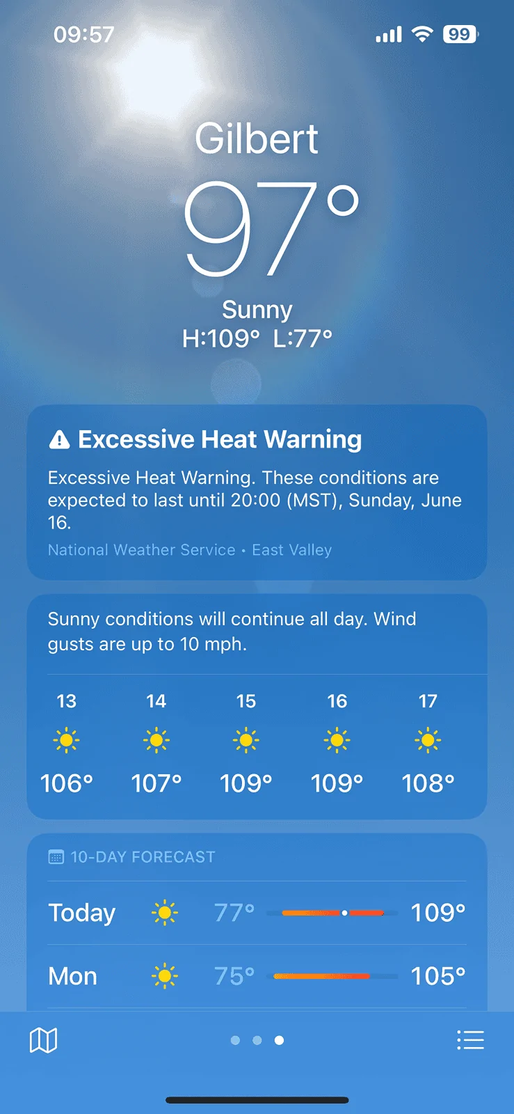

I do find it fascinating how everyone has different air conditioning requirements.
You live in a place that never actually gets hot.
I live in a place where the roof glass radiates very obvious heat onto my head and face for a few months of the year.
madhat
Feb 27, 2024
335
387
Arizona
22 R1T
90. How cute.
I too chuckled.
Rivian R1T R1S Rivians in hot weather -- experience / tips? IMG_4972
