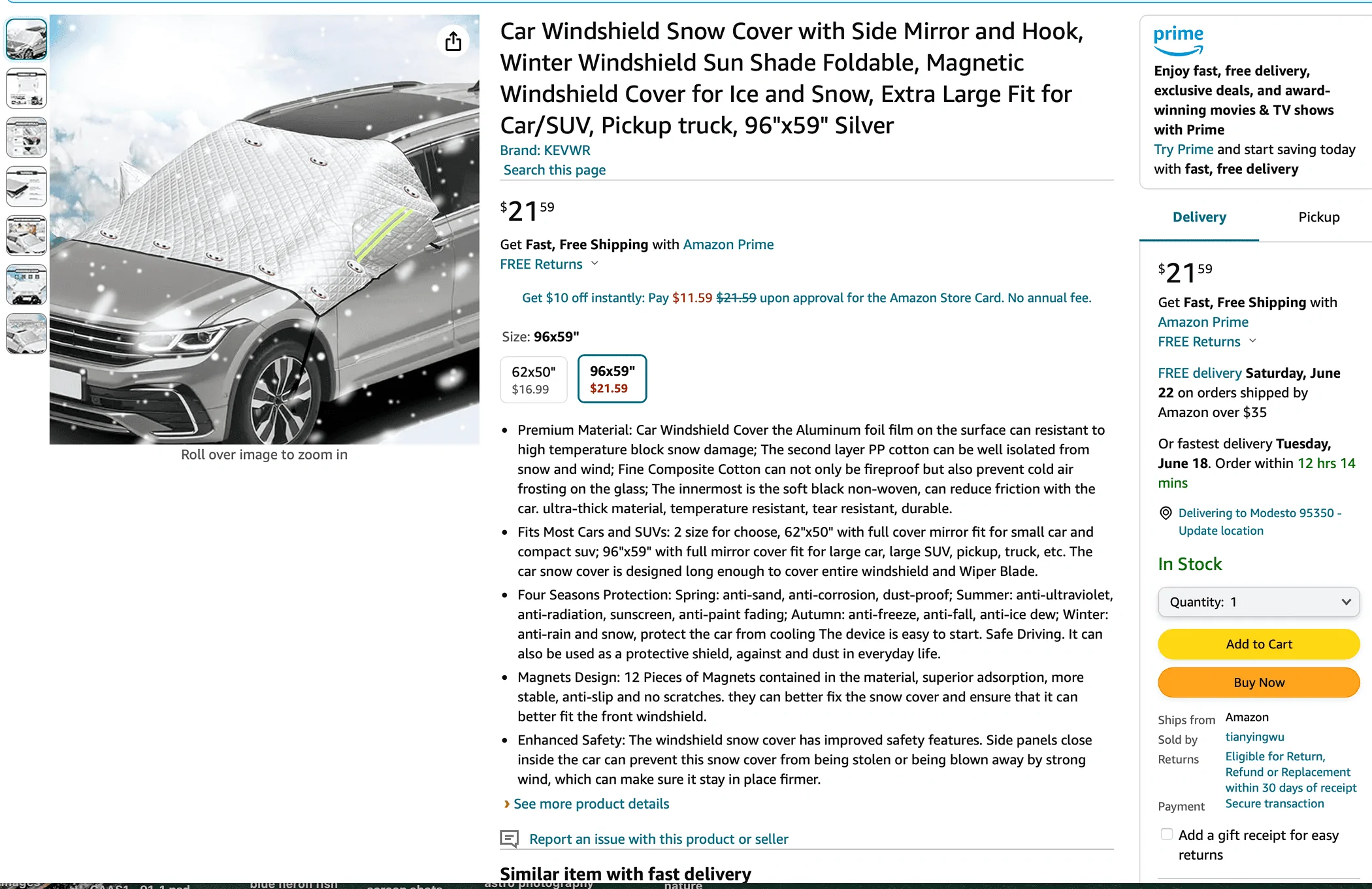

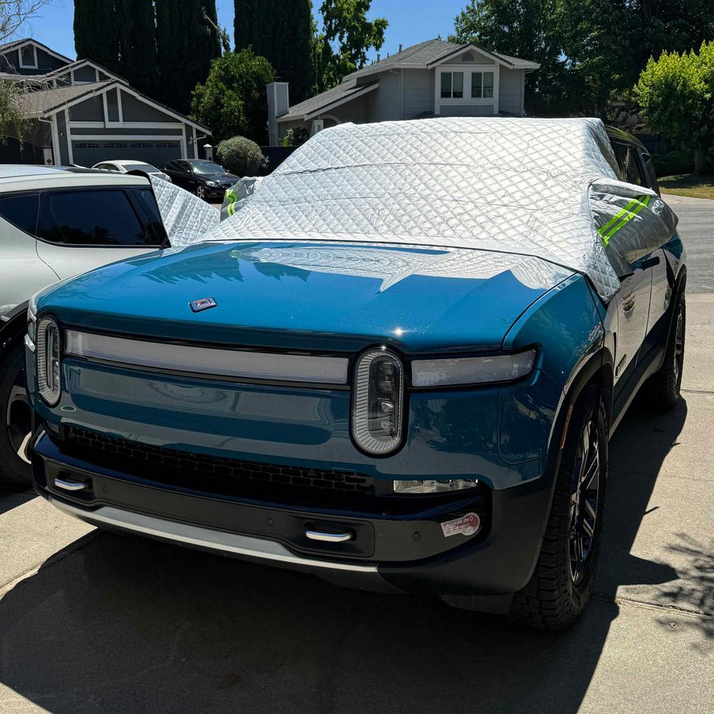

I have found the shades that mount on the outside to be the most effective in the California central valley heat. It prevents the glass from heating. They are good for two summers before they start to deteriorate.
No test with snow. The straps are fine. The "magnet" feature is useless.
