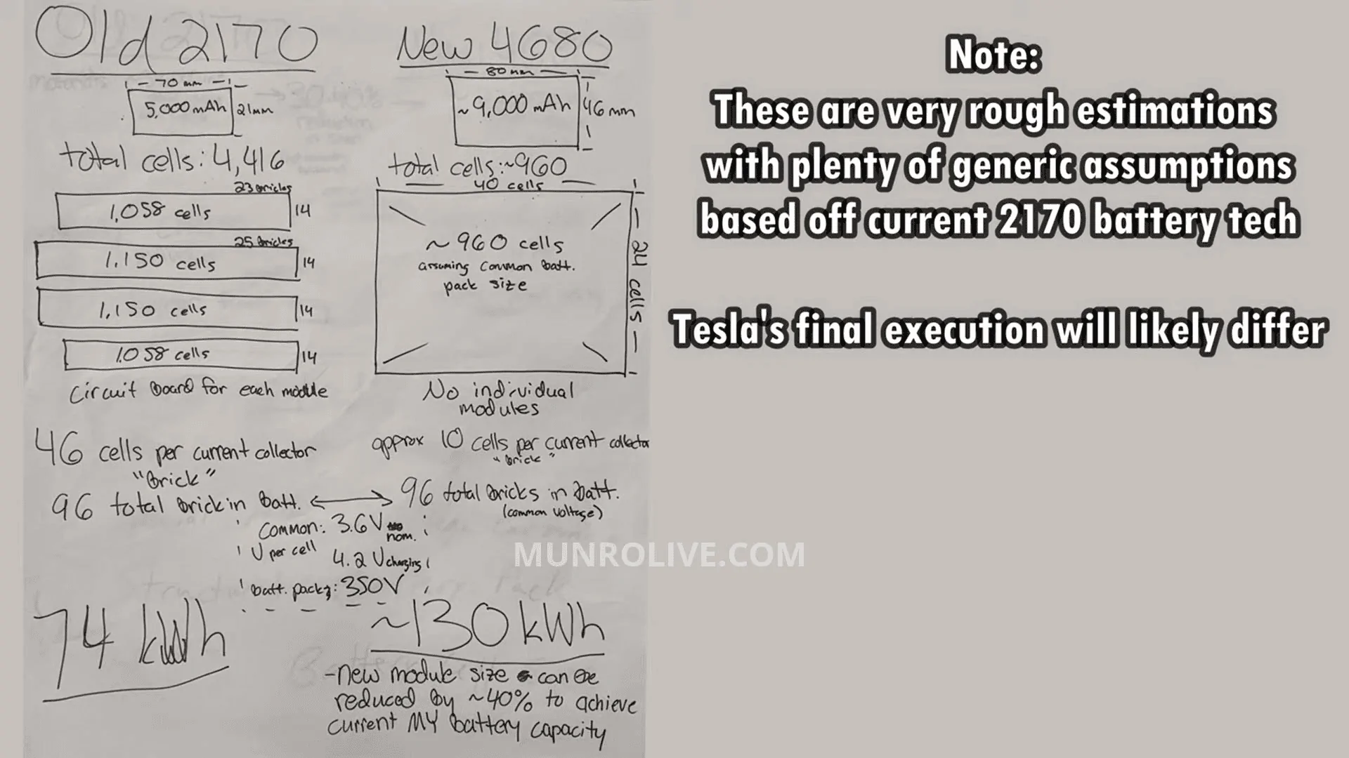

If you look at the 2170 it has 4800 mAh verses the 4680 that has 9000 mAh. If you can get 70% of the 4680 cells in the same space you go from 135 kWh to 177 kWh so range changes from 316 to 414 on the R1S. (Please check my math, I already had to edit this….)
I’m just spitballing here, I have no clue what new formats are out there or currently in the pipeline and do not even have a clue what direction they are moving but there has been a lot of development since the 2170 was created.

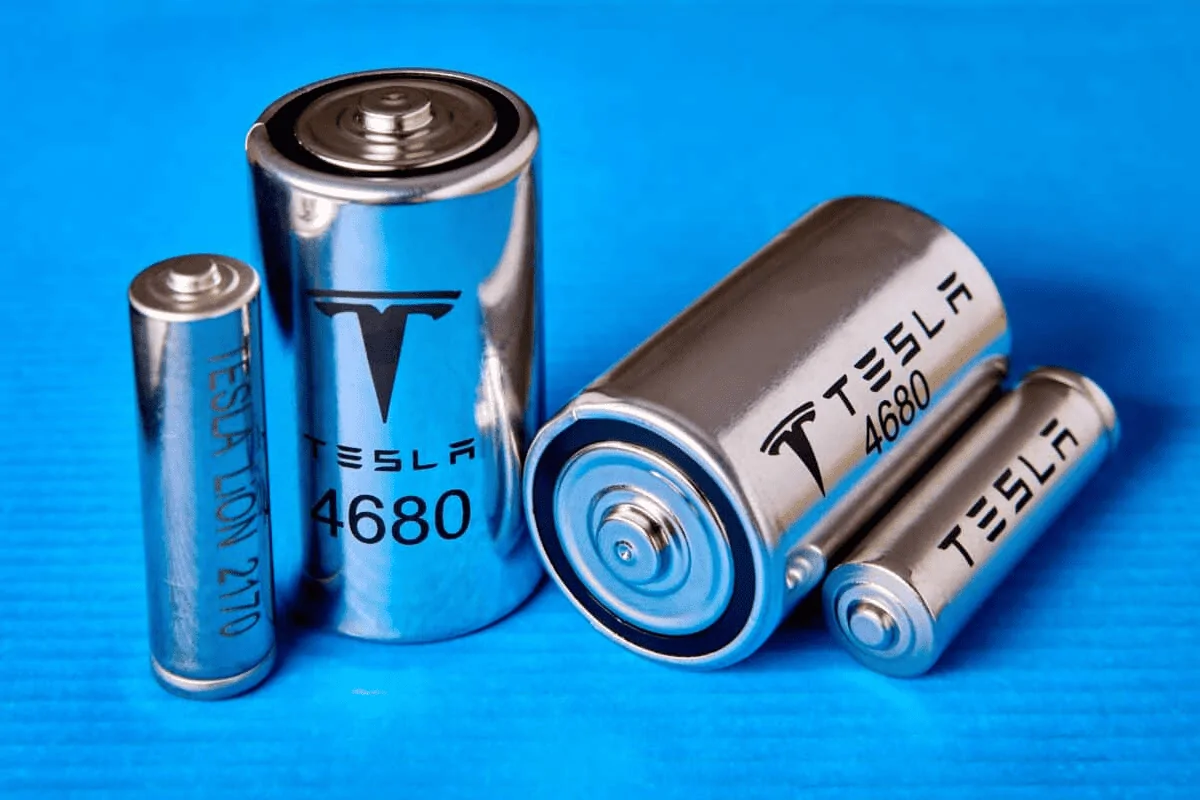

Unless I'm thinking about this wrong, a 4680 cell (46mm x 80mm) has a cylindrical volume nearly 5.5x that of a 2170 cell (21mm x 70mm). So there's no way you'd fit anywhere near 70% of the 2170 Rivian cell count in the same space. But even that seems odd because that leads to the 4680 having nearly 1/3 the volumetric power density of the 2170. So either my math/thinking is way off. Looking at mAh capacity, 9000 mAh / 355g = 25.25 mAh/g (4680) vs 4800 mAh / 68g = 70.58 mAh/g. So again, other than lower cell count, what the hell is the advantage of the 4680? It doesn't seem to win on either volumetric or mass power density.

No math to back this up, but a 21x70 form factor vs 46x80... You would actually be able to fit 3 21x70's into the same space as a 4680 and still have room to spare. so if you have 3 2170's @ 4800mAh each for a total of 14,400mAh in the same space as a 9000mAh 4680.
I understand the manufacturing, and materials cost goes down with the 4680, but comparing one 4680 to three 2170's technically the 2170's would win out?
My tiny brain is burning up trying to understand.
