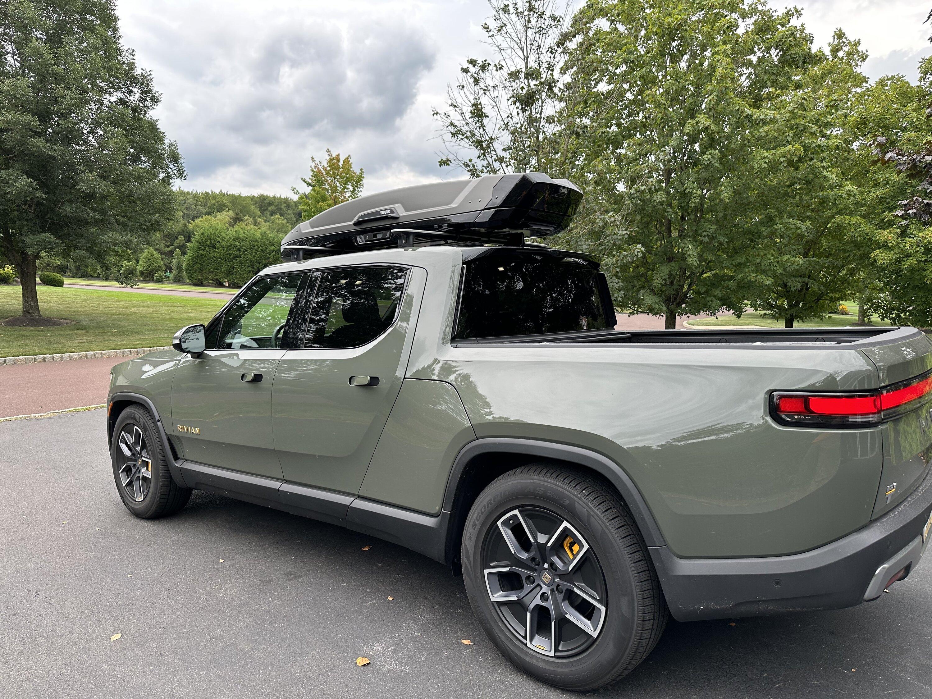

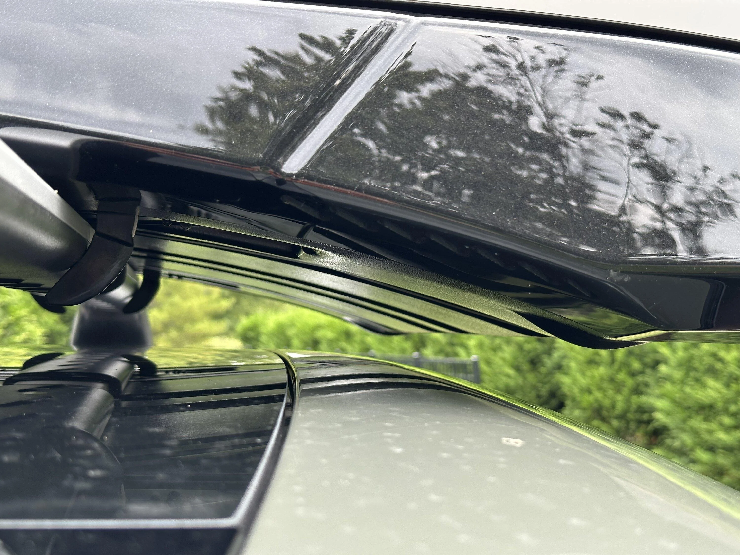

Does the roof box clear the antenna? My Rivian crossbars arrived yesterday, and I tried putting my old Thule Pulse L up there but was concerned that the roof box was resting on the antenna. Thanks!
Yes, it clears the antenna no problem. Will put on again this weekend for a camping trip coming up. If interested, can snap a few photos.

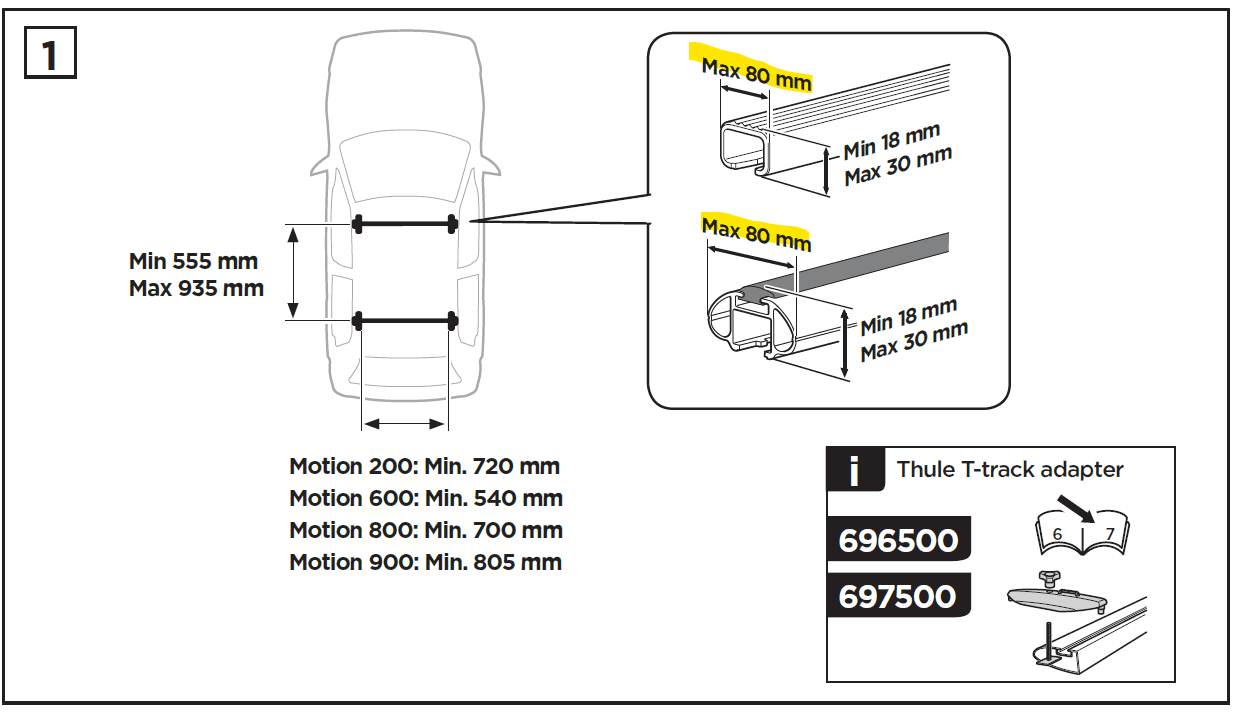

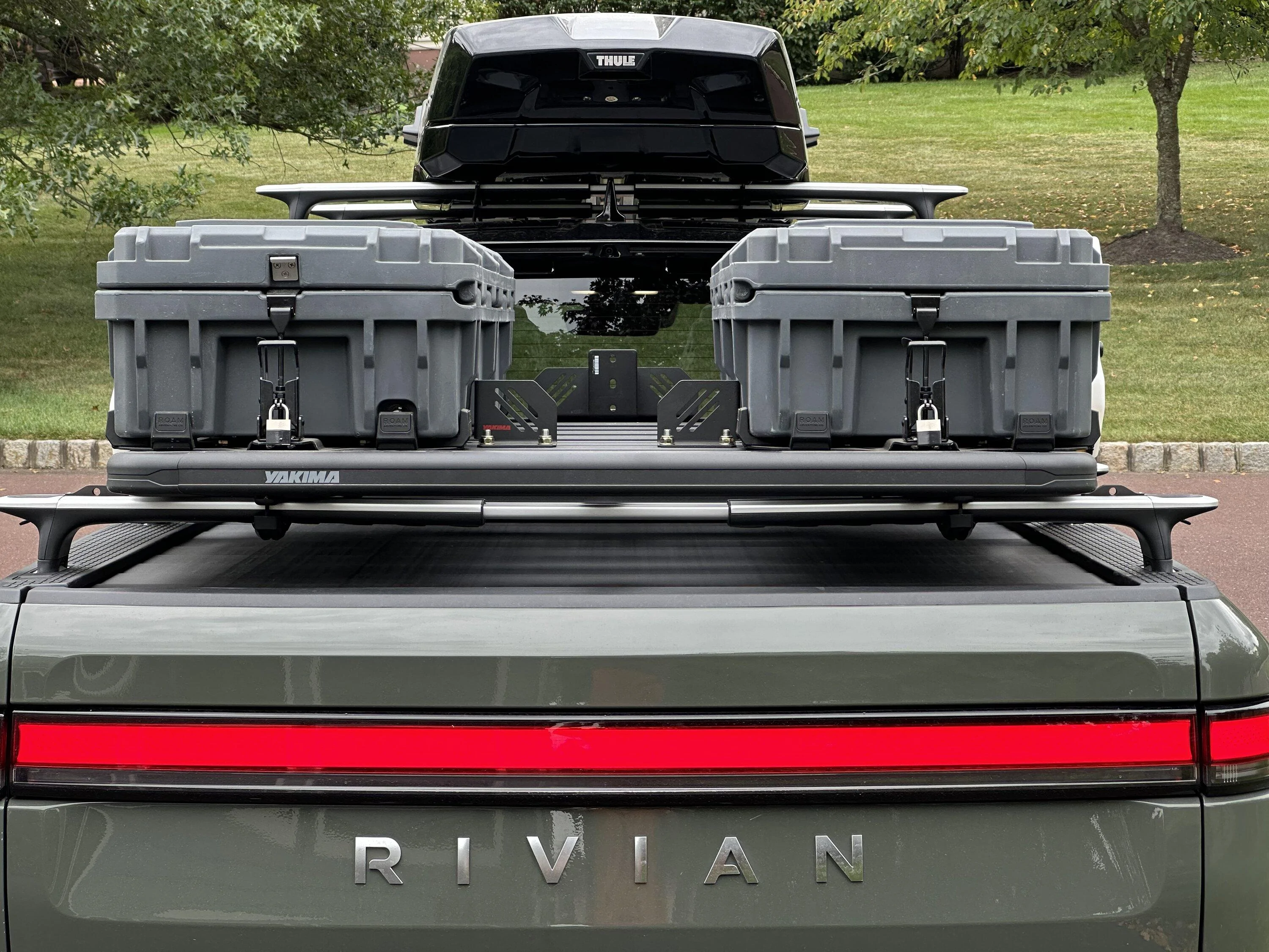

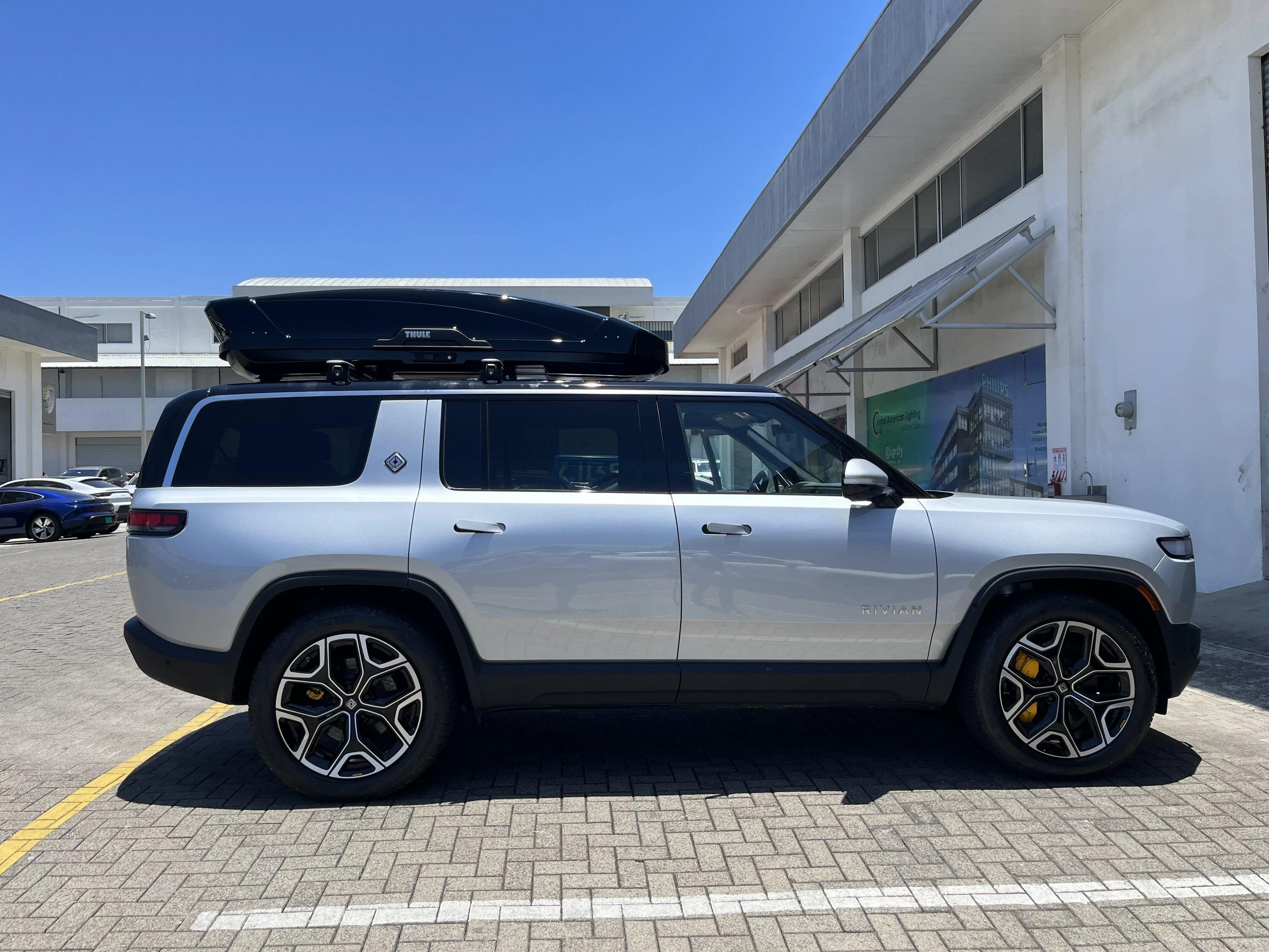

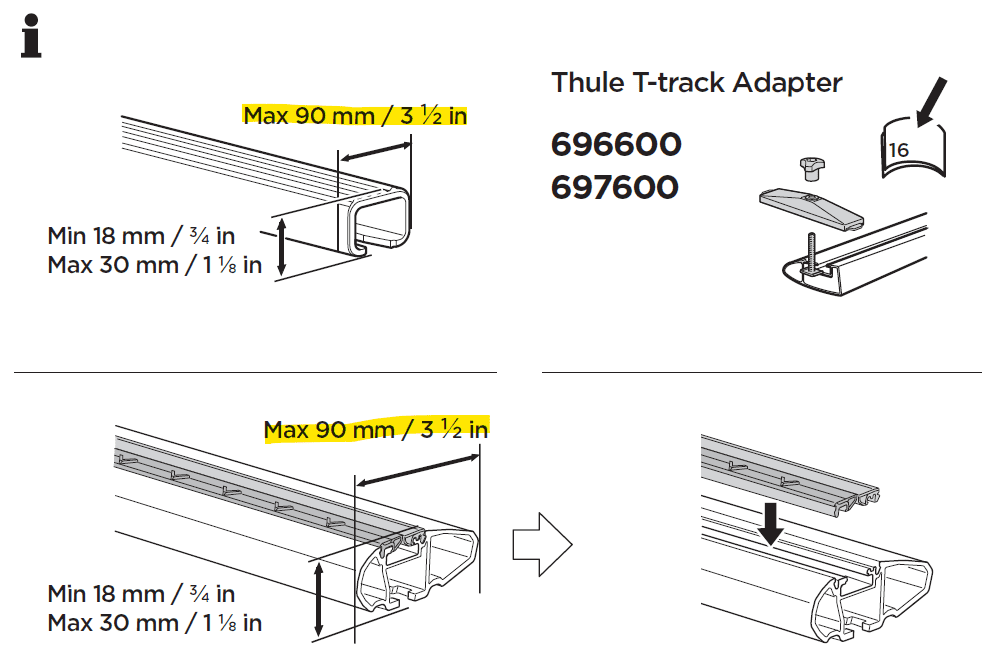

I bought a Thule Motion XT XXL and it fits well with the racks, and just works in the middle and back anchor points (better for aero).
https://www.thule.com/en-us/cargo-carrier/car-top-carrier/thule-motion-xt-xxl-_-629906

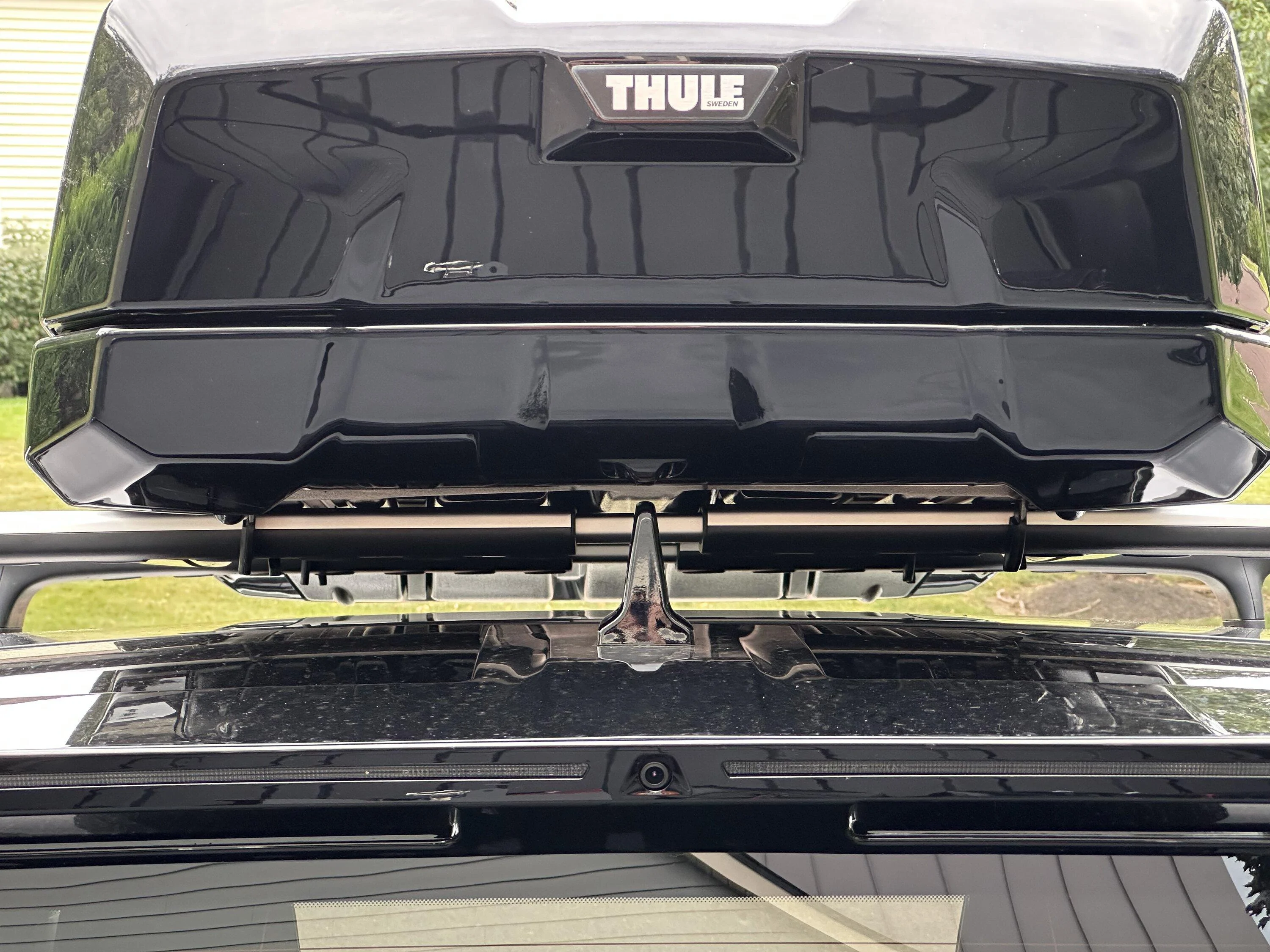

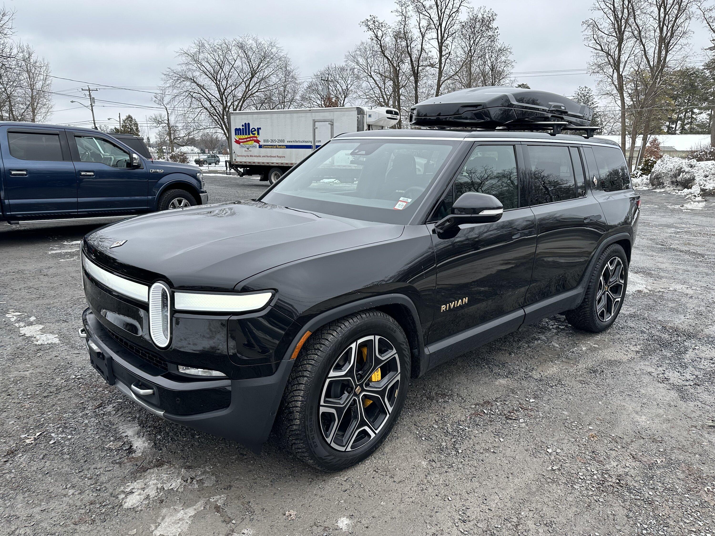

Thanks for suggesting! Just purchased the same Thule xxl box and fits great on our r1-s. Rear liftgate does not hit if installed in full forward position. Rack company agreed that our old Yakima would not work due to width of crossbars and recommend Thule option.
Rivian R1T R1S Roof cargo box recommendations IMG_7076

So i am currently looking for a Cargo box. Read the whole thread and it seems that i have a few options with Yakima and Thule for my R1T roof crossbars.
Im really not looking to spend $2500 for Thule Vector. Is there one that works well under $1000?
Is the Thule Motion 3 XXL $1049 kinda the only option?
Is there any space left on the crossbars for a Thule bike rack with the Motion 3 XXL mounted?
