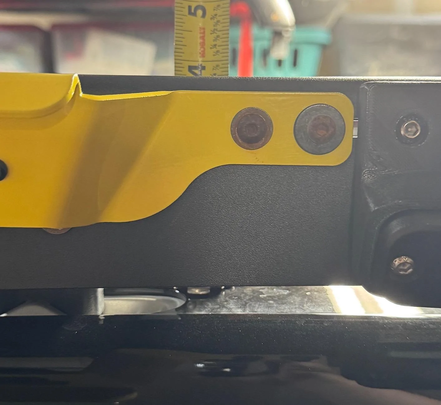

I have a Prinsu Pro rack shipping soon. Anyone know how high it is off the roof compared to the Rivian Cargo Crossbars?
I currently have 3 crossbars and I realize they are actually not level (the front and the rear are both a little bit lower than the middle). If you happen to know how the Prinsu platform relates to all that variation you'd be my hero, but just a general height compared to the middle crossbar would be great.
Front mounting point 3 3/4”
Middle mounting point 3 1/4”
Rear mounting point 3 1/2”
And to give you an idea of how I measured-
Rivian R1T R1S R1S Roof Racks Options - Compilation List IMG_6416
You can kind of see the slope of the roof compared to the printer in this picture -
Rivian R1T R1S R1S Roof Racks Options - Compilation List IMG_6417
joelg
Joel
Sep 14, 2020
San Francisco
R1S Dual Max, BMW i3
For others who are interested:
The OEM crossbars by my measurements are 3 3/4" at the same locations, and also slightly bow upward (at least 1/4" possibly ½") as you get to the center of the roof.
If you lay a bar level across the tops of the different crossbars, the front crossbar is ½" lower than the middle and the back crossbar is 1/4" lower than the middle.
So the Prinsu is first of all dead level (or at least aligned with the camp mode leveling), but also reduces your overall height by ½" at the edge and as much as 1" inch in the center.
For me this is great news, as my goal was to create a super low profile camping rig that I can keep on the roof all the time and still fit in my garage without being too cautious every time I pull in. Not to mention the highway noise and efficiency gains.

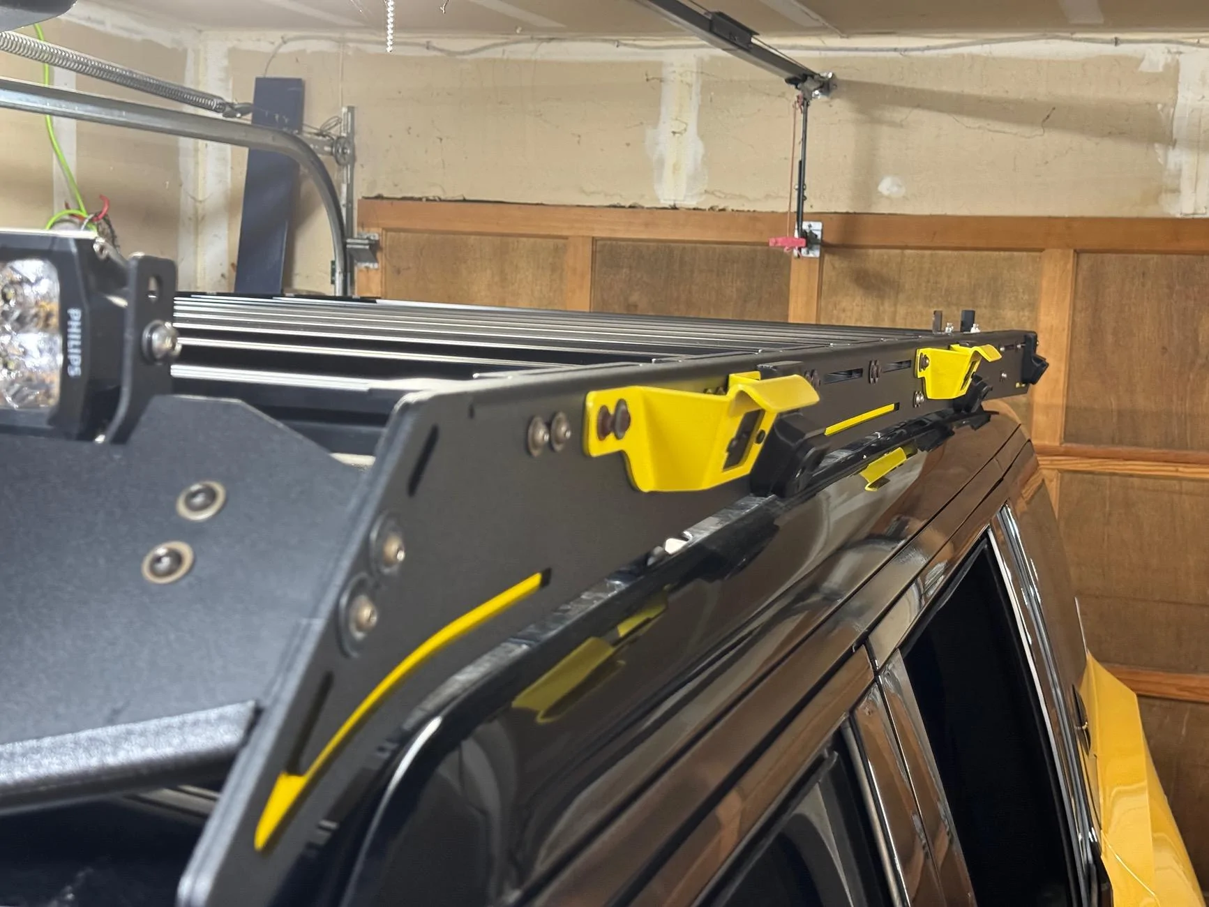

I’ve been extremely happy with my Frontrunner Slimline II. I was initially worried that the wind fairing might crack the glass since it does contact the front edge of it. If had this rack on 100% of the time for 18 months and zero issues.
the way it connects to the mounting points is as solid as it can get, 1000% sturdier that the flimsy mounting claws of the OEM cross bars (which I was happy to return to the Rivian Space).
I’ve had everything from a 170lb RTT to Roam Boxes, the 7’ Kammack awning & a 7 gallon water tank.
I love that I can just go to Home Depot and buy the appropriate length hex bolts to slide into the T-slots.
it does stick out a bit on the rear end since the platform is a uniform width all the way down. For me, however. I needed a rack wide and long enough to fit my full length RTT.
