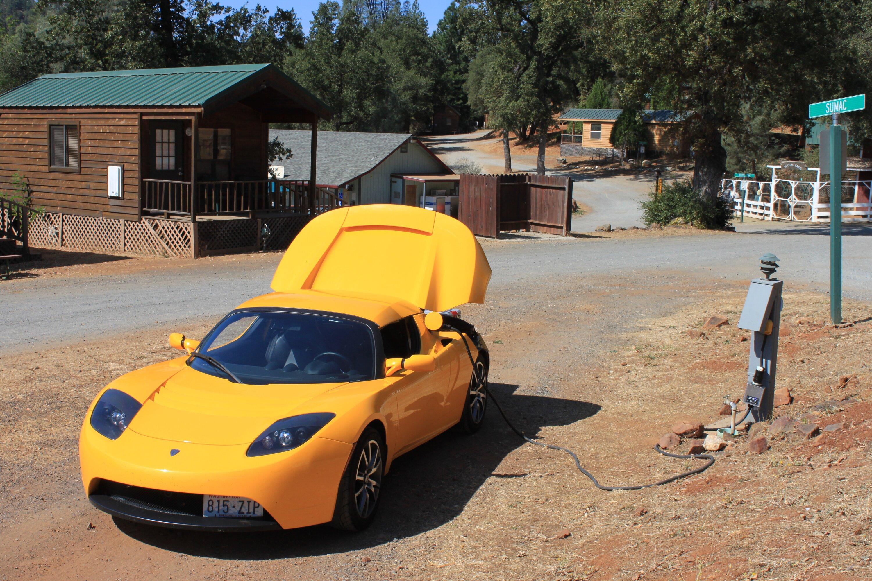

Farther back, I started using RV parks for charging in 2010 when I wanted to take electric road trips but there weren't charging stations (except for a handful of places in California). I encountered the whole gamut of reactions - from "wow, that's cool, go ahead and charge for free" to "sure the campground is empty and you will only be here for two hours, but you have to pay for a full night of the most premium spot even though cheaper spots have the power". Mind you, that was a long time ago - but a lot of people still have no idea what it costs to charge an EV, and most campgrounds still don't have a standard way to charge for it, so I imagine you'll still get a range of reactions. It's good to call or email ahead of time and ask.
Rivian R1T R1S RV Park as a Charging Station Option? Yosemite Pines, Groveland CA
A key thing to keep in mind is the lingo. A number of RV parks were befuddled by my queries about 120V and 240V power, and often gave me the wrong answer. The most common RV outlet types are 120V 30A and 240V 50A. They just call them "30 amp" and "50 amp". So ask for a spot with 50 amp charging.
I've used a lot of campgrounds to charge over the years, and it's generally worked out just great. A couple of times I've had the breaker flip when I was pulling 40A on a 50A circuit at an older campground with poor wiring. Turning the rate down to 32A or 24A worked fine, and still got me the charge I needed overnight. Of course you've got to know the breaker flipped - so best to stay with the car, or check it periodically with an app, or something. Does the Rivian app send you a notification when charging is interrupted? (I don't have my R1T Maxpack yet).
