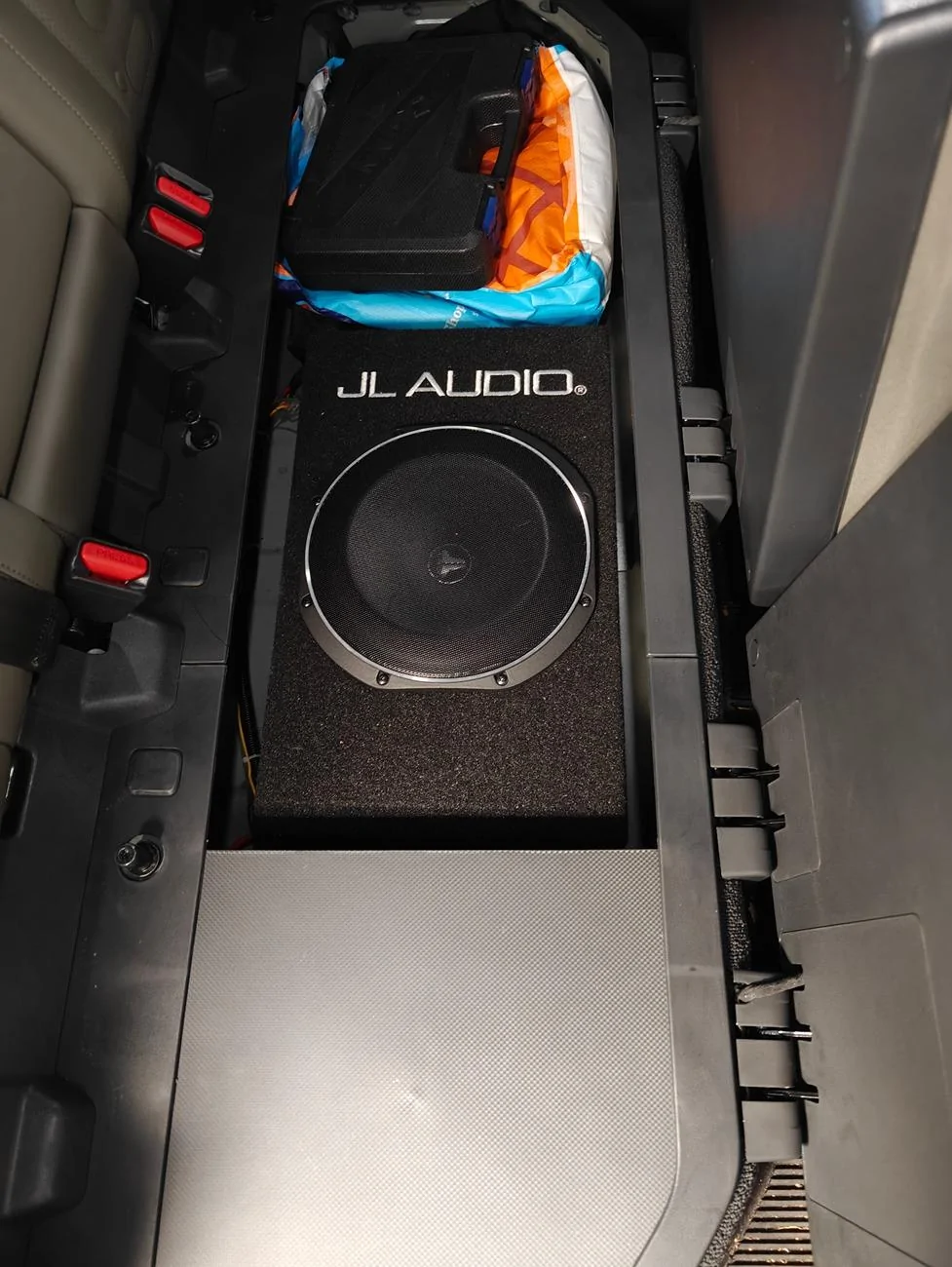

I did. I think it will fit in the space but it will touch the bottom of the seat
You think touch, like put lots of pressure on the speaker grill, or just incidental? From your experience…think it’s necessary to try the 12, or is the 10 more than adequate? Thanks,for your quick response. Jim
It will definitely put pressure on it. The speaker has a grill so it will be fine but I was more worried about vibration. The 10” is more than enough. I usually only turn it up to 50%. It feels 10x more powerful than the stock sub.

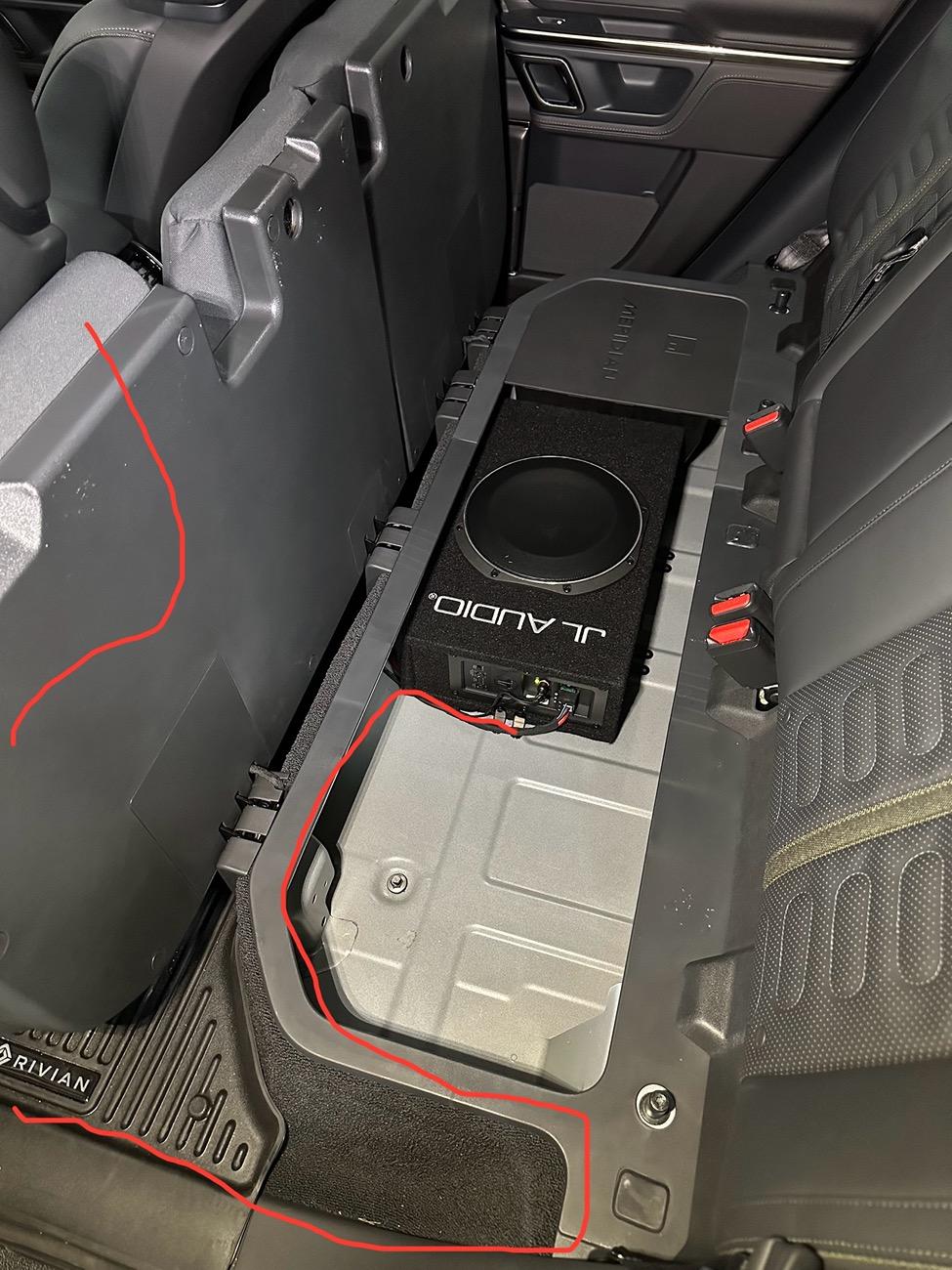

@Revin, can you share how you got your remote knob wire into the center console? I am not seeing any seams or gaps in the bottom to attempt to fish it through.
Revin
Revin
Kevin
May 16, 2023
73
156
Northern Vermont
2022 Rivian R1T / 2015 BMW 335i
I ran the wire like this. Along the door plastics, under the floor mat, up the exterior of the center console (hidden by the seat), under the center console cover, and below the organizer. It’s not perfect but it was easy to run and it’s surprisingly hard to see any wire.

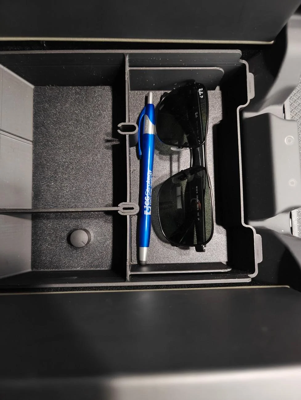

If you open the center console door halfway, you can work the wire under it. Then tuck it to the back, here.
I see what you mean now. The 12 is a full inch “taller” flat on its back, than the 10 is. Glad I asked you.

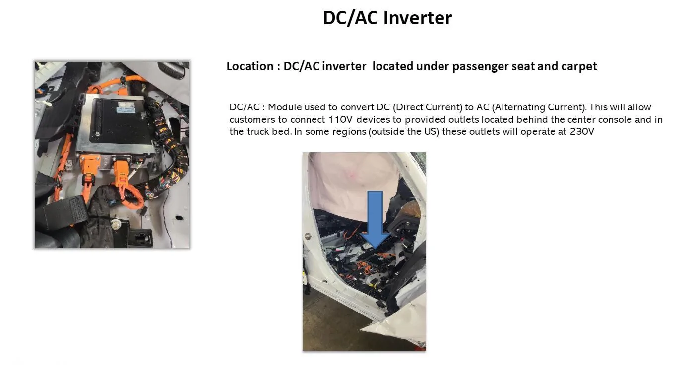

On gen 2?
I haven't personally dug into the inverter on my truck, but there's an old thread around here (pre-gen 2) where someone did, and there was no HV cable going to their inverter. Maybe this is something they addressed for gen 2? On my gen 1 truck, using the 120V absolutely destroys my battery at idle (presumably because of the double conversion).
Trust me on this one!!!

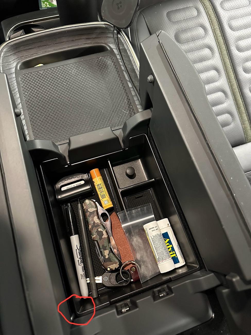

Where did you get that tray in your center console? I've been looking for that. TIA.
