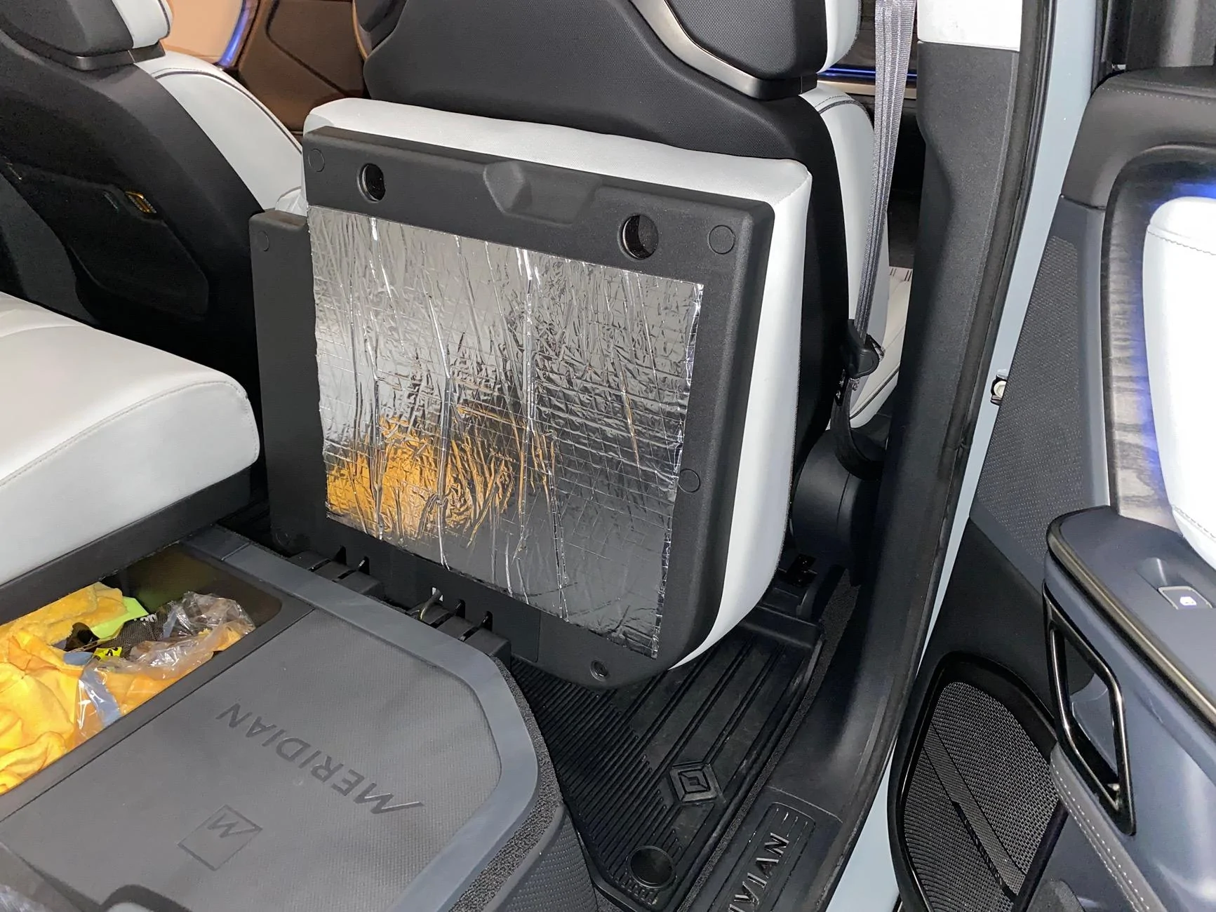

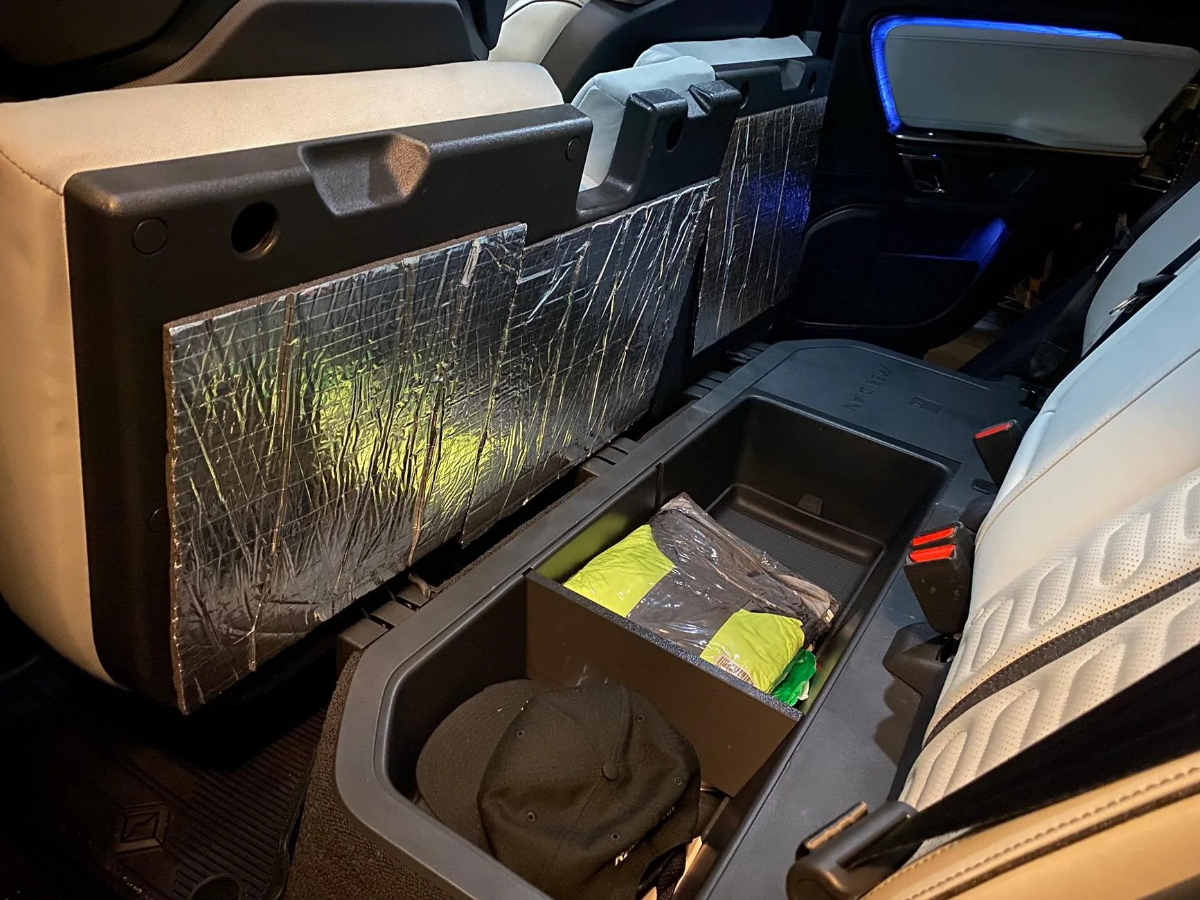

I appreciate all your support throughout the thread, you have helped a lot of people on this forum.
Today, after I removed the tub from under the back seat I discovered that the OEM subwoofer sounds better just from removing the tub, go figure (better air movement).

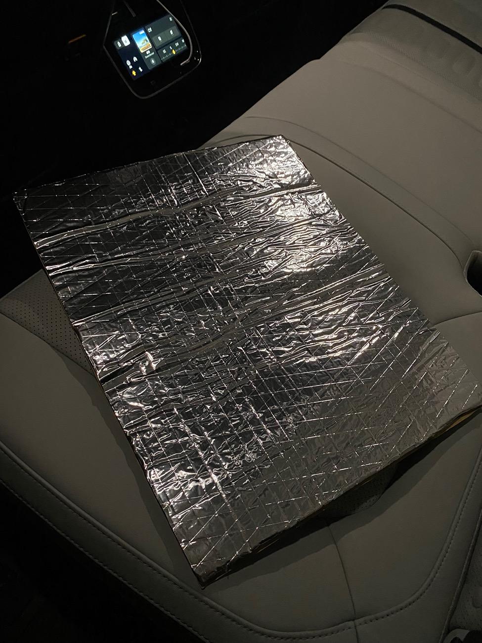

I plan to add a 10" subwoofer similar to your setup. Being new to this do you think adding sound deadening to the metal box would improve things even more? Did you not add sound deadening so you could return everything to stock condition? Seems like it would be tough to remove once applied.
I added sound deadener and it now sounds amazing! Solid bass with no rattles.
